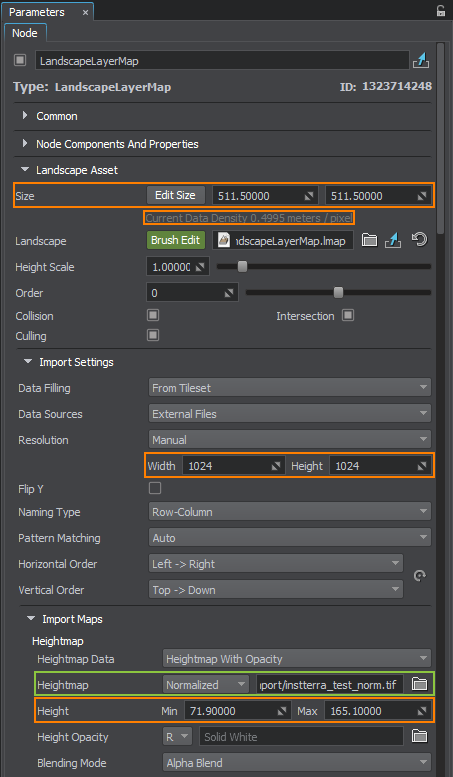

Importing#
    • For the normalized heightmap, indicate the minimum and maximum heights obtained using the Elevation info node.
  • In the Landscape Asset section, set the actual size of your terrain in meters, the same as in Size in meters in Instant Terra.
  • Check the Current Data Density value. It shows the meter-to-pixel ratio, the same as Quad size in Instant Terra.
  • In the Import settings section, check the Resolution values. They define the resolution of the heightmap and correspond to Width and Height in Instant Terra. They are set automatically in most cases, but can also be adjusted, if required.
Click Reimport.
