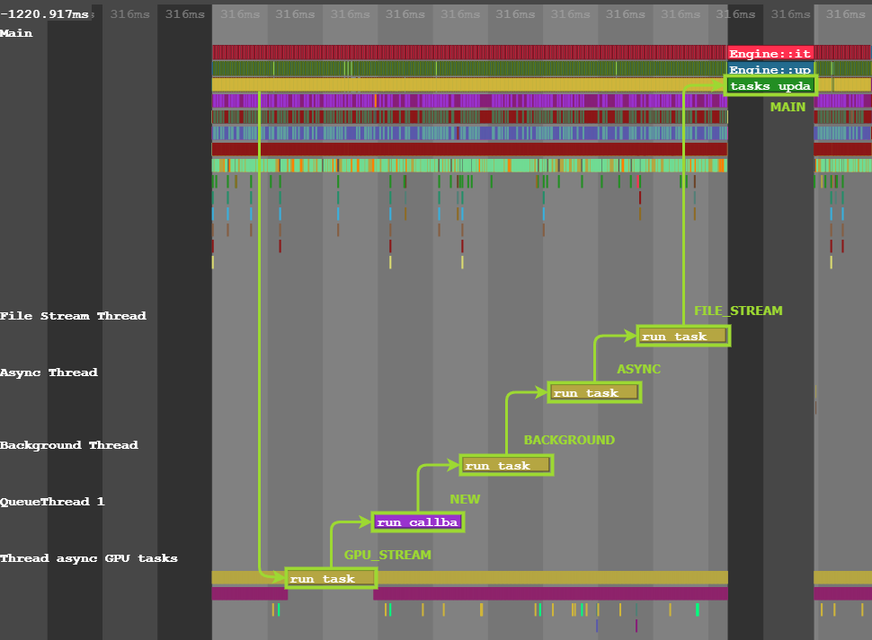

Microprofile tool: Task pipeline using all thread types.
By combining these thread types and priorities, you can design flexible execution chains that distribute workload efficiently across engine subsystems.
