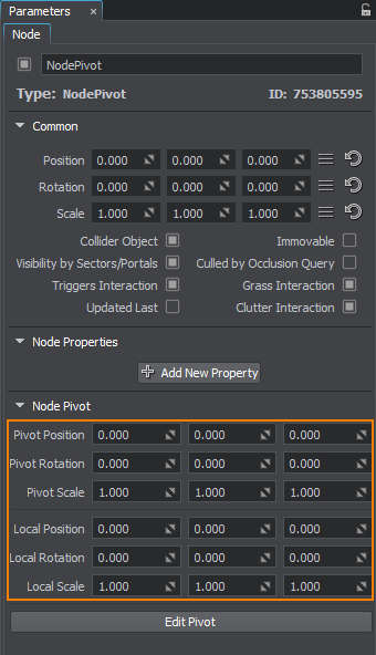

The pivot node has the pivot and local transformation matrices. The pivot transformation matrix sets transformation of the basis of rotation (the pivot point) of child nodes. The local transformation matrix sets local transformation of child nodes relative to the pivot point. Both matrices can be edited in the Parameters window of UnigineEditor: Node Tab -> Node Pivot section.

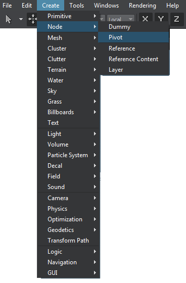

To add a new pivot node via UnigineEditor do the following:
  1. Run UnigineEditor.
  2. On the Menu bar, click Create -> Node -> Pivot.

    By default, the pivot and local transformation matrices of the added node are equal to identity matrices. You can change them in the Node tab of the Parameters window.

Editing the pivot node implies changing its pivot and local transformation matrices in the Node tab of the Parameters window.
Pivot node settings

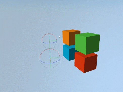

You should distinguish between the concepts of the pivot node and the pivot point: changing transformation of the pivot point doesn't affect the pivot node and vice versa. By default, their transformations coincide.

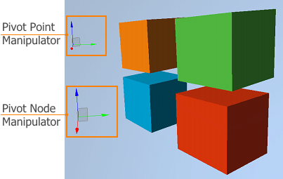

Transformation of the pivot node is edited in the Common section of the Node tab in the Parameters window. To edit the pivot point transformation, you should select the pivot node and edit data in the Node Pivot section. As a result, 2 manipulators appear: the smaller manipulator for the pivot point and the bigger one for the pivot node. To change the pivot point transformation, press Edit Pivot and change the required pivot values in the Node Pivot section or transform the manipulator.
Changing position of the pivot point manipulator
Pivot node and pivot point with different transformations

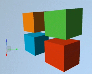

Changing the local transformation of child nodes doesn't require pressing Edit Pivot: you can simply change the required local values in the Node Pivot section. You can also move, rotate or scale the pivot point manipulator by using the required transformation mode. For example:
Child nodes rotating relative to pivot point
If the Edit Pivot button is pressed, changing the pivot point manipulator will change the pivot point transformation. Otherwise, the local transformation of child nodes will be performed.
