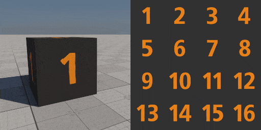

Flipbook Animation
This material graph implements a flipbook for atlas-based texture animation, using the Floor node as a key component to control frame stepping over time.
Step function formula
The animation is driven by the Time node, which is multiplied by a custom FPS value to control the animation speed. The Floor node is then used to ensure that only whole-number frame indices are used — this prevents interpolation and ensures the texture only changes at discrete intervals, creating a clean frame-by-frame animation effect.
That frame index is then wrapped using Mod node (for looping) and separated into column and row indices based on the texture atlas layout. These indices are then converted into UV offsets and combined with tiling data using the Tiling And Offset node, which then passed into the Sample Texture node as a new UV.
