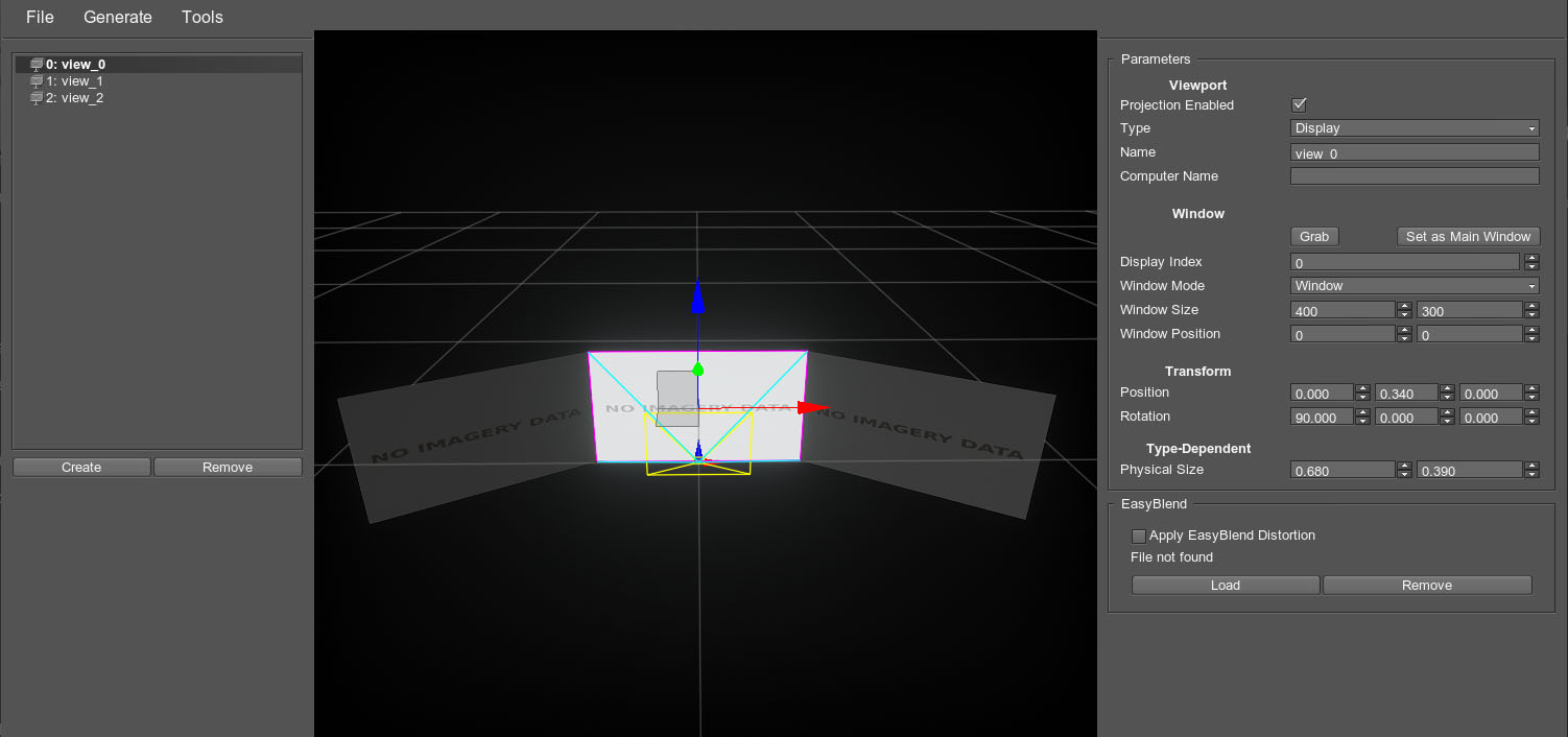

    Otherwise, start creating a new configuration file: add a viewport (click Create on the left panel and select the viewport that has been added to the viewport area) and configure it by setting its type depending on how the image will be rendered — on the display or by a projector. Configure all other settings.

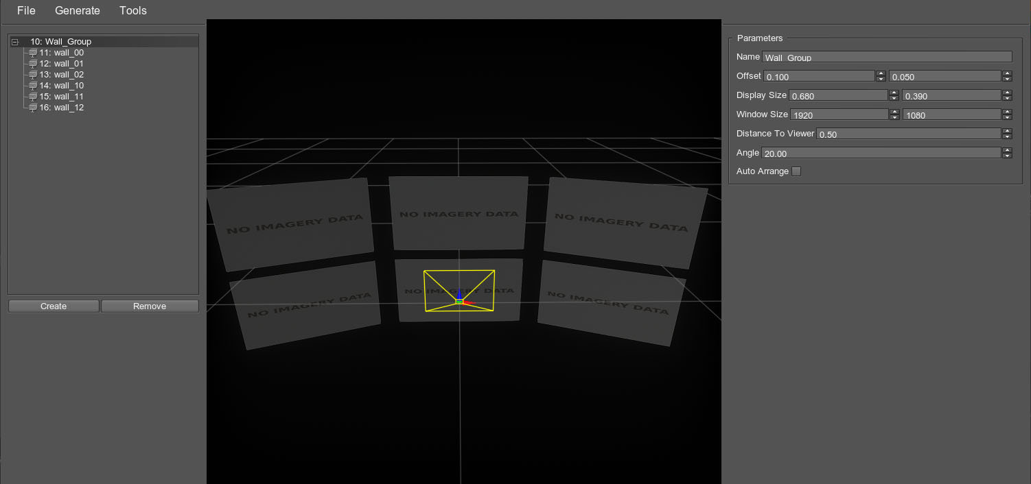

    You can also quickly generate a wall of viewports (Generate -> Wall) and configure the viewport settings for them in a group or individually:
    To initiate rendering of the configured viewports or apply any changes, save and load the configuration file.
  5. Fine-tune the rendered image using the projection setup window (Tools -> Projection Setup):
    Projection Setup window
    Settings in this window allow you to:
    • Mirror, flip, or otherwise rotate projections. You can also move and rotate the projected image in the viewport setup window to achieve the requried result: for example, if the image is behind the view point it is mirrored horizontally and vertically.
    • Control warping for each projection.
    • Apply edge blending for each projection to fix overlit areas created by overlapping projections.
    • Adjust color intensity for each projection.
    Check this article on configuring projection for more details.
