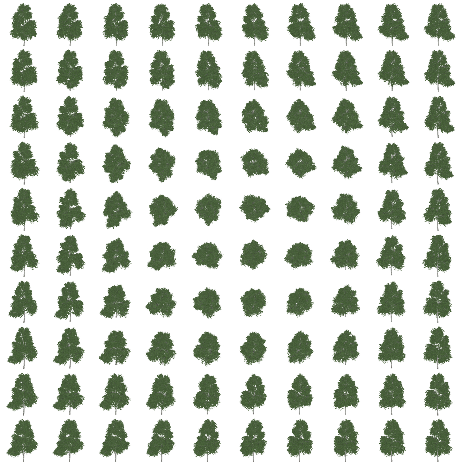

Atlas Size
The size of the created atlas texture that stores all captured images. Atlas is always a square texture.用于存储所有捕获图像的图集纹理的大小。图集始终为方形纹理。
Altas size 10x10
