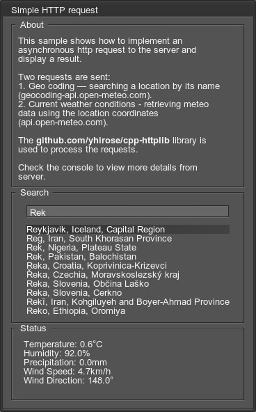

Simple HTTP Request#
This sample demonstrates how to implement asynchronous HTTP GET requests to external REST API and display the retrieved data in the user interface.
For demonstration, the sample performs two consecutive requests to external weather API and displays the results in real time.
  1. Geocoding - resolving a location by name using geocoding-api.open-meteo.com.
  2. Current weather conditions - retrieving live meteorological data for the selected location using api.open-meteo.com.
The github.com/yhirose/cpp-httplib library is used to perform HTTP requests asynchronously. Check the console to view more details from server.
The JSON response is processed using the Json Class and displayed in the sample UI. Additional response details can be viewed in the console output.
You can interactively test the workflow by entering a city name in the UI, viewing a list of possible matches, and selecting a specific location. This triggers a request for up-to-date weather data, which is then parsed and displayed in the UI.
Asynchronous processing ensures that network operations do not block or degrade the simulation performance.
This sample can serve as a foundation for integrating any external data providers.
SDK Path: <SDK_INSTALLATION>source/network/http_simple_request
