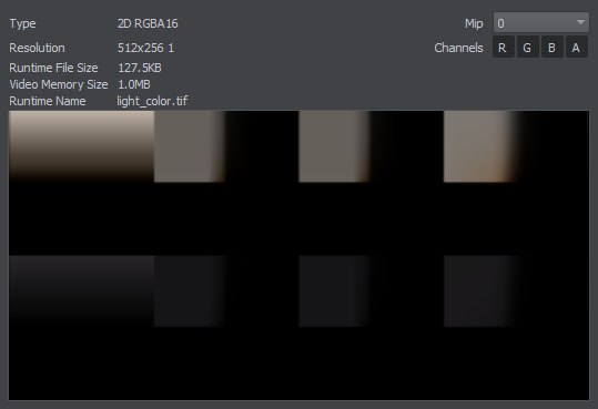

Light Color#
A 2D texture defining the color of LightWorld depending on the time of day.
Light Color LUT Texture
The texture is split vertically (top for the Sun and bottom for the Moon scattering mode) and consists of 4 columns, each for a specific reason:
  1. Color to be used for objects in the world. The values in this column should differ only vertically, horizontally the value should be the same.
  2. Color to be used for clouds on the side opposite to the light source (to provide a possibility of rendering a shadow cast by a planet, if required)
  3. Color to be used for clouds
  4. Color to be used for clouds around the light source
Sampling of the color for objects based on the sun angle (the black texture is used for the Base and Mie LUTs for clarity):
