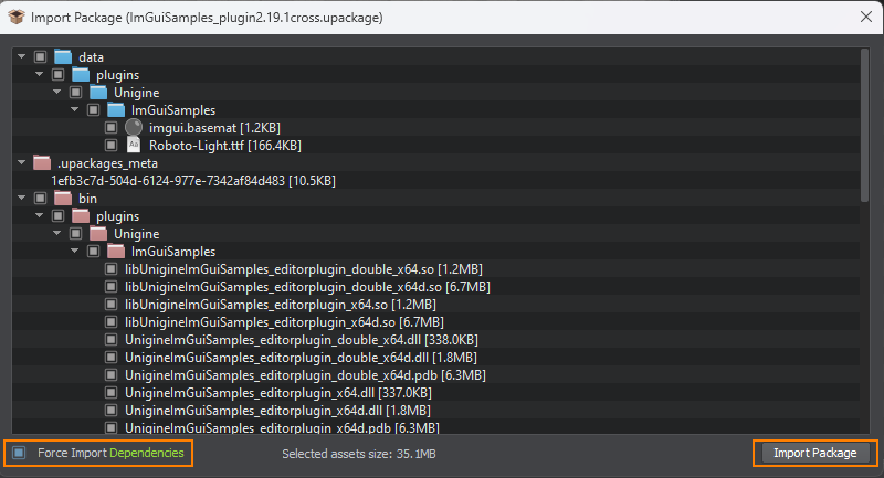

  4. Download the ImGuiSamples Plugin add-on from Add-On Store at https://store.unigine.com/ and add it to the project by dragging the *.upackage into the project data/ folder in the Asset Browser. In the Import Package window that opens, click Force Import Dependencies in the bottom-left corner, then the Import Package button, and wait until the add-on contents are imported.

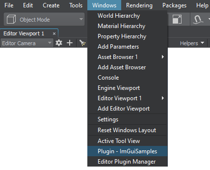

  5. Restart the Editor. After that, you can run the plugin via: Windows -> Plugin-ImGuiSamples in the Editor's menu.

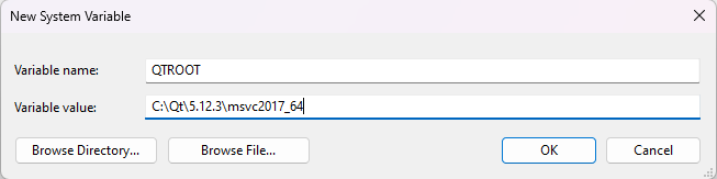

      Qt will be located using the QTROOT environment variable. You can set it, for example, as follows: click Start, type Environment Variables, and open Edit the system environment variables. In the System Environment Variables dialog, click New (or Edit, if it already exists) and set:
      • Variable name: QTROOT
      • Value: full path to your Qt installation (e.g., C:\Qt\5.12.3\msvc2017_64)
      • Restart your IDE or system to apply the changes.
