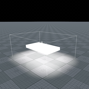

Rectangle shape矩形形状
By using this parameter, you can create an area light that illuminates objects in different directions at once. Besides, a light source of each shape provides a physically correct speck on illuminated surfaces.通过使用此参数,您可以创建一个区域光,该光可以一次照亮不同方向上的对象。此外,每种形状的光源都会在照明表面上提供物理上正确的斑点。
A light source of the rectangular shape produces the light and the speck in a form of a rounded rectangle.矩形的光源以圆角矩形的形式产生光和斑点。

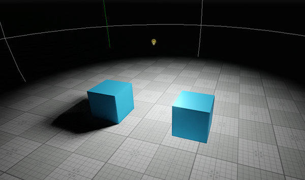

Toggles rendering of shadows from the light source on and off.切换光源的阴影渲染。
Shadows from Light Omni enabled (the left cube) and disabled (the right cube)来自Light Omni的阴影已启用(左侧多维数据集)和已禁用(右侧多维数据集)

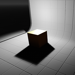

Bias
Shadow bias that is used to correct inexact shadowing of the scene objects. It controls the depth offset added to the current depth value stored in the shadow map. Such offset is adaptively calculated taking into account the slope angle of the light source, its resolution, and the distance to the light source at shadow map application.阴影偏差,用于校正场景对象的不精确阴影。它控制添加到阴影贴图中存储的当前深度值的深度偏移。考虑到光源的倾斜角度,其分辨率以及在阴影贴图应用中到光源的距离,可以自适应地计算这种偏移。
  • If the shadow acne appears, the bias value should be increased. This procedure eliminates the self-shadowing effect, as the points will appear closer to light source when compared to the map depth value.如果出现暗疮痤疮,则应增加偏压值。此过程消除了自阴影效应,因为与地图深度值相比,这些点将看起来更靠近光源。
  • If the bias value is set too high, the shadow will look detached from the object casting it (see the 3rd picture below).如果偏置值设置得太高,阴影将看起来与投射阴影的对象分离(请参见下面的第三张图片)。
Bias = 0; Normal bias = 1
Bias = 4; Normal bias = 1
Bias = 30; Normal bias = 1

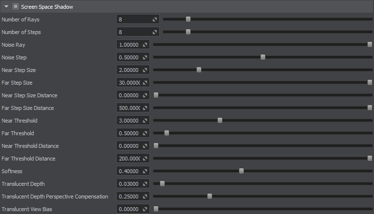

Screen Space Shadow Settings
屏幕空间阴影设置#
Enable the Screen Space Shadows feature in the Shadows Settings.Shadows Settings中启用Screen Space Shadows功能。

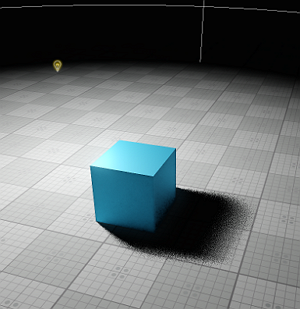

Enabled
Enables or disables screen space shadows from the light source.启用或禁用光源的屏幕空间阴影。

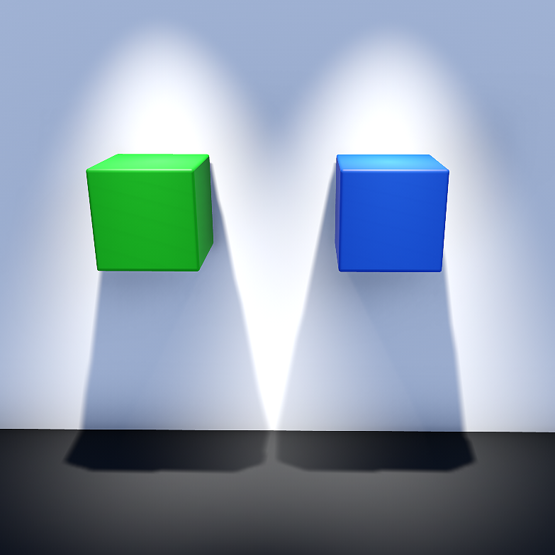

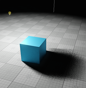

Screen Space Shadows from Light Omni on (the left cube) and off (the right cube). Shadows are disabled.屏幕空间阴影从Light Omni启用(左侧多维数据集)和禁用(右侧多维数据集)。阴影被禁用。
Number of Rays
Number of rays used in screen space ray tracing. The higher the number of rays, the more accurate the computation of pixel shading is.屏幕空间光线跟踪中使用的光线数。光线数量越多,像素阴影的计算越准确。
Number of Rays = 1
Number of Rays = 15
Number of Steps
Number of steps each ray traces. The higher the number of steps, the more accurate the computation of pixel shading is.每个射线跟踪的步数。步骤数越多,像素阴影的计算越准确。
Number of Steps = 4; Number of Rays = 1
Number of Steps = 32; Number of Rays = 1

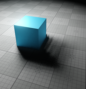

Noise Ray
Ray tracing dispersion. The higher the noise, the more chaotic the direction of rays is.光线追踪色散。噪声越高,光线的方向越混乱。
Noise Ray = 0.5
Noise Ray = 0
Noise Step
Dispersion of steps. The higher the noise, the more scattering the steps are.分散步骤。噪声越高,台阶越分散。
Noise Step = 0.5; Noise Ray = 0.5
Noise Step = 0; Noise Ray = 0.5
Depending on the value of the Noise Ray parameter, the shadow may differ for the same values of Noise Step.根据值噪音射线参数,对于相同的Noise Step值,阴影可能会有所不同。
Near Step Size
Length of each step used in ray-traced shadows within Near Step Size Distance.Near Step Size Distance范围内的光线跟踪阴影中使用的每个步骤的长度。
  • Low values cause the closest pixels to shade.较低的值会导致最接近的像素被遮挡。
  • Higher values lengthen the shadow spreading.较高的值会延长阴影扩散。
  • Too high values can provoke shadow gaps.太高的值会引起阴影间隙。
Step Size = 0.5
Step Size = 20
Far Step Size Length of each step used in ray-traced shadows (see the description above) starting from Far Step Size Distance.光线跟踪阴影中使用的每个步骤的长度(请参见描述以上)从Far Step Size Distance开始。
Near Step Size Distance Distance from the camera, in units. Up to this distance, Near Step Size is used for screen-space shadows.距相机的距离(以单位为单位)。在此距离之前,Near Step Size用于屏幕空间阴影。
Far Step Size Distance Distance from the camera, in units. After this distance, Far Step Size is used for screen-space shadows. For the space between Near Step Size Distance and Far Step Size Distance, the step size interpolates from Near Step Size to Far Step Size.距相机的距离(以单位为单位)。在此距离之后,将Far Step Size用于屏幕空间阴影。对于Near Step Size DistanceFar Step Size Distance之间的空间,步长从Near Step Size插值到Far Step Size
Near Threshold
Threshold value for Near Step Size. This value defines the limit of samples passing the screen-space shadowing.Near Step Size的阈值。此值定义通过屏幕空间阴影的样本的限制。
  • Low values let pass more samples which causes the shading of inappropriate pixels.较低的值会使更多的样本通过,从而造成不适当像素的阴影。
  • Higher values can also cause inaccurate shading by limiting appropriate samples.较高的值也会通过限制适当的样本来导致不正确的阴影。
Threshold = 0
Threshold = 1
Threshold = 4
Far Threshold Threshold value (see the description above) for Far Step Size.阈值(请参阅描述以上)的Far Step Size
Near Threshold Distance Distance from the camera, in units. Up to this distance, Near Threshold is used. 距相机的距离(以单位为单位)。直到此距离,使用Near Threshold
Far Threshold Distance Distance from the camera, in units. After this distance, Far Threshold is used for screen-space shadows. For the space between Near Threshold Distance and Far Threshold Distance, the threshold value interpolates from Near Threshold to Far Threshold.距相机的距离(以单位为单位)。在此距离之后,将Far Threshold用于屏幕空间阴影。对于Near Threshold DistanceFar Threshold Distance之间的空间,阈值从Near Threshold插值到Far Threshold
Softness
Size of the blur applied to the shadow edge.应用于阴影边缘的模糊大小。
  • Low softness values corresponds to the crisp and sharp shadow edges.低的柔度值对应于清晰的阴影边缘。
  • Higher softness values serve to accentuate the effect of soft indirect lighting.较高的柔度值可增强柔和间接照明的效果。
Softness = 0
Softness = 0.5
Noise Translucent
Makes translucent shadows smoother by adding noise. The higher the value the more intense and noticeable the noise is.通过添加噪点使半透明阴影更平滑。值越高,噪声越强烈和明显。
This option affects performance, so use it only in case it noticeably improves the result.此选项会影响性能,因此仅在明显改善结果的情况下使用它。
Translucent Depth This parameter indicates how much the light passes through screen-space shadows on translucent materials (with Translucence option enabled): the higher the value the deeper the light penetrates translucent objects shifting the shadow.此参数表示有多少光线通过半透明材质上的屏幕空间阴影(启用 Translucence 选项):越高值越更深 光线穿透半透明物体,移动阴影。
Translucent Depth Perspective Compensation Perspective compensation for the Translucent Depth value above:
  • 0 - the Translucent Depth value does not depend on the distance from the camera to the surface.
  • 1 - the Translucent Depth value linearly depends on the distance from the camera to the surface.
This effect is used to make tree crowns located far from the camera more translucent than the grass nearby.
上面 Translucent Depth 值的透视补偿:
  • 0 - Translucent Depth 值不取决于相机到表面的距离。
  • 1 - Translucent Depth 值线性地取决于相机到表面的距离 表面。
此效果用于使远离相机的树冠比附近的草更透明。
Translucent View Bias This parameter can be used to create an effect of fuzziness for vegetation (e.g. to simulate leaves of saintpaulia or provide a sponge-like look for tree crowns).
  • By the value of 0 the effect is disabled
  • the value of 1 corresponds to the maximum effect.
此参数可用于为植被创建模糊效果(例如,模拟圣保利叶的叶子或为树冠提供海绵状外观)。
  • 通过 0 的值 效果被禁用
  • 1的值对应最大效果。

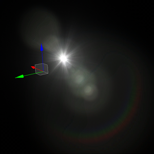

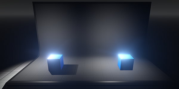

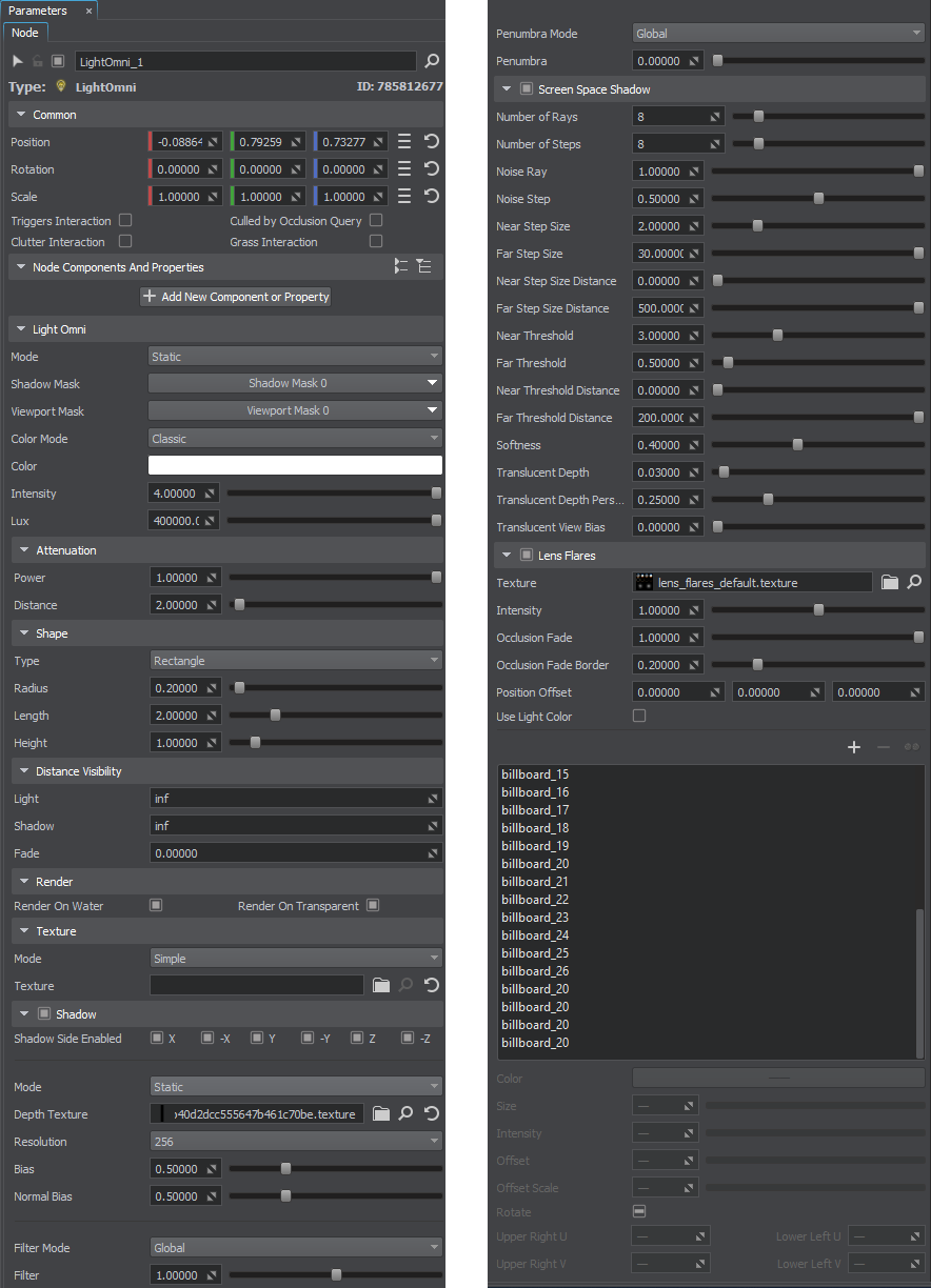

镜头光晕设置#

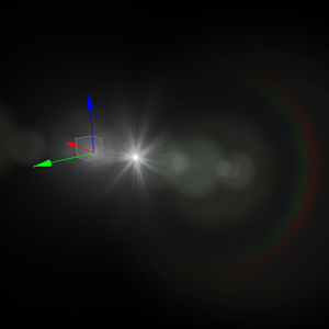

Lens Flares simulate the effect of lights refracting inside camera lens. They are used to represent very bright lights or to add more atmosphere to your scene. The settings described below are used per-light, you can also use the lens flares camera effect, which is applied to all lights and bright objects (e.g. having an emissive material with high intensity assigned).Lens Flares模拟光线在相机镜头内部折射的效果。它们用于代表非常明亮的灯光或为场景增加气氛。如下所述的设置用于每灯,您也可以使用镜头光晕相机效果,适用于所有灯光和明亮的物体(例如,具有发光材质分配高强度)。
Lens Flares are rendered as billboards, each associated with a part of a single texture and having a set of parameters, that determine its appearance and behavior. So, you can customize and fine tune your lens flares to fit your needs.镜头光晕呈现为广告牌,每个都与一个单一纹理并有一套参数,它决定了它的外观和行为。因此,您可以自定义和微调您的镜头光晕以适应您的需求。
This feature is available only for: Light Omni, Light Projected and Light World.此功能仅适用于:Light Omni, Light ProjectedLight World

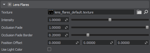

Enabled
Enables or disables lens flares from the light source. By default this effect is disabled.启用或禁用来自光源的镜头光晕。默认情况下,此效果是禁用的。
The maximum number of lights on the scene for which the per-light flares will be rendered is 32.每个光耀斑将被渲染的场景中的最大灯光数量为32
Texture
A texture used to render billboards representing lens flares. The default texture is shown in the image below. For each billboard you can specify UV coordinates within this texture to determine its appearance. You can set your own texture, that contains the appearance for all the billboards to be used.用于渲染的纹理广告牌代表镜头光晕。下图显示了默认纹理。您可以为每个广告牌指定UV坐标在此纹理中确定其外观。您可以设置自己的纹理,其中包含要使用的所有广告牌的外观。
Intensity
Intensity of per-light lens flares. Higher values make the effect more pronounced.每个光源镜头光晕的强度。数值越高,效果越明显。
Occlusion Fade
Lens flare occlusion fade value for the cases when the light source becomes occluded by an object. By the value of 0.0f, lens flares disappear abruptly, as the light source becomes occluded by an object. If 1.0f is set, lens flares will fade out gradually.当光源被物体遮挡时,镜头眩光遮挡褪色值。通过0.0f的值,当光源被物体遮挡时,镜头光晕会突然消失。如果设置了1.0f,则镜头光晕将逐渐消失。
Transparent objects are currently treated as opaque ones (i.e. they won't occlude flares).透明对象当前被视为不透明对象(即它们不会遮盖耀斑)。
Occlusion Fade Border Lens flare occlusion fade value for the cases when the light source becomes occluded by the edges of the screen. By the value of 0.0f, lens flares disappear abruptly, as the light source becomes occluded by the edges of the screen. If 1.0f is set, lens flares will fade out gradually.当光源被屏幕边缘遮挡时,镜头眩光遮挡褪色值。值0.0f会使镜头光晕突然消失,因为光源被屏幕边缘遮住了。如果设置了1.0f,则镜头光晕将逐渐消失。

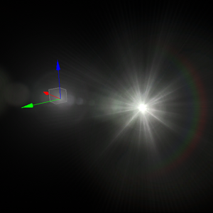

Position Offset
An offset of the center of lens flares from the world position of the light source.镜头光斑中心与光源的世界位置的偏移。
This parameter is not available for Light World此参数不适用于Light World
Position Offset = (0.0, 0.0, 0.0)
Position Offset = (2.0, -3.0, 0.0)
Use Light Color When enabled, the lens flares will have the same color as the light source.启用后,镜头光晕将具有与光源相同的颜色。

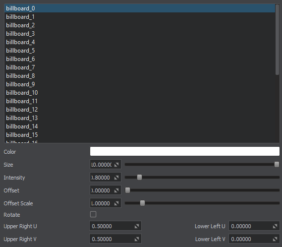

Lens Flares Billboards Settings
镜头光晕广告牌设置#
Each flare is represented by a separate billboard, The default number of billboards is 30, but you can change it if necessary by adding, removing, or cloning selected billboards in the list via the corresponding buttons.每个耀斑由一个单独的广告牌表示。广告牌的默认数量为30,但您可以根据需要通过使用相应按钮在列表中添加,删除或克隆选定的广告牌来进行更改。
As you select a billboard in the list, its parameters become available for editing in the fields below.在列表中选择广告牌时,其参数可在以下字段中进行编辑。
You can enable visualization of lens flare billboards via Helpers -> Show Wireframe.您可以通过Helpers -> Show Wireframe启用镜头光晕广告牌的可视化。

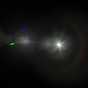

Color
Color multiplier for the selected billboard. Texture colors will be multiplied by this value. By default the color is white.所选广告牌的颜色倍增器。质地颜色将乘以该值。默认情况下,颜色为白色。
Size
This parameter controls the size of the selected billboard.此参数控制所选广告牌的大小。
Size = 1.5
Size = 5

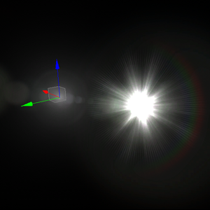

Intensity
Multiplier for the billboard color used to control color intensity. The higher the value, the brighter the billboard is.广告牌颜色的乘数,用于控制颜色强度。值越高,广告牌越亮。
Intensity = 1
Intensity = 5
Offset
Offset determines the distance between the light source and the billboard along the vector oriented from the light source to the screen center. The lower the absolute value is, the closer to the light source the billboard will be. Negative values indicate that the distance is measured in the opposite direction.偏移量确定了光源和广告牌之间沿从光源到屏幕中心的方向的矢量之间的距离。绝对值越低,广告牌将越靠近光源。负值表示沿相反方向测量距离。
Offset = 0.3偏移= 0.3
Offset = 0.9偏移= 0.9
Offset Scale
Determines how the billboard changes its scale depending on the distance from the light source. As the offset from the light source increases:确定广告牌如何根据距光源的距离更改其比例。作为抵消从光源增加:
  • Values less than 1.0f will make the billboard shrink.小于1.0f的值会使广告牌缩小。
  • Values greater than 1.0f will make the billboard grow.大于1.0f的值将使广告牌增长。
Offset Scale= 1.0偏移比例= 1.0
Offset Scale = 4.0偏移比例= 4.0
Lower Left X X coordinate of the lower left corner of the selected billboard in the lens flares texture, in the range [0.0, 1.0], e.g., the value equal to 0.5 corresponds to the middle of the texture.所选广告牌左下角的X坐标镜头光晕纹理在[0.0, 1.0]范围内,例如,等于0.5的值对应于纹理的中间。
Lower Left Y Y coordinate of the lower left corner of the selected billboard in the lens flares texture, in the range [0.0, 1.0], e.g., the value equal to 0.5 corresponds to the middle of the texture.所选广告牌左下角的Y坐标镜头光晕纹理在[0.0, 1.0]范围内,例如,等于0.5的值对应于纹理的中间。
Upper Right X X coordinate of the upper right corner of the selected billboard in the lens flares texture, in the range [0.0, 1.0], e.g., the value equal to 0.5 corresponds to the middle of the texture.所选广告牌右上角的X坐标镜头光晕纹理在[0.0, 1.0]范围内,例如,等于0.5的值对应于纹理的中间。
Upper Right Y Y coordinate of the upper right corner of the selected billboard in the lens flares texture, in the range [0.0, 1.0], e.g., the value equal to 0.5 corresponds to the middle of the texture.所选广告牌右上角的Y坐标镜头光晕纹理在[0.0, 1.0]范围内,例如,等于0.5的值对应于纹理的中间。
Rotate Enables or disables rotation of the lens flare billboard. When enabled the top of the billboard will always face the center of the screen.启用或禁用镜头光晕广告牌的旋转。启用后,广告牌的顶部将始终面向屏幕中心。
