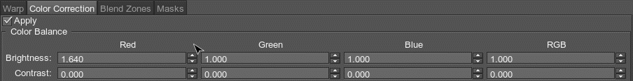

The Color Correction tab allows you to correct color intensity, as well as to adjust color balance for the selected projection.Color Correction选项卡允许您校准颜色强度,以及调整所选投影的颜色平衡。
All Color Balance parameters can be reset to defaults by clicking the corresponding parameter name (by line or by column).通过单击相应的参数名称(按行或按列为Color Balance参数集,并分别为每个角),可以将所有颜色参数重置为默认值。
