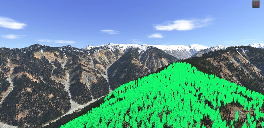

  • Mesh Clutter is an object used to scatter a large number of identical meshes across the world. It is suitable for simulating vegetation a lot while keeping performance high.Mesh Clutter is an object used to scatter a large number of identical meshes across the world. It is suitable for simulating vegetation a lot while keeping performance high.
    Mesh Clutter is an object used to scatter a large number of identical meshes across the world. It is suitable for simulating vegetation a lot while keeping performance high.Mesh Clutter - это объект, используемый для разброса большого количества идентичных мешей по всему миру. Он подходит для имитации растительности, сохраняя при этом высокую производительность.
