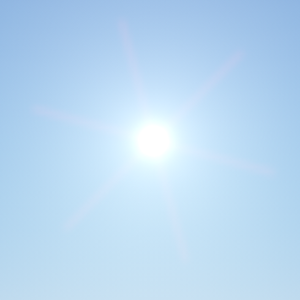

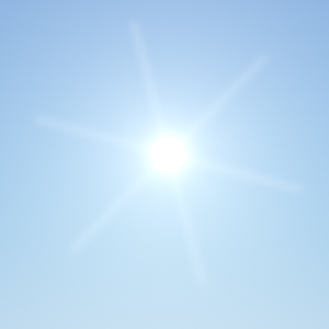

Cross#
Enabled | The value indicating if cross flares are enabled. выкл. by default.
Console access: render_cross (API control) |
Color | The color of the cross flares. To use this option, rendering of cross flares (see the Cross) should be enabled. vec4_one - default value (white) Console access: render_cross_color (API control)
Scale | The color multiplier.cross color scale — a multiplier for the color of cross flares. Higher values produce more pronounced flares. To use this option, rendering of cross flares (see the Cross) should be enabled. Range of values: [0.0f, inf]. The default value is : 1.0f. Console access: render_cross_scale (API control)
Shafts | The number of shafts in a cross flare. High number of flares can cause a FPS drop on low-performance hardware. To use this option, rendering of cross flares (see the Cross) should be enabled. Range of values: [2, 32]. The default value is : 4. Console access: render_cross_shafts (API control)
Length | The length of a cross flare relative to the screen width. Increasing this value also leads to fading of the shafts across their length. To use this option, rendering of cross flares (see the Cross) should be enabled. Range of values: [0.0f, 2.0f]. The default value is : 0.2f. Console access: render_cross_length (API control)
Angle | The cross flares orientation angle. To use this option, rendering of cross flares (see the Cross) should be enabled. Range of values: [-inf, inf]. The default value is : 45.0f. Console access: render_cross_angle (API control)
Threshold | The brightness threshold for areas to produce flare. The higher the threshold value, the brighter the area should be to produce a flare. To use this option, rendering of cross flares (see the Cross) should be enabled. Range of values: [0.0f, inf]. The default value is : 0.0f. Console access: render_cross_threshold (API control) |

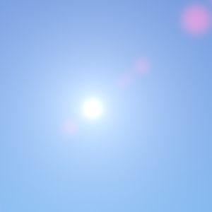

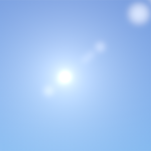

Lens#
Enabled | The value indicating if lens flares are enabled. выкл. by default.
Console access: render_lens (API control) |
Color | The color of HDR lens flares. To use this option, rendering of lens flares (see the Lens) should be enabled. vec4_one - default value (white) Console access: render_lens_color (API control)
Scale | The multiplier for color (see the LensColor) of HDR lens flares. To use this option, rendering of lens flares (see the Lens) should be enabled. Range of values: [0.0f, inf]. The default value is : 1.0f. Console access: render_lens_scale (API control)
Length | The length of the radial lens flare indicating if the whole radial lens flare is rendered on the screen or only a part of it. This option controls how lens flares pattern is distributed. To use this option, rendering of lens flares (see the Lens) should be enabled. Range of values: [0.0f, 1.0f]. The default value is : 0.5f. Console access: render_lens_length (API control) |
Radius | The radius of the spherical lens flares on the screen. 1.0f corresponds to a screen-wide radius (a lens flare is not visible). To use this option, rendering of lens flares (see the Lens) should be enabled. Range of values: [0.0f, 1.0f]. The default value is : 0.5f. Console access: render_lens_radius (API control)
Threshold | The value of the brightness threshold for areas to produce lens flares. The higher the threshold value, the brighter the area should be to produce flares. To use this option, rendering of lens flares (see the Lens) should be enabled. Range of values: [0.0f, 1.0f]. The default value is : 0.5f. Console access: render_lens_threshold (API control) |
Red |
Color displacement for the red channel of lens flares.
Green | Color displacement for the green channel of lens flares.
Blue | Color displacement for the blue channel of lens flares.
