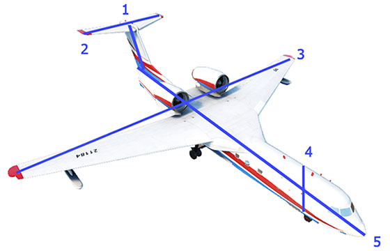

A collision detection segment is a line segment along which collision testing is performed by the IG. When a collision detection segment intersects a polygon, the IG registers a collision by sending the corresponding notification.
Collision detection testing is performed by the IG every frame.
The segment is defined by specifying the locations of its endpoints with respect to the associated entity’s body coordinate system. Figure below illustrates five segments defined for an aircraft.
Collision detection volumes are tested segment-to-polygon. An entity will not perform collision detection segment testing against its own geometry.
If an entity is destroyed, all collision detection segments defined for that entity will also be destroyed.
