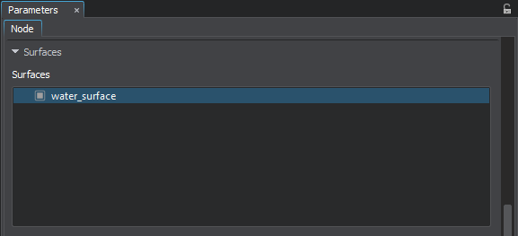

Both the global water and the water mesh have a surface approximating optical and dynamic behavior of water (the Surfaces section of the Parameters window):
The surface (ObjectWaterMesh) or water_surface (ObjectWaterGlobal) adds the following effects:
