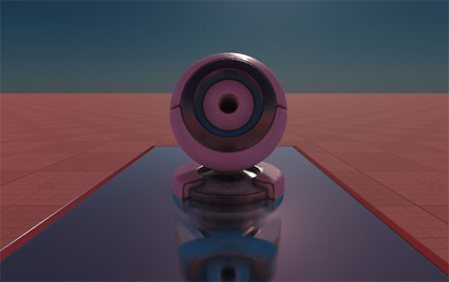

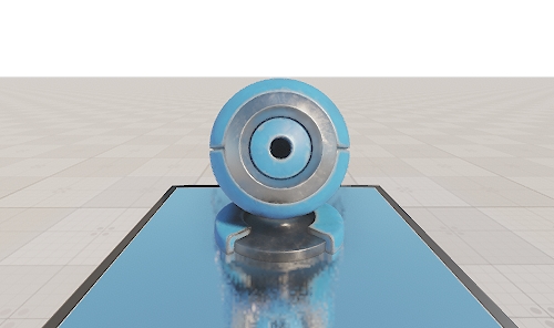

Sky Color#
Sky color multiplier allows changing the background color. You can also adjust the alpha channel of the color to specify transparency of the sky.

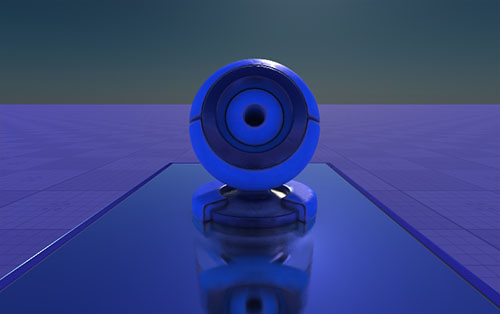

Albedo Color#
Albedo color multiplier. Using this parameter in pair with Albedo Visibility allows you to get the result as if the albedo colors buffer has been actually changed.
Albedo Visibility#
Visibility factor for the albedo color multiplier that specifies how much this multiplier affects the final image.

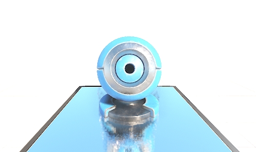

Metalness#
Metalness multiplier. By using this parameter, you can affect metalness of the scene: make all materials to be metals (Metalness = 1) or dielectrics (Metalness = 0). Using this parameter in pair with Metalness Visibility allows you to get the result as if the metalness stored in the shading buffer has been actually changed.
For example, if Metalness Visibility = 1, the result will be the following:
