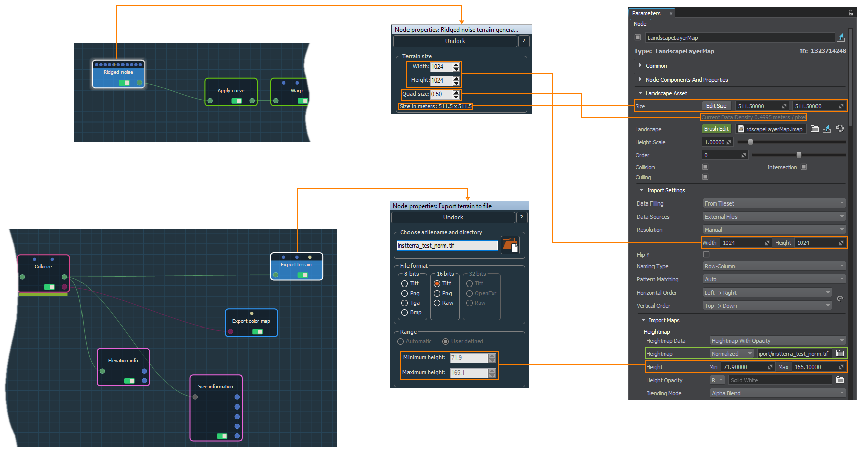

When exporting a heightmap from Instant Terra, pay attention to the following parameters available in the properties of the first node of the terrain creation graph:
  • Width and Height define the texture size in pixels.
  • Quad size — physical size in meters set for the quad, i.e. pixel, of the height map texture. Practically, this is a multiplier for the width and height that defines the physical size of the height map. The output size of the map in meters is provided below.
    For example, the 1024x1024 texture with the quad size of 0.5 will result in a terrain with a physical size of 511.5 x 511.5 meters.

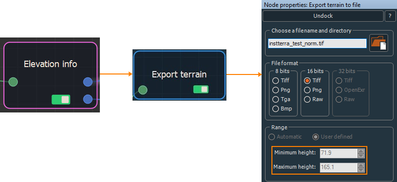

The height values are not identified at export by default, and the texture is imported to UNIGINE as unnormalized. To control the height, create the Elevation info node to generate a normalized texture with the min and max height values. Connect these values to the min and max height of the Export terrain node. As a result, the export file format switches to 16 bit and the height range values become available.

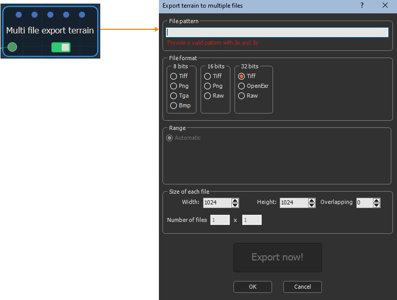

For large-scale terrains (more than 8K), export in tiles is recommended, this helps to avoid RAM limitations, especially when using 32 bit textures. The minimum recommended tile size is 1024 to avoid visual tiling artifacts. To do that, use the Multi file export terrain node:
The recommended file naming pattern is: filename_X$x_Y$y.

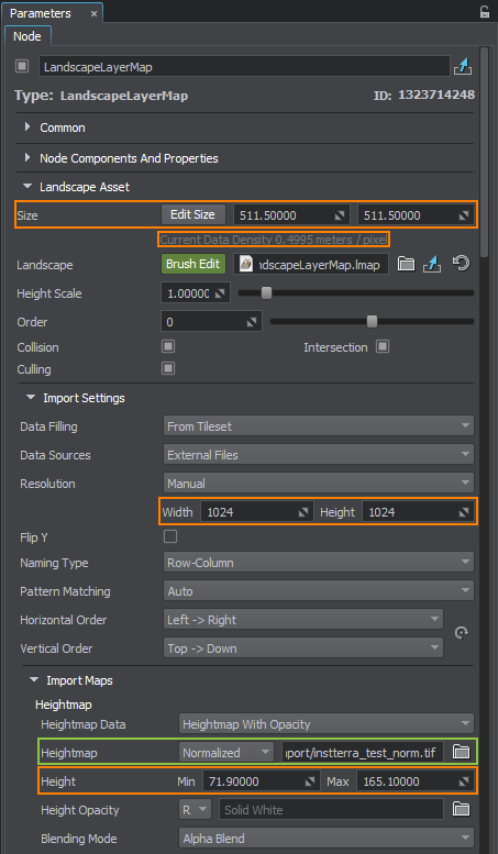

    • For the normalized heightmap, indicate the minimum and maximum heights obtained using the Elevation info node.
  • In the Landscape Asset section, set the actual size of your terrain in meters, the same as in Size in meters in Instant Terra.
  • Check the Current Data Density value. It shows the meter-to-pixel ratio, the same as Quad size in Instant Terra.
  • In the Import settings section, check the Resolution values. They define the resolution of the heightmap and correspond to Width and Height in Instant Terra. They are set automatically in most cases, but can also be adjusted, if required.
Click Reimport.
