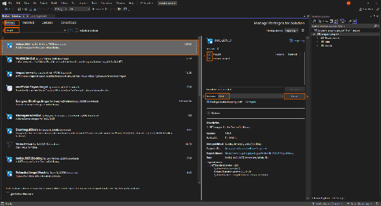

  6. Install the required NuGet package.
    • In Visual Studio 2022, go to Tools -> NuGet Package Manager -> Manage NuGet Packages for Solution…
    • Search for and install the ImGui.NET package (version 1.86.0).
