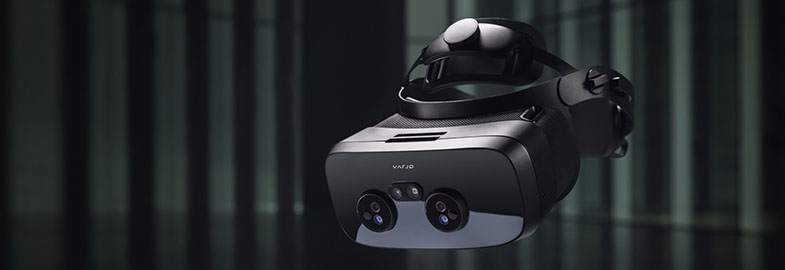

Varjo Integration and Supported Features
Varjo集成#
图片由 Varjo 提供。
Varjo's industrial-grade headsets with eye-tracking and mixed reality capabilities allow you to create VR and MR applications. With Mixed Reality, you can combine the real-world view from front-facing cameras mounted on the headset with the VR image.具有眼动追踪和混合现实功能的工业级耳机允许您创建VR和XR(eXtended Reality)应用程序。使用混合现实技术,您可以将耳机上的前置摄像头的真实世界视图与VR图像结合起来。
Moreover, there is hand-tracking in VR available for Varjo VR and XR headsets through the Ultraleap integration plugin. It provides finger fidelity, two-hand performance, higher tracking robustness, and a lot of other improvements.此外,通过Ultraleap集成插件,Varjo VR和XR耳机可以使用VR中的手部跟踪功能。它提供了手指保真度、双手性能、更高的跟踪鲁棒性以及许多其他改进。
