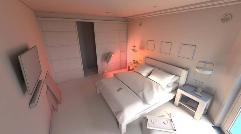

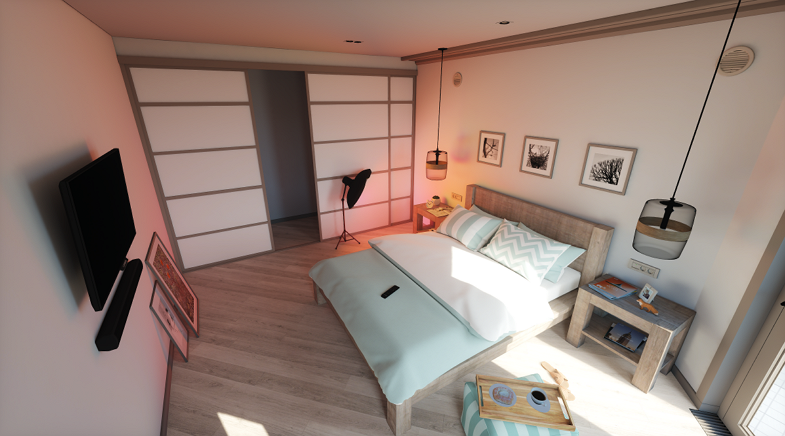

Lightmapping is a static global illumination technique using precalculated textures that store brightness and reflected color of lit surfaces. By using lightmapping you can avoid heavy computations of lighting in primarily static scenes.光照贴图是一种静态的全局照明技术,它使用预先计算的纹理来存储光照表面的亮度和反射颜色。通过使用光照贴图,可以避免在繁琐的静态场景中进行大量的光照计算。
Lightmapping is the most efficient solution enabling to achieve realistic diffuse lighting and keep the high performance. It is capable of giving high-detailed global illumination combined with simulation of many light bounces. The number of bounces is the key aspect of creating realistic lighting in bright scenes. When you use lightmapping it doesn’t matter how many rays, bounces, or light sources are there, as everything is calculated once and then baked in textures.光照贴图是最有效的解决方案,能够实现逼真的漫射照明并保持高性能。它能够提供高细节的全局照明,并结合许多光反弹的模拟。跳动次数是在明亮的场景中创建逼真的照明的关键方面。使用光照贴图时,无论有多少光线,反射或光源都无所谓,因为所有内容都会计算一次,然后烘焙为纹理。

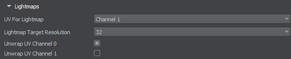

Proper and non-overlapping UV-coordinates of scenery are required for correct lightmapping. In the case your assets do not have these, automatic UV unwrapping on import is provided. The overall workflow is the following:正确且不重叠的景观UV坐标是正确进行灯光映射所必需的。如果您的资源没有它们,则会在导入时提供自动UV解包功能。
In the Import Settings for FBX, CAD models and UNIGINE .mesh assets, select the UV Channel and Target Resolution to be used for lightmaps and, if needed, check UV channels to unwrap. Traditionally, the 0 UV channel is used for texturing and the 1 channel is for lightmapping.在FBX,CAD模型和UNIGINE.mesh资源的导入设置中,选择要用于光照贴图的UV ChannelTarget Resolution,如果需要,请选择。 切换UV通道以展开。 传统上,0 UV通道用于纹理化,而1通道用于光照贴图。
The Lightmap Target Resolution parameter has the direct influence on the baking time and the final quality.Lightmap Target Resolution参数直接影响烘烤时间和最终质量。

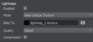

For all surfaces intended to be lightmapped, the Lightmaps Parameters are needed to be adjusted:对于所有打算进行光照贴图的表面,需要调整光照贴图参数
  1. Check Enabled to enable the feature.选中Enabled以启用该功能。
  2. Select the Bake Unique Texture, if you intend to use the integrated lightmapper.如果要使用Bake Unique Texture, 如果您打算使用集成的光照贴图器
  3. Also, you can specify the lightmap Texture generated in a third-party software. Select the Use Custom Texture mode for this purpose.另外,您可以指定在第三方软件中生成的光照图纹理。为此选择Use Custom Texture模式。

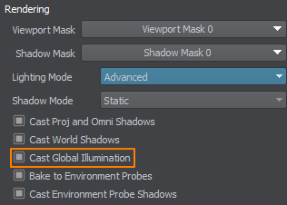

For a surface to contribute to static GI, it must have the Lighting Mode set to Static or have the Cast Global Illumination option enabled in the Advanced Lighting Mode.为了使表面有助于静态GI烘焙,必须启用Cast Global Illumination选项。

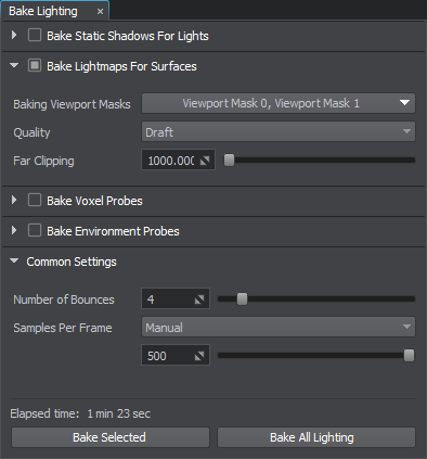

  1. Enable the Lightmap buffer: Rendering -> Buffers -> Lightmap.启用Lightmap缓冲区:Rendering -> Buffers -> Lightmap
  2. Open the Bake Lighting window.打开Bake Lighting窗口。
  3. Enable Bake Lightmaps for Surfaces. Adjust the baking settings:
    • Set up the Baking Viewport Masks.Set up the Baking Viewport Masks.
    • Select the desired baking Quality. The Draft option provides the shortest baking time and is suitable for development iterations, while the Ultra quality engages the biggest possible number of light rays to be simulated and the best sampling resolution.Select the desired baking Quality. The Draft option provides the shortest baking time and is suitable for development iterations, while the Ultra quality engages the biggest possible number of light rays to be simulated and the best sampling resolution.
    • Adjust the Far Clipping Distance for simulated light rays.Adjust the Far Clipping Distance for simulated light rays.
    Set up the Baking Viewport Masks.Select the desired baking Quality. The Draft option provides the shortest baking time and is suitable for development iterations, while the Ultra quality engages the biggest possible number of light rays to be simulated and the best sampling resolution.Adjust the Far Clipping Distance for simulated light rays.
    启用Bake Lightmaps for Surfaces。调整烘焙设置:
    • Set up the Baking Viewport Masks.设置Baking Viewport Masks
    • Select the desired baking Quality. The Draft option provides the shortest baking time and is suitable for development iterations, while the Ultra quality engages the biggest possible number of light rays to be simulated and the best sampling resolution.选择所需的烘焙QualityDraft选项提供了最短的烘焙时间,并且适合于开发迭代,而Ultra的质量则吸引了尽可能多的要模拟的光线和最佳的采样分辨率。
    • Adjust the Far Clipping Distance for simulated light rays.调整Far Clipping Distance以模拟光线。
  4. Adjust the Common Settings:
    • Select the number of light ray bounces. Higher values will result in a brighter lighting since each surface receives more photons.Select the number of light ray bounces. Higher values will result in a brighter lighting since each surface receives more photons.
    • Set the number of samples calculated per frame. This parameter is available for adjustment during baking process.Set the number of samples calculated per frame. This parameter is available for adjustment during baking process.
    Select the number of light ray bounces. Higher values will result in a brighter lighting since each surface receives more photons.Set the number of samples calculated per frame. This parameter is available for adjustment during baking process.
    调整通用设置:
    • Select the number of light ray bounces. Higher values will result in a brighter lighting since each surface receives more photons.选择光线反射的次数。更高的值将导致更亮的照明,因为每个表面接收更多的光子。
    • Set the number of samples calculated per frame. This parameter is available for adjustment during baking process.设置每帧计算的样本数。此参数可在烘焙过程中进行调整。
  5. Start baking process by clicking Bake All Lighting and wait for it to finish. Live preview is available. Several iterations (one per bounce) will be simulated for each affected surface.
    You can stop the process at any moment by using the Stop button and you will be prompted to keep the achieved result or restore the previous textures.You can stop the process at any moment by using the Stop button and you will be prompted to keep the achieved result or restore the previous textures.
    单击Bake All Lighting开始烘焙过程,然后等待其完成。实时预览可用。对于每个受影响的表面,将模拟几次迭代(每反弹一次)。
    您可以随时使用Stop按钮停止该过程,并且系统会提示您保留所获得的结果或恢复以前的纹理。
  6. Upon completion, generated lightmaps will be saved in the bake_lighting/lightmaps folder and applied to the corresponding surfaces.完成后,生成的光照贴图将保存在bake_lighting/lightmaps文件夹中,并应用于相应的曲面。
