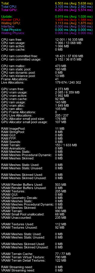

To show profiler statistics in runtime, type the show_profiler 1 command in the console. To disable the profiler in runtime, type show_profiler 0 in the console.要在运行时显示分析器统计信息,请在控制台中输入 show_profiler 1 命令。要在运行时禁用分析器,请在控制台中输入 show_profiler 0
You can configure the information displayed by the profiler by using the corresponding console commands.您可以通过使用相应的控制台命令来配置分析器显示的信息。
The following profiling modes are available:可以使用以下分析模式:
In the Editor, the profiler is also accessible via the toolbar (Tools -> Performance Profiler):在编辑器中,您还可以通过工具栏访问性能分析器(Tools -> Performance Profiler)。

Generic Profiler Enabled启用通用配置文件
Total Total time in milliseconds taken to both calculate and render the current frame. This is the duration of the main loop in the application execution sequence.计算和渲染当前帧所花费的总时间(以毫秒为单位)。这是应用程序执行顺序中的主循环的持续时间。
Total = Total CPU + Waiting GPU
Total CPU Total time in milliseconds taken to prepare the current frame (including update, render, and swap).准备当前帧(包括 update,render swap )花费的总时间(以毫秒为单位)。
Total GPU 在GPU上渲染当前帧所花费的总时间(以毫秒为单位)。
此计数器可能在某些GPU上不起作用。

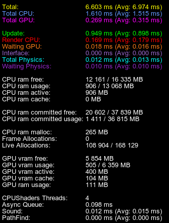

Update Time taken to update application logic. This includes executing all steps in the update() function of the world script. It also includes the update of states of all nodes (for example, update of the skinned animation or of a particle system to spawn new particles).
  • If the Update time is too high, it signals that you need to optimize the application logic executed each frame.If the Update time is too high, it signals that you need to optimize the application logic executed each frame.
  • You may also need to decrease the number of objects in the world, as updating their states (spawn particles by the particle systems, play skinned mesh animation, etc.) increases the load.You may also need to decrease the number of objects in the world, as updating their states (spawn particles by the particle systems, play skinned mesh animation, etc.) increases the load.
If the Update time is too high, it signals that you need to optimize the application logic executed each frame.You may also need to decrease the number of objects in the world, as updating their states (spawn particles by the particle systems, play skinned mesh animation, etc.) increases the load.
更新应用程序逻辑所花费的时间。这包括在世界脚本的 update() 功能中执行所有步骤。它还包括所有节点状态的更新(例如,更新蒙皮动画或更新粒子系统以生成新粒子)。
  • If the Update time is too high, it signals that you need to optimize the application logic executed each frame.如果更新时间太长,则表明您需要优化每个帧执行的应用程序逻辑。
  • You may also need to decrease the number of objects in the world, as updating their states (spawn particles by the particle systems, play skinned mesh animation, etc.) increases the load.您可能还需要减少世界里的对象数量,因为更新它们的状态(通过粒子系统生成粒子,播放蒙皮的网格动画等)会增加负担。
Render CPU Time taken to prepare all data to be rendered in the current frame and feed rendering commands from the CPU to the GPU. If Render CPU time is too high, it signals that art assets may need to be optimized, for example:
  • LOD system should be used;LOD system should be used;
  • polygon count of models should be reduced.polygon count of models should be reduced.
LOD system should be used;polygon count of models should be reduced.
准备要在当前帧中渲染的所有数据并将渲染命令从CPU馈送到GPU所花费的时间。如果“渲染CPU”时间过长,则表示可能需要优化艺术品资源,例如:
  • LOD system should be used;应当使用 LOD 系统;
  • polygon count of models should be reduced.应该减少模型的多边形数量。

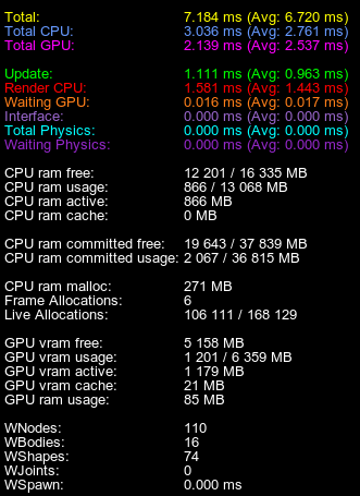

Waiting GPU Time between completing all calculations on the CPU up to the moment when the GPU has finished rendering the frame. (See the illustration). This counter is useful to analyze the bottleneck in your application's performance.
  • When Waiting GPU time is equal to 0, it signals that scripts take too long to be updated and calculations are too intensive for CPU to perform them fast enough. In this case, your application has a CPU bottleneck. Optimize your update block in the world scripts or reduce the number of objects updated each frame.When Waiting GPU time is equal to 0, it signals that scripts take too long to be updated and calculations are too intensive for CPU to perform them fast enough. In this case, your application has a CPU bottleneck. Optimize your update block in the world scripts or reduce the number of objects updated each frame.
  • High Waiting GPU time means one of the following:
    • low framerate signals that there exists a GPU bottleneck. The art content needs to be optimized in this case.low framerate signals that there exists a GPU bottleneck. The art content needs to be optimized in this case.
    • consistently high framerate means you have free CPU resources available to process more numbers in the update() of the world script.consistently high framerate means you have free CPU resources available to process more numbers in the update() of the world script.
    low framerate signals that there exists a GPU bottleneck. The art content needs to be optimized in this case.consistently high framerate means you have free CPU resources available to process more numbers in the update() of the world script.
When Waiting GPU time is equal to 0, it signals that scripts take too long to be updated and calculations are too intensive for CPU to perform them fast enough. In this case, your application has a CPU bottleneck. Optimize your update block in the world scripts or reduce the number of objects updated each frame.High Waiting GPU time means one of the following:
从完成CPU上的所有计算到GPU完成渲染帧之间的时间。(请参见插图)。此计数器对于分析应用程序性能的瓶颈很有用。
  • When Waiting GPU time is equal to 0, it signals that scripts take too long to be updated and calculations are too intensive for CPU to perform them fast enough. In this case, your application has a CPU bottleneck. Optimize your update block in the world scripts or reduce the number of objects updated each frame.等待GPU时间等于 0 时,它表示脚本花费的时间太长,无法更新,并且计算量太大,CPU无法快速执行它们。在这种情况下,您的应用程序会遇到CPU瓶颈。在世界脚本中优化您的更新块,或减少每帧更新的对象数。
    GPU等待时间过长意味着以下情况之一:
    • low framerate signals that there exists a GPU bottleneck. The art content needs to be optimized in this case.低帧率表示存在GPU瓶颈。在这种情况下,艺术内容需要进行优化。
    • consistently high framerate means you have free CPU resources available to process more numbers in the update() of the world script.持续高的帧速率意味着您可以在世界脚本的 update()中拥有免费的CPU资源来处理更多数字。
Interface Time taken to render all GUI widgets.呈现所有GUI小部件所需的时间。
Total Physics Time taken to perform all physics calculations.执行所有物理计算所需的时间。
Waiting Physics 物理模块等待渲染过程完成以返回主线程并执行其余物理周期的时间段。

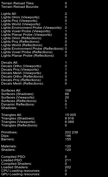

Rendering Profiler
渲染分析器#
Rendering Profiler Enabled渲染分析器已启用
The following statistics are displayed in addition to the generic and memory statistics:除了通用内存统计信息外,还显示以下统计信息:
当通过UnigineEditor接口(Tools -> Performance Profiler -> Rendering)启用时,分析器还提供内存统计信息。
但是,如果使用show_profiler_render 1控制台命令启用它,则只会显示下面提供的统计信息。
Terrain Reload Tiles Number of Landscape Terrain tiles that are currently awaiting reloading after being modified.修改后当前正在等待重新加载的Landscape Terrain 图块的数量。
Terrain Reload Bounds Number of events causing reloading of tiles (one bound may cause reloading of multiple tiles).导致重新加载图块的事件数(一个边界可能导致重新加载多个图块)。
Dynamic Reflections 每帧绘制的动态反射的数量。对于立方体贴图反射,如果所有六个面都更新,则每帧渲染六个反射。
Lights Number of light passes rendered per frame. This means that the counter displays the number of all light sources that are currently seen illuminating something in the viewport. This value also includes additional passes for rendering lights in the reflecting surfaces (if dynamical reflections are used). Plain 2D reflection will multiply the number of rendering passes by two, while cubemap-based reflection with six faces updated each frame will multiply the number of rendering passes by six.
Each light redraws mesh polygons it illuminates. That is why the higher the number of light sources, the higher the number of polygons the graphics card has to render, and the lower the performance. For example, using two omni lights will as much as double the rendered geometry they shine on.Each light redraws mesh polygons it illuminates. That is why the higher the number of light sources, the higher the number of polygons the graphics card has to render, and the lower the performance. For example, using two omni lights will as much as double the rendered geometry they shine on.
每帧渲染的光通过数。这意味着计数器显示所有光源的数量,这些光源是当前可见的,并照亮视口中的某些东西。此值还包括用于在反射面中渲染光源的额外通道(如果使用动态反射)。一个普通的2D反射将渲染通道的数量乘以2,而基于立方体贴图的反射,每帧更新6个面,将渲染通道的数量乘以6。
Each light redraws mesh polygons it illuminates. That is why the higher the number of light sources, the higher the number of polygons the graphics card has to render, and the lower the performance. For example, using two omni lights will as much as double the rendered geometry they shine on.每个光照都会重绘它所照亮的网格多边形。这就是为什么光源数量越多,显卡必须渲染的多边形数量就越多,性能就越低。例如,使用两个omni光源将使它们所照射的渲染几何体增加一倍。
Shadows Number of shadow passes rendered per frame. Each light requires a shadow pass to calculate the shadows. Again, if there are reflecting surfaces with shadows drawn reflected, this will increase the number of shadow passes.每帧渲染的阴影通道数。每个光源都需要一个阴影通道来计算阴影。同样,如果有反射曲面的阴影绘制反射,这将增加阴影通过的数量。
Number of decals rendered per frame (in all rendering passes). If a decal has any additional effect (is transparent, emits light, lit by a light source, or has any other visual effect) that involves an additional rendering pass for this decal, this decal will be rendered additionally in every corresponding pass, thus the total number of rendered decals will increase.每帧渲染的贴花数(在所有渲染通道中)。如果一个贴花有任何额外的效果(透明、发光、光源照明或有任何其他视觉效果),涉及到这个贴花的额外渲染通道,这个贴花将在每个相应的通道中额外渲染,因此渲染的贴花总数将增加。
Surfaces
Number of surfaces rendered per frame (in all rendering passes). If a surface has any additional effect (is transparent, emits light, lit by a light source, or has any other visual effect) that involves an additional rendering pass for this surface, this surface will be rendered additionally in every corresponding pass, thus the total number of rendered surfaces will increase.每帧渲染的曲面数(在所有渲染通道中)。如果一个曲面有任何额外的效果(透明、发光、由光源照明或具有任何其他视觉效果),涉及该曲面的额外渲染通道,则该曲面将在每个相应的通道中额外渲染,因此渲染曲面的总数将增加。
Triangles All Total number of triangles rendered per frame including all polygons that are currently visible in the viewport as well as the ones rendered in the process of shadows rendering.每帧渲染的三角形总数,包括当前在视口中可见的所有多边形以及在阴影渲染过程中渲染的多边形。
Triangles Shadows Number of triangles rendered per frame in the process of shadows rendering. Each light source has to redraw the geometry it illuminates, increasing the overall count of rendered triangles. In order to avoid GPU bottleneck, keep the number of dynamic light sources and their radius as low, as possible.在阴影渲染过程中,每帧渲染的三角形数量。每个光源导致再次绘制它照亮的几何图形,增加渲染三角形的总数。为了避免GPU瓶颈,保持动态光源的数量和半径尽可能低。
Triangles Viewport Number of triangles rendered per frame. This includes all polygons that are currently visible in the viewport (geometry).每帧渲染的三角形数。这包括当前在视口中可见的所有多边形(几何)。
Primitives Number of geometric primitives rendered per frame. This includes points, lines, triangles, and polygons. The visualizer and the profiler itself also add to this counter. The value differs dramatically if tessellation is used. In this case, Triangles reports the number of triangles in the coarse mesh, while Primitives shows statistics on the number of tessellated primitives.每帧渲染的几何图元数。这包括点、线、三角形和多边形。可视化工具和分析器本身也会添加到此计数器。如果使用镶嵌,这个值会有很大的不同。在这种情况下,Triangles报告粗网格中的三角形数量,而Primitives显示关于镶嵌图元数量的统计信息。
Dips The number of draw calls. The higher the number of identical mesh surfaces with the same material, the more effective the instancing is (enabled by default). This means, the number of draw calls is minimized offloading both the CPU and the GPU.
You can compare the number of surfaces (Surfaces) and the number of DIPs used to render them. For example, if there are 30000 surfaces and 1000 DIPs, it means that 30 instanced surfaces of meshes are rendered per only one draw call (Surfaces/Dips). Thus the instancing provides performance boost.
绘制调用的数量。具有相同材质的相同网格曲面的数量越多,实例化就越有效(默认情况下启用)。这意味着,绘制调用的数量可以最大限度地减少cpu和GPU的负载。
您可以比较曲面的数量(Surfaces)和用于渲染它们的DIP的数量。例如,如果有30000个曲面和1000个DIP,这意味着每次绘制调用(Surfaces / Dips)渲染30个网格实例表面曲面。因此,实例化提供了性能提升。
Materials Number of materials set per frame. (Materials are set in each of the rendering passes.)每帧设置的材质数量。(材质设置在每个渲染通道中。)
Shaders Number of shaders set per frame. (Shaders are set in each of the rendering passes; hence if only one material used, its shader still needs to be set several times. When nothing is visible and the screen is black, even in this case the composite shader is still used.) 每帧设置的着色器数量。(着色器在每个渲染通道中设置;因此,如果只使用一种材质,其着色器仍然需要设置几次。当没有任何东西是可见的并且屏幕是黑色的,即使在这种情况下,复合着色器仍然被使用。)
Compiled PSO 当前编译的PSO数量。
Loaded PSO 当前加载的PSO数量。
Compiled Shaders Number of shaders that are currently compiled.当前编译的着色器数。
Loaded Shaders Number of shaders loaded from a precompiled cache or disk. Reflects successful reuse of prebuilt shaders, which improves performance and reduces runtime overhead.加载到RAM的着色器数量。

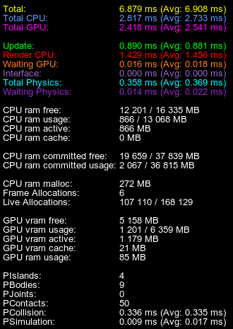

Physics Profiler
物理分析器#
This profiler shows statistics within the Physics radius.此分析器显示物理半径内的统计信息。
You can enable this profiler via the UnigineEditor interface (Tools -> Performance Profiler -> Physics) and via the show_profiler_physics 1 console command.您可以通过UnigineEditor接口(Tools -> Performance Profiler -> Physics)和show_profiler_physics 1控制台命令启用此分析器。
Physics Profiler Enabled物理分析器已启用
The following statistics are displayed in addition to the generic one:除了通用统计信息外,还显示以下统计信息:
PIslands 物理半径内可以单独计算的物理的数量。这个数字越低,多线程的效率就越低。
PBodies Number of bodies within the physics radius.物理半径实体的数量。
PJoints Number of joints within the physics radius.物理半径关节的数量。
PContacts Total number of contacts within the physics radius; this includes contacts between the bodies (their shapes) and body-mesh contacts.物理半径内的总接触数;这包括体之间的接触(它们的形状)和体网格触点之间的触点。
PCollision Duration of the collision detection phase of physic simulation when collisions between objects are found.当发现物体之间的碰撞时,物理模拟的碰撞检测阶段的持续时间。
PSimulation Duration of all simulation phases added together.所有模拟阶段的持续时间加在一起.

World Management Profiler
世界管理分析器#
This profiler shows statistics on the whole world.这个分析器显示了整个世界的统计数据。
When in the editor mode, enabling and disabling of the node, body or a joint can increase values of world profiler counters, as a (limited) number of clones are created for undo/redo purposes.在编辑器模式下,启用和禁用节点、物体或关节可以增加世界分析器计数器的值,因为为撤消/重做目的创建了(有限)数量的克隆。
World Management Profiler Enabled世界管理分析器已启用
You can enable this profiler via the UnigineEditor interface (Tools -> Performance Profiler -> World Management) and via the show_profiler_world 1 console command.您可以通过UnigineEditor接口(Tools -> Performance Profiler -> World Management)和show_profiler_world 1控制台命令启用此分析器。
The following statistics is displayed in addition to the generic one:除了通用统计信息外,还显示以下统计信息:
WNodes Total number of nodes in the world (both enabled and disabled).世界节点总数(启用和禁用的)。
WBodies Total number of bodies in the world.世界里物体的总数。
WShapes Total number of shapes in the world.世界里形状的总数。
WJoints Total number of joints in the world.世界里关节的总数。
WSpawn Time in milliseconds that the engine spends on generating content in procedural nodes (such as grass, clutters, world layers). 引擎在程序节点(如草,Clutter,世界层)中生成内容所花费的毫秒时间。
Thread Profiler
线程分析器#
Thread Profiler Enabled线程分析器已启用
You can enable this profiler via the UnigineEditor interface (Tools -> Performance Profiler -> Thread) and via the show_profiler_thread 1 console command.您可以通过UnigineEditor接口(Tools -> Performance Profiler -> Thread)和show_profiler_thread 1控制台命令启用此分析器。
AsyncQueue Time of asynchronous loading of resources (files/meshes/images/nodes), in milliseconds. In addition to timing metrics, you can also inspect detailed information about files, images, meshes, and nodes using the async_queue_info console command.异步加载资源(文件/网格/图像/节点)的时间,以毫秒为单位。
Sound Time of asynchronous loading of sounds, in milliseconds.异步加载声音的时间,以毫秒为单位。
PathFind Time of asynchronous pathfinding calculations, in milliseconds.异步寻路计算的时间,以毫秒为单位。
CPUShaders Threads Number of internal engine threads used for CPU shaders.用于CPU着色器的内部引擎线程数。
