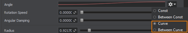

To configure a parameter as a curve, select either of the following:若要将参数设置为曲线,请选择以下任意一种:
Curve The parameter value changes over input value (e.g. time) based on the curve defined in Curve Editor.
参数值根据在曲线编辑器中定义的曲线改变输入值(例如时间)。
Between Curve There are two curves that define the limits, and a random value is taken at every moment of time within these limits. The parameter value changes over time based on this randomly generated set of values.
有两条曲线定义了极限,并且在这些极限内的每个时间点都会获取一个随机值。参数值基于此随机生成的值集随时间变化。
In case of a color setting, there is a dropdown menu with a selection between a color and a curve.在颜色设置的情况下,有一个下拉菜单,在颜色和曲线之间进行选择。

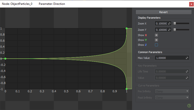

The horizontal axis represents the input value, such as life time. The values are normalized and depend on the corresponding value of the node (for example Life Time).横轴表示输入值,例如寿命。这些值已标准化,并取决于节点对应的值(比如 Life Time )。

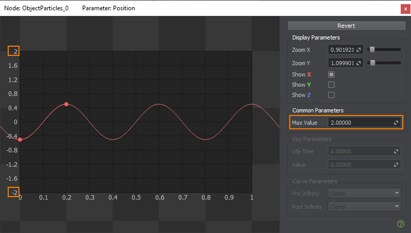

The vertical axis represents the range of available parameter values. The scale is controlled by Max Value.垂直轴表示可用参数值的范围。比例尺由Max Value控制。

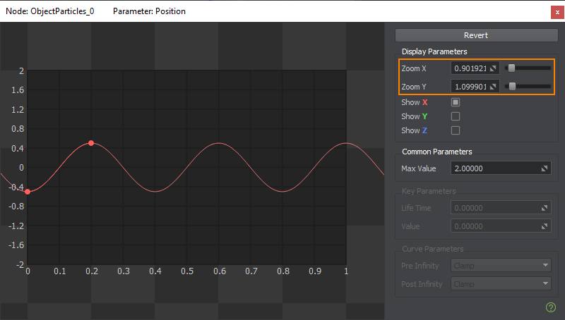

The curve view can be zoomed in and out along both axes by using the scroll wheel, or along either axis individually by using the corresponding display parameter.曲线视图可以通过使用滚轮沿着两个轴放大缩小,也可以通过使用相应的显示参数单独沿着任何一个轴放大缩小
The curve view can be panned by dragging mouse while holding the middle button pressed or holding the Ctrl button and using the cursor keys.按住中间按钮或按住Ctrl按钮并使用光标键,同时拖动鼠标可以平移曲线视图。

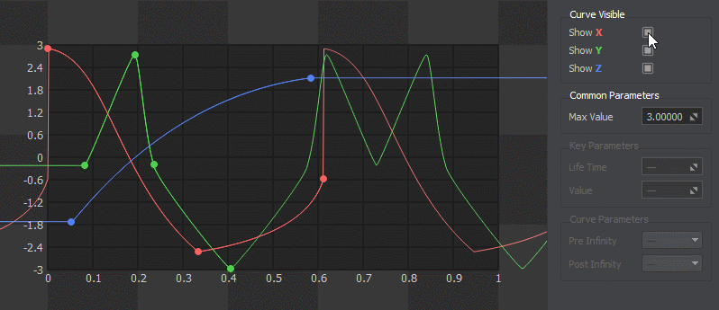

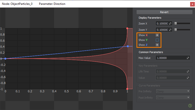

If a parameter is adjusted via multiple curves, you can hide some of them via the corresponding checkboxes with color coding.如果参数是通过多条曲线调整的,则可以通过相应的带有颜色编码的复选框隐藏

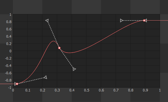

Adding and Editing Keys
添加和编辑点#
Curves are edited via keys (points on the curve) by changing their position and manipulating their tangents.通过键(曲线上的点)通过更改曲线的位置和操纵其切线来编辑曲线。
To add a key, right-click on the curve at the point where the key should be placed and select Add key.添加点,请在曲线上的应放置点的位置上单击鼠标右键,然后选择Add key
Removing a key can be performed by right-clicking on it and selecting Remove key.删除点,可以通过右键单击并选择Remove key来执行。

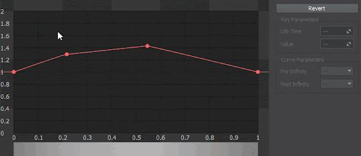

Multiple keys can be selected by either of the following ways:可以通过以下两种方式之一选择多个点
  • Press down Ctrl and click the required keys.按下Ctrl并单击所需的点。
  • Click on an empty spot and drag to make the rectangular selection.单击一个空白点并拖动以进行矩形选择。
These two ways can be combined: for example, select keys using a rectangle, then press down Ctrl and click on the keys you want to add.这两种方式可以组合使用:例如,使用矩形选择点,然后按下Ctrl并单击要添加的点。
Unselecting keys from a rectangle is also done by clicking on them with the Ctrl key hold down.还可以通过按住Ctrl键单击来从矩形中取消选择点。
To move all selected keys, press down the left mouse button on one of the keys and drag them around.要移动所有选定的点,请在其中一个点上按下鼠标左键并将其拖动。
Focusing on selected keys is done by pressing F on the keyboard.通过按键盘上的 F 键来聚焦选定的点。
Focusing on the selected keys
To deselect all keys, just click anywhere.要取消选择所有点,只需单击任意位置。
Editing Tangents
编辑切线#
Each key has two tangents to control the curve shape to the left and to the right of the key.每个关键点都有两个切线,以控制关键点左右两侧的曲线形状。
To edit a tangent, select a key, then select a tangent and drag it around.要编辑切线,请选择一个关键点,然后选择一个切线并将其拖动。
When multiple keys are selected, you can also modify every single tangents.选择多个关键点时,您也可以修改每个切线。

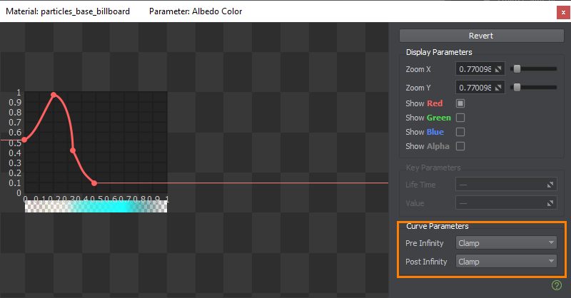

For the curve, the following parameters are available:对于曲线,可以使用以下参数:
  • Pre Infinity — the behaviour of the curve prior to the first (leftmost) key.Pre Infinity —第一个(最左侧)关键点之前的曲线的行为。
  • Post Infinity — the behaviour of the curve after the first (rightmost) key.Post Infinity —第一个(最右边)键后曲线的行为。
These parameters can be used to create loops, i.e. repeat the effect that you created before and after the explicit range defined by the keys.这些参数可用于创建循环,即重复在按键定义的显式范围之前和之后创建的效果。
For these parameters, the following options can be applied:对于这些参数,可以应用以下选项:
Clamp The value of the start or the end key is retained. Use this option if you don't want any changes before or after the effect created by the curve.
开始键或结束键的值将保留。如果您不想在曲线创建的效果之前或之后进行任何更改,请使用此选项。

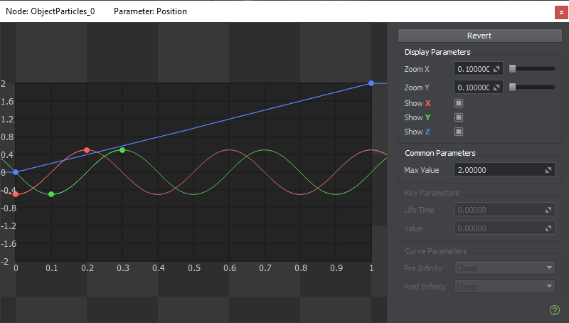

The number of curves varies depending on the type of the controlled parameter: for example, angle has a single component (angle value), while direction has three (X, Y, and Z axes), a color may have up to four components (RGBA channels).
曲线的数量根据受控参数的类型而变化:例如,角度具有单个分量(角度值),而方向具有三个分量(X,Y和Z轴),则颜色可能多达四个分量(RGBA通道)。
