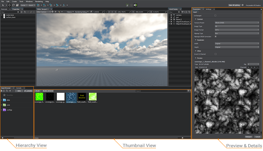

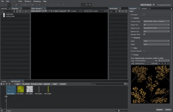

Asset Browser consists of the Hierarchy View and the Thumbnail View. You can use them both, or move the dividing bar between them to either side, and use only one of them, as demonstrated below:资源浏览器由层次结构视图和缩略图视图组成。您可以同时使用它们,或者将它们之间的分隔条移动到任意一侧,并仅使用其中一个,如下所示:
Rearranging Asset Browser重新排列资源浏览器

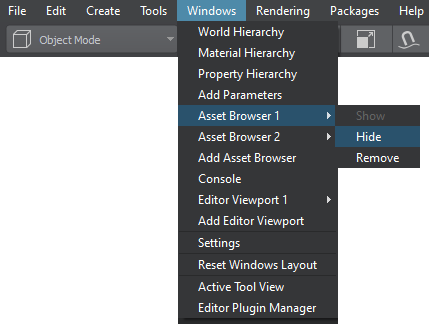

To facilitate managing assets, you can create multiple Asset Browser windows via the menu bar: Windows -> Add Asset Browser and stack them anywhere.为了方便管理资源,您可以通过菜单栏创建多个资源浏览器窗口: Windows -> Add Asset Browser,并将它们堆叠在任何地方。
Each of the created windows is listed in the Windows menu and can be hidden, shown or removed, if required.每个创建的窗口都列在Windows菜单中,如果需要,可以隐藏、显示或删除。

Hierarchy View is located on the left side of the Asset Browser interface. It contains a list of all folders and assets within your project. The following root folders are available: 层次结构视图位于资源浏览器界面的左侧。它包含项目中所有文件夹和资源的列表。根目录如下:
  • data — contains the data stored in the data folder of the project root. It is the folder where all work with the project content is performed. data-包含存储在项目根目录的data文件夹中的数据。这是执行项目内容所有工作的文件夹。
  • core — contains the built-in core assets. These assets are available for every project by default.
    Core assets are read-only.Core assets are read-only.
    core-包含内置核心资源。默认情况下,这些资源可用于每个项目。
    Core assets are read-only.核心资源是只读的。
When a folder is selected from the list by clicking, its contents will be shown in the Thumbnail View to the right. You can use a small triangle next to the folder to expand or collapse it, displaying nested folders and assets.通过单击从列表中选择一个文件夹时,其内容将显示在右侧的缩略图视图中。您可以使用文件夹旁边的小三角形来展开或折叠它,显示其中包含的任何嵌套文件夹。
Thumbnail View
缩略图视图#
Thumbnail View displays icons for all assets in the selected project folder after applying all selected filters. You can select the types of assets to be displayed using the Filter icon in the top right corner of the panel.应用所有选定的过滤器后, 缩略图视图显示所选项目文件夹中所有资源的图标。您可以使用面板顶部的Filter下拉菜单选择要显示的资源类型。
The assets available in the Thumbnail View can be dragged directly into the editor viewport.资源视图中可用的资源可以直接拖到编辑器视口中。
You can create a new folder, material or property by right-clicking somewhere within the panel and choosing the desired item from the context menu. The list of assets can be navigated by using the scroll bar or rotating the mouse wheel.可以通过右键单击面板中的某个位置并从上下文菜单中选择所需的项目来创建新的文件夹,材质或属性。资源列表可以通过使用滚动条或旋转鼠标滚轮来导航。
The icons can be resized using the slider at the bottom of the panel; they will be replaced by a hierarchical list view if the slider is moved to the extreme left.可以使用面板底部的滑块调整图标的大小。如果将滑块移到最左端,则将它们替换为分层列表视图。
To show the asset file location in the standard file browser window, right-click on the asset and choose Show in Explorer.要在标准文件浏览器窗口中显示资源文件位置,请右键单击资源,然后选择Show in Explorer
Preview and Details
预览和详细信息#
Preview and Details are displayed in the Parameters window on the right side of the Asset Browser interface. The information is available for the selected asset depending on its type. 预览和详细信息在资源浏览器界面右侧的Parameters窗口中打开。根据所选资源的类型,该信息可用于该资源。

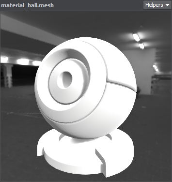

3D geometry Asset (such as .mesh, .node, .fbx) is shown in a test environment with default mesh_base base material applied. 3D几何资源(例如.mesh, .node, .fbx)在测试环境中显示,默认环境中应用了mesh_base基础材质。
You can rotate the model with a mouse, holding the left button pressed, and scale it with the mouse wheel.您可以按住鼠标左键并用鼠标滚轮缩放模型。

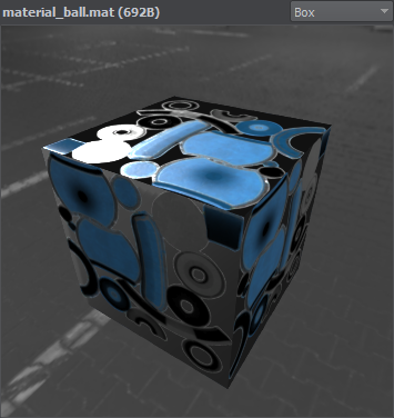

Material asset is shown as applied to a primitive (Sphere, Material Ball, Box, Capsule, Cylinder, Dodecahedron, or Icosahedron).显示的材质资源已应用于基本体(球体,材质球,盒子,胶囊,圆柱体,十二面体或二十面体)。
You can rotate the primitive with a mouse, holding the left button pressed, and scale it with the mouse wheel.可以使用鼠标旋转图元,同时按住向左键,然后使用鼠标滚轮缩放它。

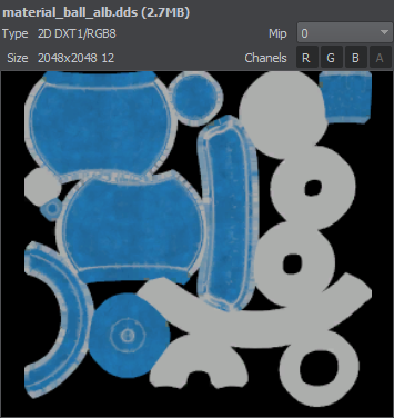

A texture asset is shown as an image, with information and controls at the top of the panel. These controls are used to select Red, Green, Blue and Alpha channels and MipMapping level.纹理资源显示为图像,信息和控件位于面板顶部。这些控件用于选择红色,绿色,蓝色和Alpha通道以及MipMapping级别。
You can move the image with a mouse, holding the left button pressed, and scale it with the mouse wheel.您可以按住鼠标左键并用鼠标滚轮缩放图像。
