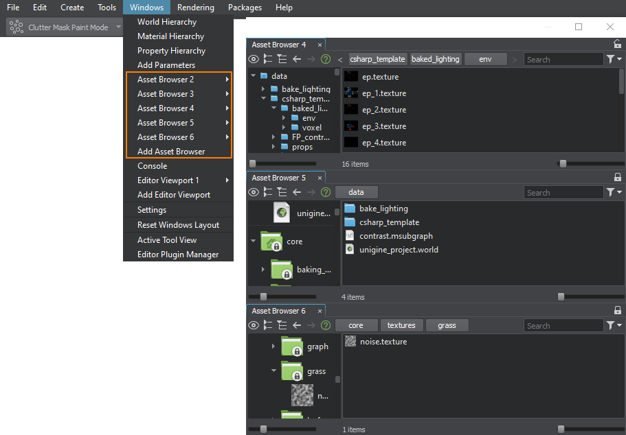

To facilitate managing assets, you can create multiple Asset Browser windows via the menu bar: Windows -> Add Asset Browser and stack them anywhere. Each of the created windows is also listed in the Windows menu and can be hidden or removed, if required.为了方便管理资源,您可以通过菜单栏创建多个资源浏览器窗口:Windows -> Add Asset Browser,并将它们堆叠在任何地方。每个创建的窗口也列在 Windows 菜单中,如果需要,可以隐藏或删除。
Clicking on the lock sign in the upper right corner of each Asset Browser window will prevent automatic switching of the thumbnail view (the right side of the Asset Browser window) if an asset in another folder is selected.单击每个资源浏览器窗口右上角的锁定标志 (资源浏览器窗口的右侧)以防止在选择其他文件夹中的资源时自动切换缩略图视图

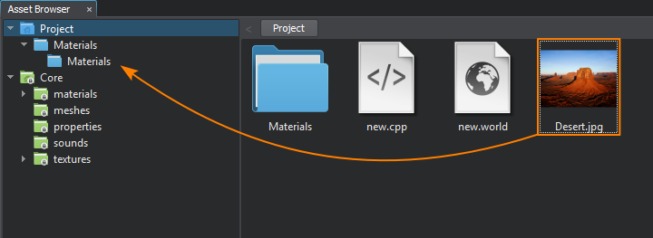

To move a folder to another location within your project you can select it in the Hierarchy View and simply drag it to the target folder.要将文件夹移动到项目中的其他位置,可以在层次结构视图中将其选中,然后将其拖动到目标文件夹中。
To move several folders select them in the Thumbnail View and drag to the target folder in the Hierarchy View.要移动几个文件夹,请在缩略图视图中将其选中,然后拖动到层次结构视图中的目标文件夹。

To move an asset or a group of assets to another folder, select the asset(s) you want to move and then drag to the target folder.要将资源或一组资源移动到另一个文件夹,请选择要移动的资源,然后将其拖动到目标文件夹。

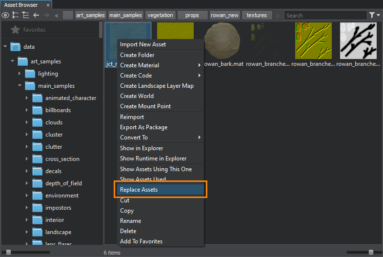

To automatically replace one asset (or a group of similar ones) with another asset of the same type while keeping all references, right-click the asset's icon and choose Replace Assets. Then select the asset that will replace this one. All related changes are made everywhere in your project automatically, with most asset types supported, including meshes, textures, materials, properties, presets, landscape layer maps, etc.要自动替换一个资源(或一组类似的资源)与另一个相同类型的资源,同时保留所有引用,右键单击资源的图标并选择 Replace Assets。然后选择将替换这个的资源。所有相关的改变都在你的项目中自动进行,支持大多数资源类型,包括网格,纹理,材质,属性,预设,景观图层地图等。
上下文菜单中的 Replace Assets 选项
This option might be very useful, for example, when you want to replace certain textures in all materials with a new texture, or when building a prototype of your scene without having the final geometry yet by placing some simple blocks (proxies) to replace them with final models when they're ready.这个选项可能会非常有用,例如,当你想用一个新的替换某些纹理在所有材质质地,或者当建立你的场景的原型还没有最终的几何通过将一些简单的块与最终模型(代理)来取代他们当他们准备好了。
