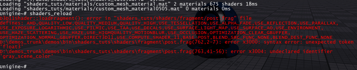

Sure. If there is a shader error, the engine shows it in the console: 当然。如果存在着色器错误,引擎会在控制台中显示该错误:
The message contains information about which file has errors and their description (including the number of line).该消息包含有关哪个文件有错误及其描述(包括行数)的信息。
Export the shader file to the file and find this code line to figure out what's happen. Shader will be exported in a file with the graphic API shader format (.hlsl) located relatively to the data folder. 将着色器文件导出到该文件,并找到此代码行以了解发生了什么。着色器将导出为相对于data文件夹具有图形API着色器格式(.hlsl)的文件。
