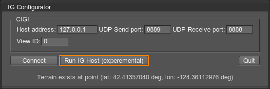

IG Host is a part of CIGI demo. Therefore, to try out IG Host, you need to download and run CIGI demo. In the IG Configurator window, click the RunIG Host button.IG Host是CIGI演示。因此,要试用IG Host,您需要下载并运行CIGI演示。在IG Configurator窗口中,单击RunIG Host按钮。
Then click Connect.然后单击Connect

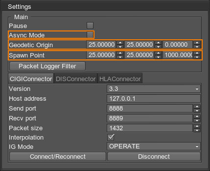

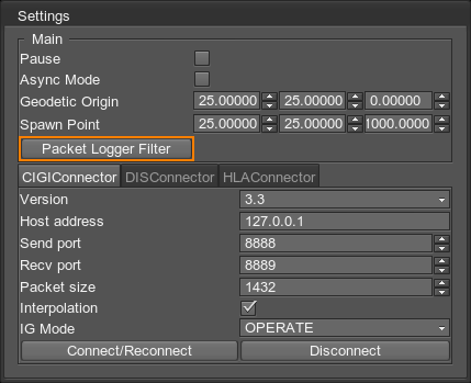

In the IG Host window, open the Settings window (File -> Settings) and set the following parameters:在IG Host窗口中,打开Settings窗口(File -> Settings)并设置以下参数:
  • Async Mode currently should be disabled.当前应禁用Async Mode
  • Geodetic Origin — the coordinates that are set for the Geodetic Pivot in the world you have created.Geodetic Origin-在您创建的世界中为Geodetic Pivot设置的坐标。
  • Spawn Point — the coordinates of the entity spawn location.Spawn Point —实体产生位置的坐标。
  • CIGIConnector settings, if necessary.CIGIConnector设置(如有必要)。

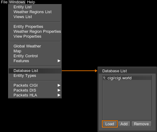

  1. Open the Database List window (Windows -> Database List).打开Database List窗口(Windows -> Database List)。
  2. Select a database from the list.从列表中选择一个数据库。
  3. Click Load.点击Load
  4. Check if the world has been loaded in the IG window. Click Connect/Reconnect in the Settings window, if necessary.在IG窗口中检查世界是否已加载。如有必要,请在Settings窗口中单击Connect/Reconnect

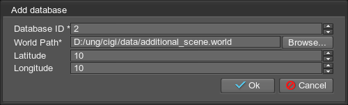

You can add more databases to the list. The databases you want to add should be located inside the /data folder of the project you work with. To add another world to the database list:您可以将更多数据库添加到列表中。您要添加的数据库应位于您使用的项目的/data文件夹内。要将另一个世界添加到数据库列表中:
  1. Click Add.点击Add
  2. Select the *.world file to be loaded.选择要加载的*.world文件。
  3. Specify the latitude and longitude of the geodetic pivot in that world.指定该世界中大地坐标的纬度和经度。
  4. Click OK.点击OK
  5. Reopen IG and IG Host.重新打开IG和IG Host

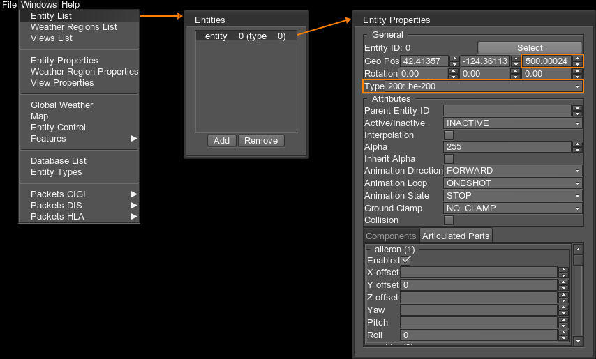

  1. Open the Entity List window (Windows -> Entity List).打开Entity List窗口(Windows -> Entity List)。
  2. Double-click an entity from the list to open Entity Properties.从列表中双击一个实体以打开Entity Properties
  3. Set the entity Type, and check its position (most importantly along the Z axis to make sure it is not under the ground).设置实体类型,并检查其位置(最重要的是沿Z轴以确保其不在地下)。
  4. Set other parameters, if necessary.如有必要,设置其他参数。

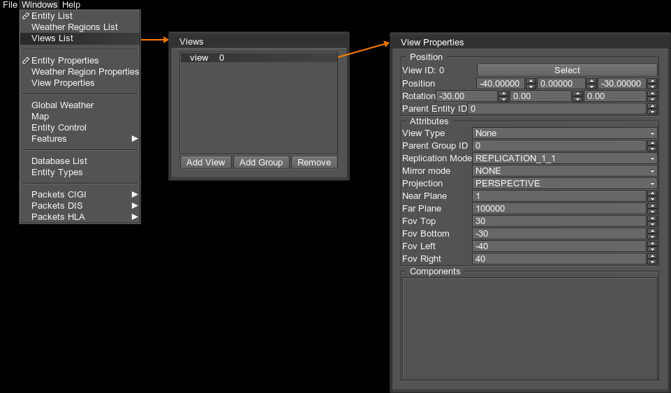

  1. Open the Views list (Windows -> Views List).打开Views列表(Windows -> Views List)。
  2. Double-click a view from the list to open its properties.从列表中双击一个视图以打开其属性。
  3. Use Position and Rotation to adjust the camera relative to the entity. Both positive and negative values can be used.使用PositionRotation相对于实体调整摄影机。正值和负值均可使用。
  4. Parent Entity ID — ID of the entity to which camera is attached. By changing this ID, you can switch between entities.Parent Entity ID —摄像机所连接的实体的ID。通过更改此ID,您可以在实体之间切换。

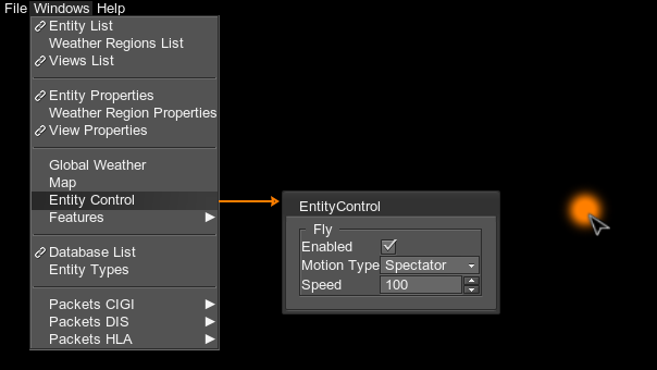

To move the entity around in IG:要在IG中移动实体,请执行以下操作:
  1. Select the entity in the Entity List.Entity List中选择实体。
  2. Open the EntityControl window (Windows -> Entity Control).打开EntityControl窗口(Windows -> Entity Control)。
  3. Activate the Enabled option.激活Enabled选项。
  4. Click in the black area within the IG Host window.单击“ IG Host”窗口中的黑色区域。
  5. Use WASDQE buttons and mouse movements to control the entity. Speed is controlled by using Shift + Mouse Scroll button.使用WASDQE按钮和鼠标移动来控制实体。使用Shift + Mouse Scroll按钮控制速度。

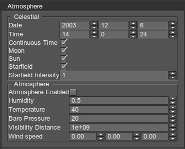

To control the weather, open the Atmosphere window (Windows -> Atmosphere):要控制天气,请打开Global Weather窗口(Windows -> Global Weather):
Currently the weather settings are the same as in HEMU.当前的天气设置与中的相同HEMU。
积雨云Cumulonimbus 1Cumulonimbus 2Cumulonimbus 3)由于其特定功能而无法通过Coverage参数进行控制-这种类型的云始终具有有限的边界并且不能是全局的。

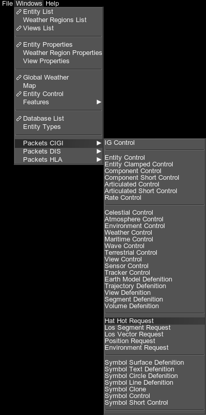

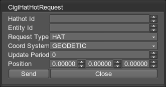

To send packets, select the type of packets you want to send:要发送数据包,请选择要发送的数据包类型:
The corresponding window will open:相应的窗口将打开:
You can open as many windows and send as many requests as you want.您可以打开任意多个窗口,并发送任意数量的请求。

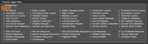

IG Host allows tracing both sent and received packets.IG Host允许跟踪已发送和已接收的数据包。
In the Settings window (File -> Settings), click the Packet Logger Filter button to open the corresponding window:Settings窗口(File -> Settings)中,单击Packet Logger Filter按钮以打开相应的窗口:
In the window that opens, enable the CIGI option and the packets that should be logged.在打开的窗口中,启用CIGI选项和应记录的数据包。
  • Packets in the top area are the packets sent from Host to IG.顶部区域中的数据包是从主机发送到IG的数据包。
  • Packets in the bottom area are the packets sent from IG to Host.底部的数据包是从IG发送到主机的数据包。
The information will be displayed in the console of the IG Host window (opened using the ` button).该信息将显示在IG Host窗口的控制台中(使用`按钮打开)。
