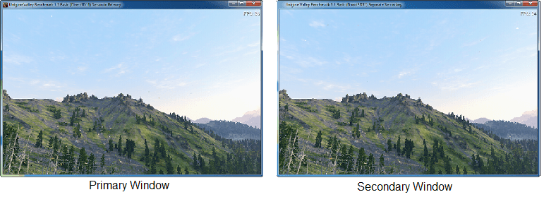

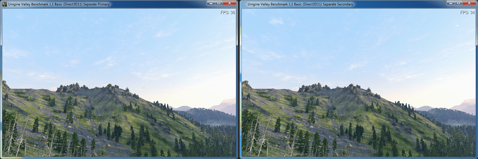

The Separate plugin is used to create a separate window for each eye. It can be used with any devices that support separate images output, e.g. for 3D video glasses or helmets (HMD)Separate插件用于为每只眼睛创建一个单独的窗口。它可以与任何支持单独图像输出的设备一起使用,例如用于3D视频眼镜或头盔(HMD)
  • The Separate plugin is available only on DirectX 11 graphics API. So it can be used under Windows only. Separate 插件仅在 DirectX 11 图形API上可用。因此只能在Windows下使用。
  • This plugin cannot be used in a Qt-based application.此插件不能在基于Qt的应用程序中使用。
Separate can be rendered in both the windowed and the full-screen mode.Separate可以在窗口模式和全屏模式下呈现。
