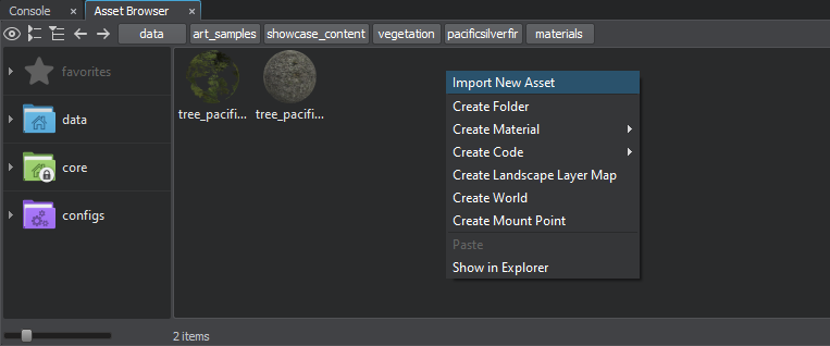

  • In the Asset Browser, go to the folder where you want to import the file(s) to, right-click and select Import New Asset in the context menu.Asset Browser中,转到要将文件导入到的文件夹,右键单击并在上下文菜单中选择 Import New Asset
    Choose a file (or several files) in the file browser window that appears. The selected files will be copied to the project folder.在出现的文件浏览器窗口中选择一个文件(或多个文件)。 选定的文件将被复制到项目文件夹中。
    如果导入单个资源,将显示一个导入设置对话框窗口(某些资源类型可用)。否则,将使用默认设置导入所有资源,以后可以根据需要进行更改。

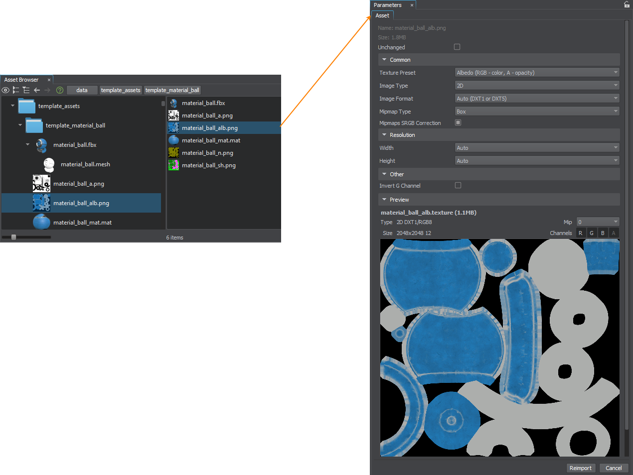

You can change import settings for a particular asset when necessary. To do so, select it in the Asset Browser, the available settings will appear in the Parameters window. The options that are displayed will vary depending on the type of the selected asset.您可以在必要时更改特定资源的导入设置。为此,请在Asset Browser中选择它,可用的设置将出现在 Parameters 窗口中。显示的选项将根据所选资源的类型而有所不同。
Here you can also specify whether an asset will be used "as is" or a runtime file will be generated for it. This option is available only for some types of assets.在这里,您还可以指定是“按原样”使用资源还是将为其生成运行时文件。此选项仅适用于某些类型的资源。
Clicking on an image asset in the Asset Browser shows the import settings in the Parameters window.在资源浏览器中单击图像资源会在Parameters窗口中显示导入设置。
After changing the import settings click Reimport to reimport the asset with new settings or click Cancel to discard your changes.更改导入设置后,单击Reimport以使用新设置重新导入资源,或单击Cancel放弃更改。
