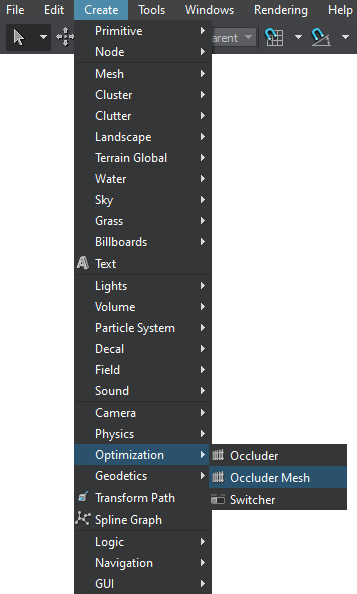

  1. Run the project with UnigineEditor.跑步UnigineEditor的项目。
  2. On the Menu bar, click Create -> Optimization -> Occluder Mesh.在菜单栏上,单击Create -> Optimization -> Occluder Mesh
  3. In the file dialog window, choose a mesh (*.mesh), on which the occluder will be based.在文件对话框窗口中,选择遮挡物将基于的网格(*.mesh)。
  4. Place the Occluder Mesh in the world and specify the required parameters for it.Occluder Mesh放置在世界上,为其指定所需的参数

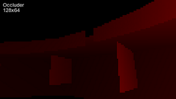

To display the buffer that is used for occluders rendered in the viewport, pass 1 to the render_show_occluder console command.显示缓冲用于在视口中渲染的遮挡物,请将1传递给render_show_occluder控制台命令。

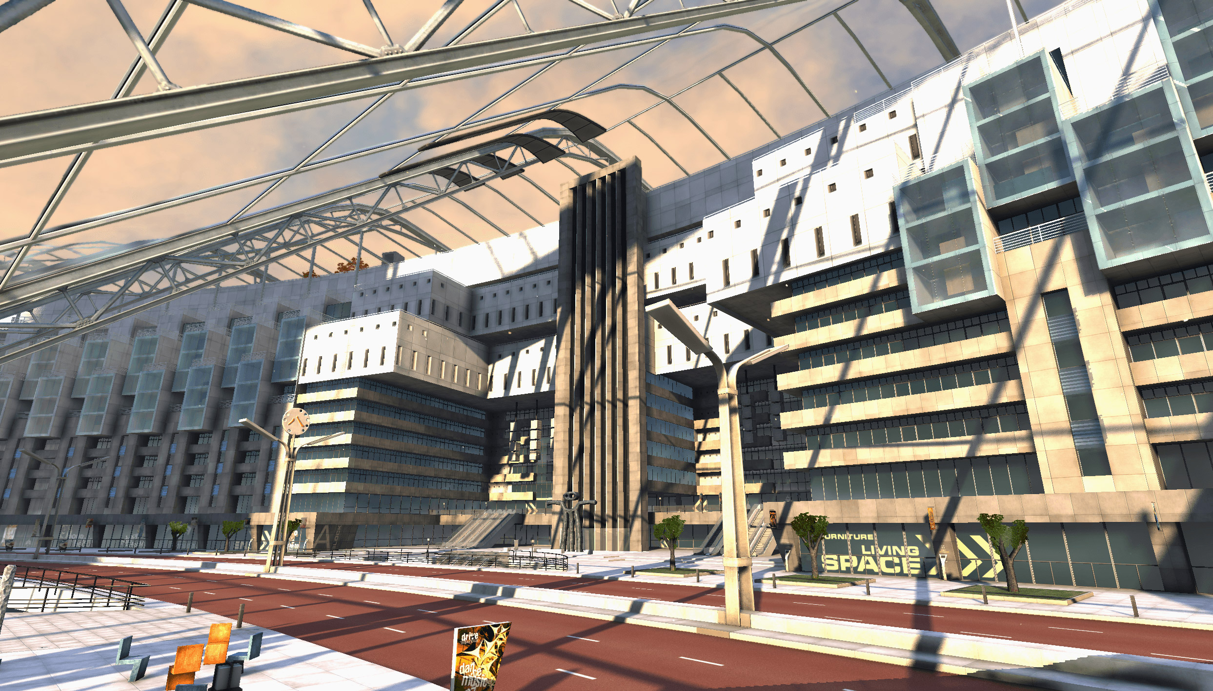

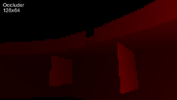

For example, if you have a building that occludes some objects' surfaces, you should prepare a simplified mesh to be used as a base for the Occluder Mesh instead of using the detailed mesh.例如,如果您的建筑物遮挡了某些对象的表面,则应准备一个简化的网格作为Occluder Mesh的基础,而不要使用详细的网格。
Mesh that represents a building and contains a lot of details代表建筑物并包含许多细节的网格
Occluder that is based on the simplified mesh and is rendered into a separate buffer with a low resolution基于简化网格的Occluder并渲染到低分辨率的单独缓冲区中

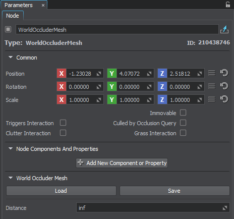

In the Node tab of the Parameters window, you can adjust the following parameters of Occluder Mesh:Parameters窗口的Node选项卡中,可以调整Occluder Mesh的以下参数:
Distance
Distance between the camera and the bounding box of the occluder, exceeding which the Occluder Mesh becomes disabled.相机与遮挡物边界框之间的距离,超过该距离将禁用Occluder Mesh
For example, you should disable the occluder at a certain distance if it stops hiding the objects and their surfaces, in order to increase performance.例如,如果阻塞器停止隐藏对象及其表面,则应在一定距离处禁用它,以提高性能。
By default, the inf value is used.默认情况下,使用inf值。
