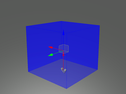

The Physical Wind is a cuboid shaped area that simulates the blowing wind inside of it. The wind velocity can gradually decrease up to box boundaries.Physical Wind是一个长方体形状的区域,模拟其中的吹风。风速可以逐渐减少直到盒子的边界。
The wind will affect only an object that meets the following requirements:风只会影响符合以下要求的物体:
  • The object's bounds must be inside the Physical Wind box.对象的边界必须在Physical Wind框内。

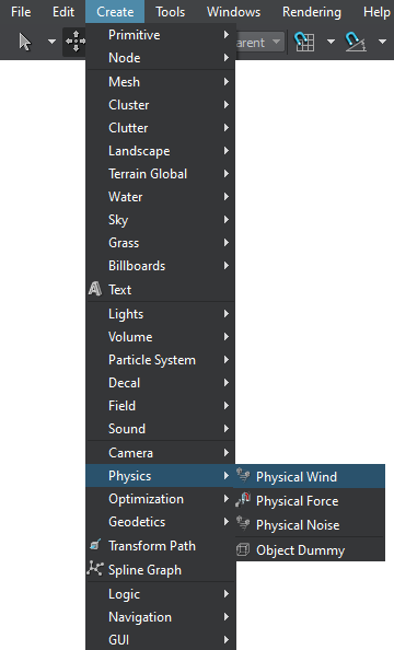

To add a Physical Wind to the scene via UnigineEditor:通过UnigineEditor将Physical Wind添加到场景中:
  1. Run the project with UnigineEditor.跑步UnigineEditor的项目。
  2. On the Menu bar, click Create -> Physics -> Physical Wind.在菜单栏上,单击Create -> Physics -> Physical Wind
  3. Click somewhere in the world to place the Physical Wind node.单击世界上的某个位置以放置Physical Wind节点。

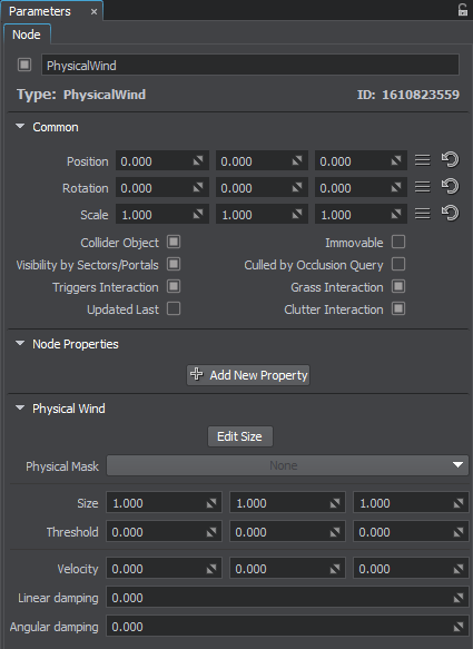

A new Physical Wind node will be added to UnigineEditor, and you will be able to edit it via the Parameters window. By default, the size of the node is 1×1×1 unit.新的Physical Wind节点将被添加到UnigineEditor,您将能够通过Parameters窗口对其进行编辑。默认情况下,节点的大小为1×1×1单位。

In the Physical Wind section (Parameters window -> Node tab), you can adjust the following parameters of the Physical Wind:Physical Wind部分(Parameters窗口→Node选项卡)中,可以调整Physical Wind的以下参数:
Edit Size
Toggles the editing mode for the Physical Wind node. When enabled, the Physical Wind box sides that can be resized are highlighted with the colored rectangles. To change the size of a side, drag the corresponding rectangle.切换Physical Wind节点的编辑模式。启用后,可以调整大小的Physical Wind框边会用彩色矩形突出显示。要更改边的大小,请拖动相应的矩形。
Physical Mask Physical mask. The physical mask of the Physical Wind must match the Physical mask of the physical object. Otherwise, the Physical Wind, inside which the wind flows with the specified velocity, won't affect the object.Physical掩码。 Physical Wind的物理掩码必须比赛物理对象的Physical掩码。否则,风以指定速度在其中流动的Physical Wind不会影响对象。
Size Size of the Physical Wind box along the axes in units.沿轴的Physical Wind框的大小(单位)。
Threshold
Threshold distance along the axes. The threshold determines the distance of gradual change from zero to full wind velocity. These values are relative to the size of the Physical Wind box. It means that the threshold values should be less than the size of the Physical Wind box.沿轴的阈值距离。该阈值确定从零到全风速逐渐变化的距离。这些值是相对于Physical Wind框的大小。这意味着阈值应小于Physical Wind框的大小。
The threshold values form an invisible box, inside which the wind blows with full velocity:阈值形成一个看不见的盒子,里面的风吹得满满的速度
Velocity Velocity of the Physical Wind flow along the axes.Physical Wind的速度沿轴流动。
Linear damping Value indicating how much the linear velocity of the objects decreases when they get inside the wind node. The higher the value is, the lower the linear velocity will be.指示对象进入风节点时其线速度降低多少的值。值越高,线速度将越低。
Angular damping
Value indicating how much the angular velocity of the objects decreases when they get inside the wind node. The higher the value is, the lower the angular velocity will be.指示对象进入风节点时其角速度减小多少的值。值越高,角速度将越低。
Angular damping parameter affects only objects with a Cloth body assigned.Angular damping参数仅影响具有布身已分配。
