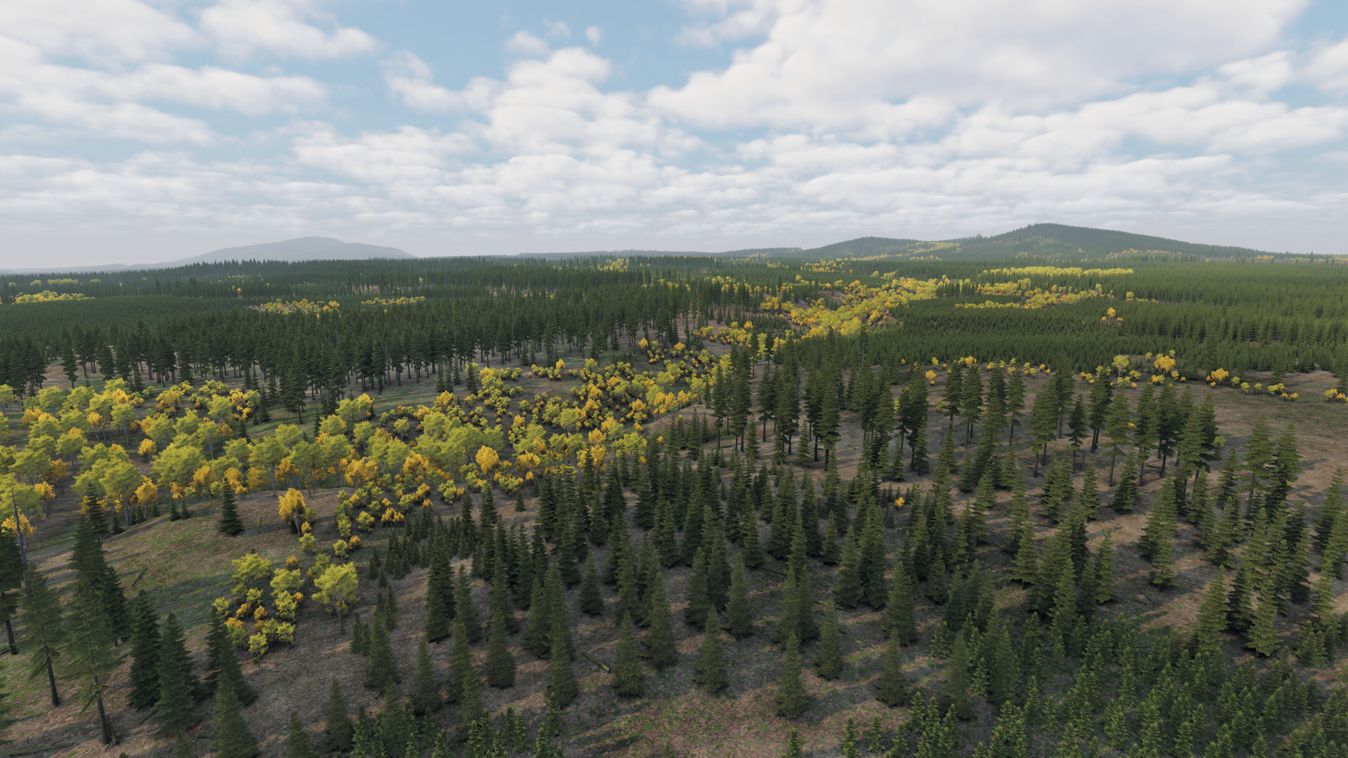

For example, you can replace the distant trees with impostors to optimize forest rendering:例如,您可以使用替身图替换远处的树木,以优化森林渲染:
Forest Optimized by Using Impostor Trees使用发布者树优化的森林

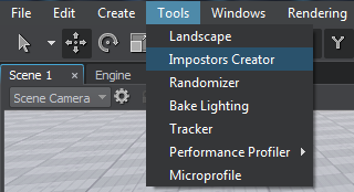

To grab impostor with the Impostors Creator tool, perform the following:要使用Impostors Creator工具抓住替身图,请执行以下操作:
  1. In the Menu Bar, choose Tools -> Impostors Creator. The Impostors Creator tool will open.
    在菜单栏中,选择Tools -> Impostors Creator。的Impostors Creator工具将打开。
