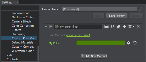

Create a new file with the *.basemat extension. Again, the file name is used as the base material name.创建一个扩展名为 *.basemat 的新文件。同样,文件名用作基础材质名称。
Describe the base material specify that it has the abstract material my_abstract as a parent:描述基础材质,指定它具有抽象材质 my_abstract 作为父级:
ULON
BaseMaterial <parent=my_abstract>
	// Add the color parameter that will define the optical filter color
	Color my_color = [0.5 0.5 0.5 1]
	// All shader variables that are defined in the material should have a prefix to be referred to in shaders
	// For sliders, colors, and other basic parameters, it is defined with var_prefix currently set as 'var'

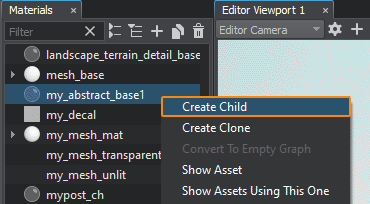

In order to test our first post-effect do the following:为了测试我们的第一个后期效果,请执行以下操作:
  • Find the my_abstract_base1.basemat in the Materials window, right-click it, choose Create Child, and rename your new material as my_color_filter.
    找到 my_abstract_base1.basematMaterials窗口,右键单击它,选择 Create Child,然后将新材质重命名为 my_color_filter.
  • As it is a post-effect, to apply the material globally we should open the Settings -> Render -> Custom Post Materials因为它是后期效果,所以要全局应用材质,我们应该打开 Settings -> Render -> Scriptable Materials
  • Click Add New Material and specify the my_color_filter material. After shis you can change the filter color.
    单击 Add New Scriptable Material 并指定 my_color_filter 材质。在 shis 之后,您可以更改过滤器颜色。

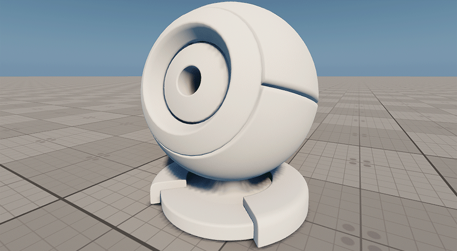

Here is the final image with our first post-material applied.这是应用了我们的第一个后期材质的最终图像。
Repeat the steps above for the my_abstract_base2.basemat base material to test the second post-effect. Here is what it may look like:my_abstract_base2.basemat 基础材质重复上述步骤以测试第二个后效。下面是它的样子:
