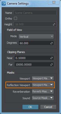

  2. Open the Camera Settings window and enable the selected bit in the Reflection Viewport mask of the camera.
    打开“摄像机设置”窗口,并启用摄像机Reflection Viewport掩码中的选定位。

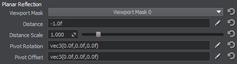

  3. In the Materials Hierarchy, select the reflective material and enable the same bit in the Reflection Viewport Mask in the Parameters tab of the Material Editor.
    在Materials_Hierarchy中,选择反射材质,然后在“材质编辑器”的Parameters选项卡的“平面反射”的Viewport Mask中启用相同的位。

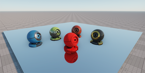

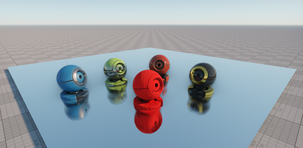

    In the picture below, the reflection viewport mask of the plane has the same matching bit (or bits) with the camera reflection viewport mask and the Viewport masks of the red material ball and its material. The viewport masks of the other material balls don't have a matching bit with the reflection camera viewport mask and/or with the planar reflection viewport mask and, therefore, they aren't reflected:In the picture below, the reflection viewport mask of the plane has the same matching bit (or bits) with the camera reflection viewport mask and the Viewport masks of the red material ball and its material. The viewport masks of the other material balls don't have a matching bit with the reflection camera viewport mask and/or with the planar reflection viewport mask and, therefore, they aren't reflected:
    Masked planar reflectionMasked planar reflection
    In the picture below, the reflection viewport mask of the plane has the same matching bit (or bits) with the camera reflection viewport mask and the Viewport masks of the red material ball and its material. The viewport masks of the other material balls don't have a matching bit with the reflection camera viewport mask and/or with the planar reflection viewport mask and, therefore, they aren't reflected:Masked planar reflection
    在“材质层次结构”中,选择应反映的节点的材质,然后在“材质编辑器”的Common选项卡的Viewport Mask中启用所选位。
    In the picture below, the reflection viewport mask of the plane has the same matching bit (or bits) with the camera reflection viewport mask and the Viewport masks of the red material ball and its material. The viewport masks of the other material balls don't have a matching bit with the reflection camera viewport mask and/or with the planar reflection viewport mask and, therefore, they aren't reflected:在下图中,平面的反射视口蒙版与相机反射视口蒙版红色实物球及其材质的视口蒙版具有相同的匹配位(或多个位)。 其他材质球的视口罩与反射相机视口罩和/或平面反射视口罩没有匹配的位,因此不会被反射:
    Masked planar reflection遮罩的平面反射

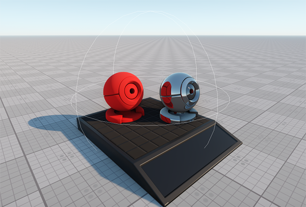

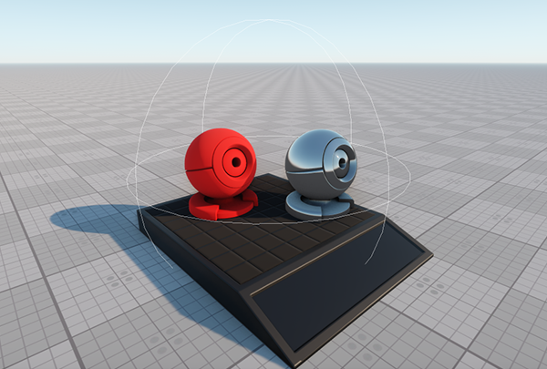

In the left picture below, the reflection viewport mask of the Environment Probe matches the camera's Reflection Viewport mask and the Viewport masks of the red material ball and its material. In the right picture, the Reflection Viewport mask of the Environment Probe doesn't match the camera's Reflection Viewport mask:在下面的左图中,Environment Probe的反射视口蒙版与摄影机的Reflection Viewport蒙版以及红色实物球及其材质的Viewport蒙版匹配。在右图中,Environment ProbeReflection Viewport遮罩与相机的Reflection Viewport遮罩不匹配:
Masked reflection provided by environment probe环境探针提供的蒙版反射

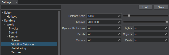

  1. In the Menu Bar, choose Windows -> Settings and go to the Visibility Distances section of the Settings window that opens.
    在菜单栏中,选择Windows -> Settings并转到打开的“设置”窗口的Visibility Distances部分。
  2. For the Dynamic Reflections parameter, specify the distance from the camera, starting from which the reflections aren't rendered.对于Dynamic Reflections参数,请指定距相机的距离,从该距离开始不渲染反射。
