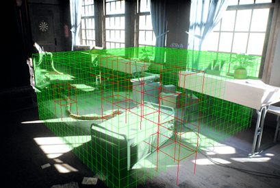

  2. Create and place voxel probes at the places where the lighting remains relatively static (e.g. interiors, outdoor buildings, and immovable objects). Select Half or Full Bake Internal Volume mode for voxel probes to illuminate dynamic objects that move within their volume.
    Place voxel probes inside other voxel probes to create insets defining the areas that require higher detail. Note that voxel probes with the additive blending mode enabled cannot be used for this purpose, as they are blended instead of replacing each other.Place voxel probes inside other voxel probes to create insets defining the areas that require higher detail. Note that voxel probes with the additive blending mode enabled cannot be used for this purpose, as they are blended instead of replacing each other.
    在灯光保持相对静止的地方(例如室内,室外建筑物和不动的物体)创建并放置体素探针。为体素探针选择 “烘焙内部体积” 模式,以照亮在其体积内移动的动态对象。( br)
    Place voxel probes inside other voxel probes to create insets defining the areas that require higher detail. Note that voxel probes with the additive blending mode enabled cannot be used for this purpose, as they are blended instead of replacing each other.将体素探针放置在其他体素探针内部,以创建定义需要更高细节的区域的插图。请注意,启用了添加剂混合模式的体素探针不能用于此目的,因为它们被混合而不是彼此替换。

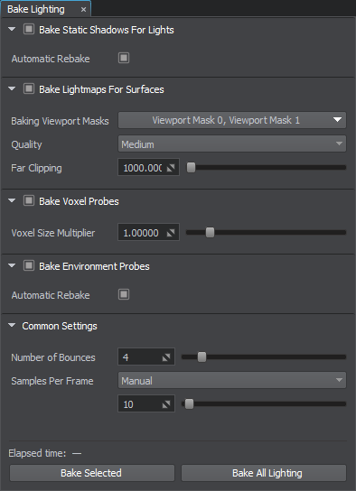

Bake Lighting Settings
烘烤照明设置#
Bake Static Shadows For Lights
Bake Static Shadows For Lights#
Bake Static Shadows For Lights Enable baking of cached shadows for static light sources.为静态光源启用缓存阴影的烘焙。
Automatic Rebake Enable auto-rebake of shadows on transforming a static light source or changing its parameters.在转换静态光源或更改其参数时启用阴影的自动重烤。

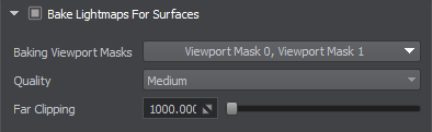

Bake Lightmaps For Surfaces
Bake Lightmaps For Surfaces#
Bake Lightmaps For Surfaces Enable baking of lightmaps for surfaces.启用表面的光照贴图的烘焙。
Baking Viewport Masks For the light or surface to contribute to static GI, their viewport masks should match the Baking Viewport Mask.为了使光线或表面有助于静态GI,其视口蒙版应与Baking Viewport Mask相匹配。
Quality Baking quality preset.烘焙质量预设。
Far Clipping Far clipping distance for light rays.光线的远剪切距离。
Bake Voxel Probes
Bake Voxel Probes#
Bake Voxel Probes Enable baking of voxel-based GI to voxel probes.启用基于体素的GI 到体素探针的烘焙。
Voxel Size Multiplier Multiplier for the Voxel Size parameter for each voxel probe.每个体素探针的Voxel Size参数的乘数。
Bake Environment Probes
Bake Environment Probes#
Bake Environment Probes Enable baking of reflection cubemaps to environment probes.启用将反射立方体贴图烘焙到环境探针的功能。
Automatic Rebake Enable auto-rebake of the cubemap of an Environment Probe on transforming it or changing its parameters.在转换Environment Probe或更改其参数时启用自动重烤
Common Settings
Common Settings#

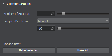

Number of Bounces Number of light ray bounces.光线反弹的次数。
Samples per Frame Number of sampling units processed and visualized simultaneously each frame (samples for lightmaps and voxels for Voxel Probes):
  • Auto - the number of samples is adjusted automatically to optimize performance of baking process.Auto - the number of samples is adjusted automatically to optimize performance of baking process.
  • Manual - the number of samples is set manually.Manual - the number of samples is set manually.
The parameter is available for changing during the baking process. Higher values cause longer user interface response but accelerate the calculations.The parameter is available for changing during the baking process. Higher values cause longer user interface response but accelerate the calculations.
Auto - the number of samples is adjusted automatically to optimize performance of baking process.Manual - the number of samples is set manually.The parameter is available for changing during the baking process. Higher values cause longer user interface response but accelerate the calculations.
每帧同时处理和可视化的采样单位数(用于光照贴图的样本和用于Voxel Probes的体素的样本):
  • Auto - the number of samples is adjusted automatically to optimize performance of baking process.Auto-自动调整样品数量以优化烘焙过程的性能。
  • Manual - the number of samples is set manually.Manual-样本数量是手动设置的。
The parameter is available for changing during the baking process. Higher values cause longer user interface response but accelerate the calculations.该参数可在烘焙过程中更改。较高的值会导致较长的用户界面响应,但会加快计算速度。
Progress Bars
进度条#
在轻度烘烤过程中显示以下进度条。
Node/Surface Progress of light baking for the current node/surface at the moment.目前,当前节点/曲面的光烘焙进度。
Bounce Progress of calculating the current bounce.计算当前反弹的进度。
Overall Overall progress of light baking for all nodes in the scene.场景中所有节点的光烘焙的总体进度。
Buttons
纽扣#
Bake Selected Starts baking for the selected static lights, probes and lightmapped surfaces regardless of whether they are enabled or not.开始烘焙选定的静态灯,探针和光照贴图表面,无论它们是否启用。
Bake/Stop Starts baking for all enabled static lights, probes and lightmapped surfaces in the scene.开始烘焙场景中所有启用了 的静态灯,探测器和光照贴图的表面。
