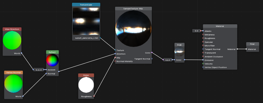

Material Editor enables you to create your own materials visually without writing a single line of code — simply create and connect nodes building a graph! It is simple enough for users who are new to materials creation and powerful enough to let you do a lot of things. A brief list of features includes:材质编辑器使您无需编写任何代码即可直观地创建自己的材质:只需创建和连接节点以构建图形!对于刚接触材质创建且功能强大的用户来说,它足够简单,可以让您做很多事情。功能的简要列表包括:
  • Ability to create your own base materials (.mgraph) and use them as directly assigned to objects or as parent materials for hundreds of other materials to avoid reassembling the material graph over and over again. The Materials hierarchy window will help you.能够创建自己的基础材质(.mgraph)并将它们直接分配给对象或用作数百种其他材质的父材质,以避免一遍又一遍地重新组装材质图。材质层次结构窗口将为您提供帮助。
  • Ability to create your own custom graph nodes using other nodes (Subgraphs), or using your code. When you change the contents of a Subgraph, all materials using it will be updated as well.能够使用其他节点创建您自己的自定义图形节点(子图),或使用您的代码。当您更改子图的内容时,所有使用它的材质也会更新。
  • Ability to switch between material types (there are five available at the moment: Mesh Opaque PBR, Mesh Alpha Test PBR, Mesh Transparent PBR, Mesh Transparent Unlit, Decal PBR).能够在材质类型之间切换(目前有五种可用:Mesh Opaque PBR, Mesh Alpha Test PBR, Mesh Transparent PBR, Mesh Transparent Unlit, Decal PBR)。
  • Optional toggling of performance-affecting features on and off.可选择打开和关闭影响性能的功能。
  • Ability to construct the final material's UI, you can add various parameters and even combine them into groups for convenience.能够构建最终材质的 UI,您可以添加各种参数,甚至可以将它们组合成组以方便使用。
  • Connector — a special 'collapsed' mode of a graph node when it occupies less space and can be attached right to an input of another graph node.Connector 是图形节点的特殊“折叠”模式,当它占用较少空间并且可以直接附加到另一个图形节点的输入时。
  • Expression — a special node enabling you to write simple arithmetic operations, but the main thing is that you can use it as a swizzle in combination with the ability to change the number of data components. Be sure you'll like it!Expression 是一个特殊的节点,使您可以编写简单的算术运算,但主要是您可以将它用作混合器,并结合更改数据组件数量的能力。确保你会喜欢它!

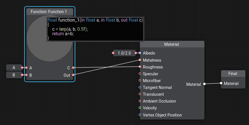

  • Ability to write code in a special Function node, here you can implement even multiple functions calling each other.有能力写代码在一个特殊的 Function 节点中,在这里你甚至可以实现多个函数相互调用。

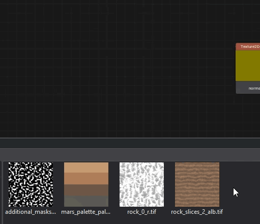

  • You can drag-n-drop textures from the Asset Browser or directly from your file manager, and they will be automatically imported with the corresponding nodes added to the graph.您可以从资源浏览器或直接从文件管理器中拖放纹理,它们将自动导入并添加到图形中的相应节点。

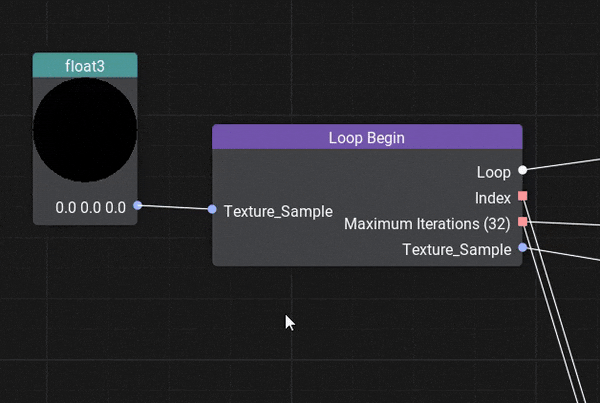

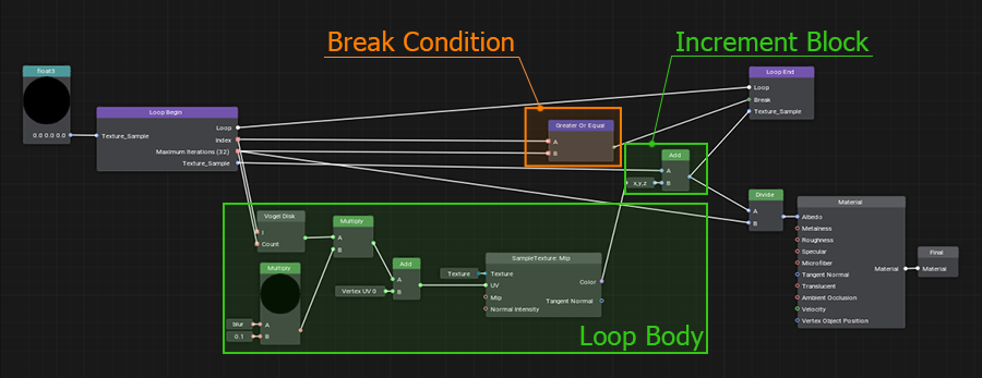

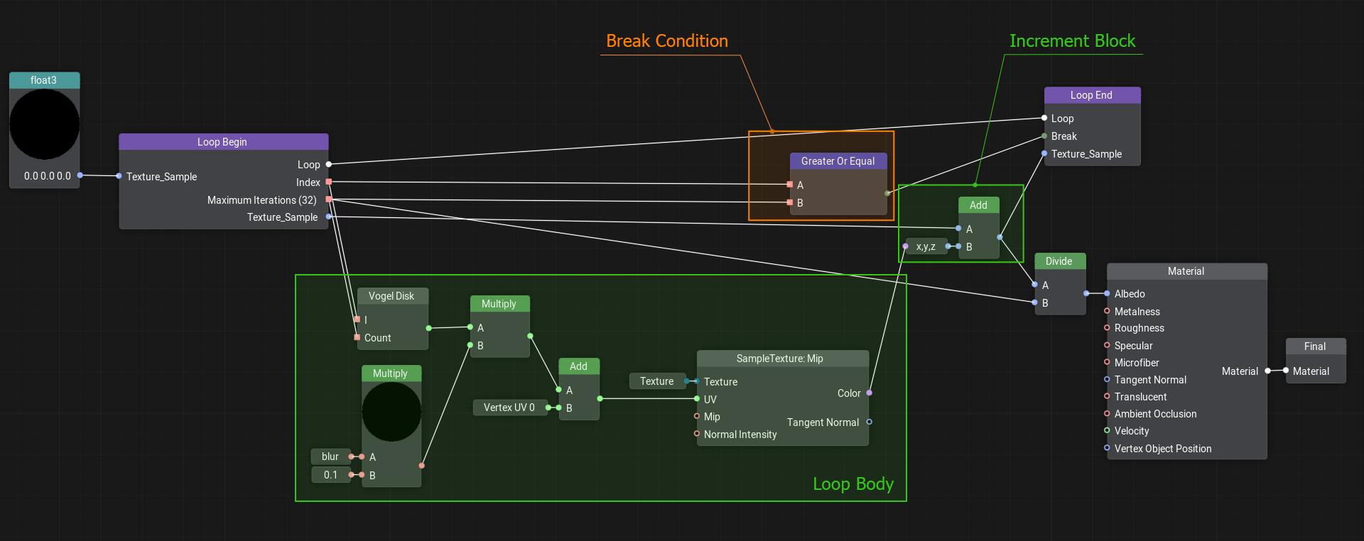

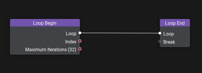

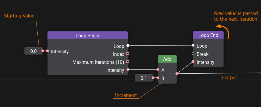

  • Loops — a complex, but very cool feature enabling you to repeat an arbitrary sequence of actions multiple times. We have analyzed multiple existing implementations of graph loops and invented a new one that is almost on par with loops in code. Why not write loops in code then? Because using a graph makes implementation of complex things inside a loop much easier than doing the same in code.循环- 一个复杂但非常酷的功能,使您可以多次重复任意顺序的动作。我们分析了图循环的多种现有实现,并发明了一种几乎与代码中的循环相当的新实现。那么为什么不在代码中编写循环呢?因为使用图使得在循环中实现复杂事物比在代码中更容易。
  • When working with complex or large graphs, you may end up with your wires are all over the place crisscrossing each other and you may want more visual clarity. That's when portals come into play. You can connect a wire to a Portal In node at one location and then place a Portal Out node at any other location you need and take what you've supplied to Portal In from a Portal Out (like you dug a tunnel for your wire under the node graph).在处理复杂或大型图表时,您可能会发现您的电线到处都是相互交叉的地方,您可能需要更清晰的视觉效果。那个时候门户参加进来。您可以将电线连接到一个位置的 Portal In 节点,然后将 Portal Out 节点放置在您需要的任何其他位置,并从 Portal Out 获取您提供给 Portal In 的内容(就像您在节点图下为电线挖了一条隧道) .

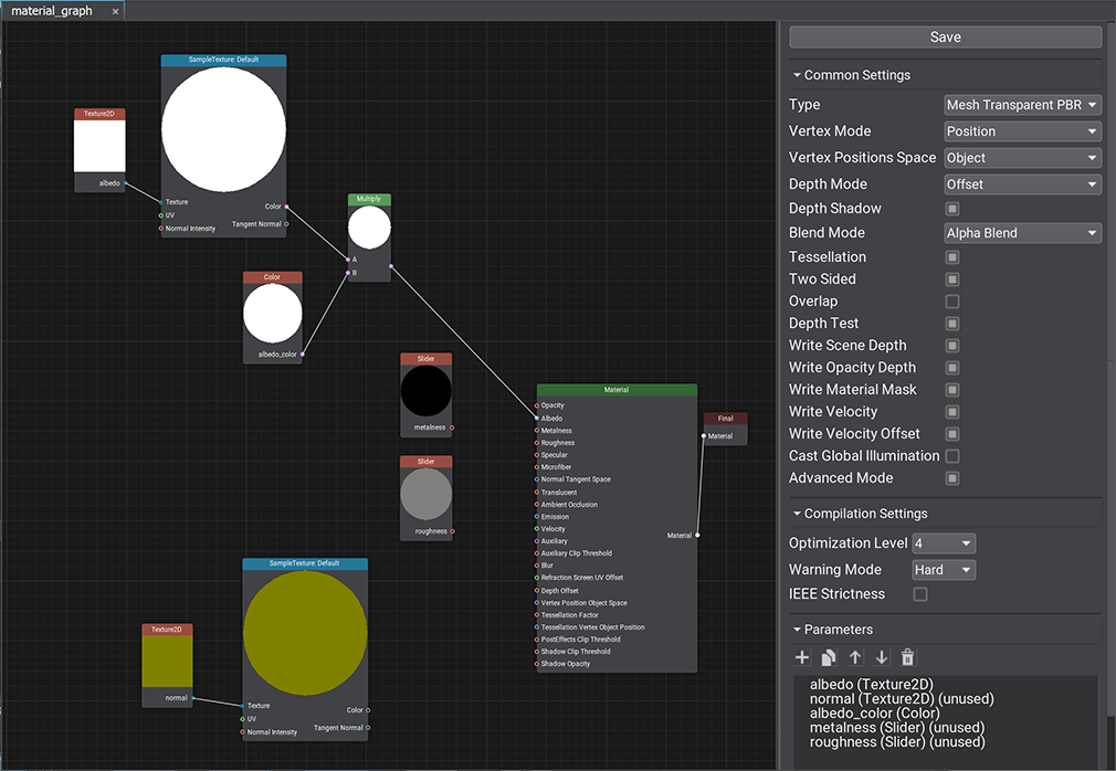

A Material Graph asset (.mgraph) is both a source material network (node-based description to be compiled into a material) and a normal base material that can be assigned to a mesh surface.材质图资源(.mgraph)既是源材质网络(要编译成材质的基于节点的描述)又是普通基材可以分配给网格表面。

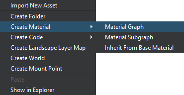

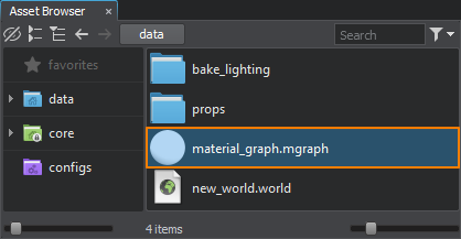

To create a new Material Graph, right-click in the Asset Browser to open the Create menu, then select Create Material -> Material Graph.要创建新的材质图,请在 Asset Browser 中单击鼠标右键以打开 Create 菜单,然后选择 Create MaterialMaterial Graph
Specify a name for your graph asset. A new *.mgraph asset will be created in the current folder of your project.为您的图形资源指定一个名称。将在项目的当前文件夹中创建一个新的 *.mgraph 资源。
As the Material Graph asset represents a base material, it is also available in the root of the Materials Hierarchy and can be assigned to supported surfaces and objects. Depending on the material's type it can be assigned to the following objects:由于 Material Graph 资源表示基础材质,因此它也可以在材质层次结构并且可以是分配到受支持的表面和对象。根据材质的类型它可以分配给以下对象:
Working with Material Graphs
使用材质图#

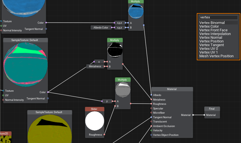

Right-click on the *.mgraph asset and choose Edit Graph or simply double-click the asset to open it in the Material Editor window.右键单击 *.mgraph 资源并选择 Edit Graph 或直接双击资源以在 Material Editor 窗口中打开它。
The Material Editor window includes the Graph View displaying the material graph network and the settings panel.Material Editor 窗口包括显示材质图网络的 Graph View 和设置面板。
The material graph network consists of nodes — functional blocks accountable for processing input data. By composing the graph network, you define the look of your material.材质图网络由节点--负责处理输入数据的功能块。通过组成图网络,您可以定义材质的外观。

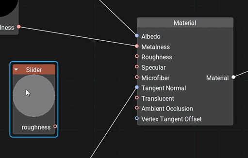

The Material node is the master node of your material. It provides a set of inputs for graphic data and generates a material of a specific type depending on the current settings.Material 节点是材质的主节点。它为图形数据提供一组输入,并根据当前的情况生成特定类型的材质设置.
Finally, the output from the Master Node is connected to the Final node — the primary output material node.最后,主节点的输出连接到 Final 节点——主要输出材质节点。
A material graph can contain several Material nodes, but only the one connected to the Final node will be used.一个材质图可以包含多个 Material 节点,但只会使用连接到 Final 节点的那个。
Press the Save button to save changes and compile the material graph to a base material. Compilation errors, if any, will be listed in the Warnings and Errors panel and in the Console window.Save 按钮保存更改并将材质图编译为基础材质。编译错误(如果有)将列在警告和错误面板和 Console 窗口中。

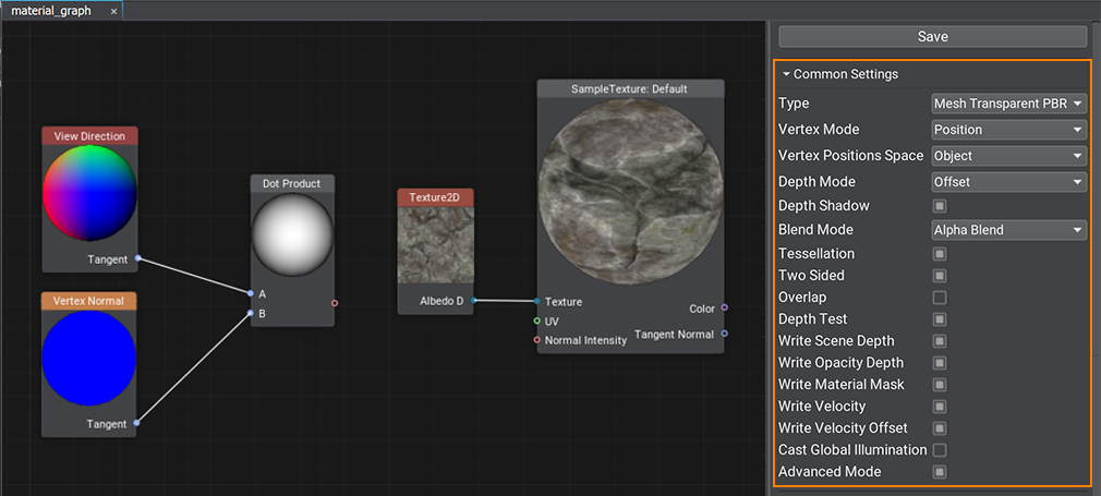

Common Settings
常用设置#
The Common Settings define the set of supported features for the material.通用设置定义了材质支持的特征集。

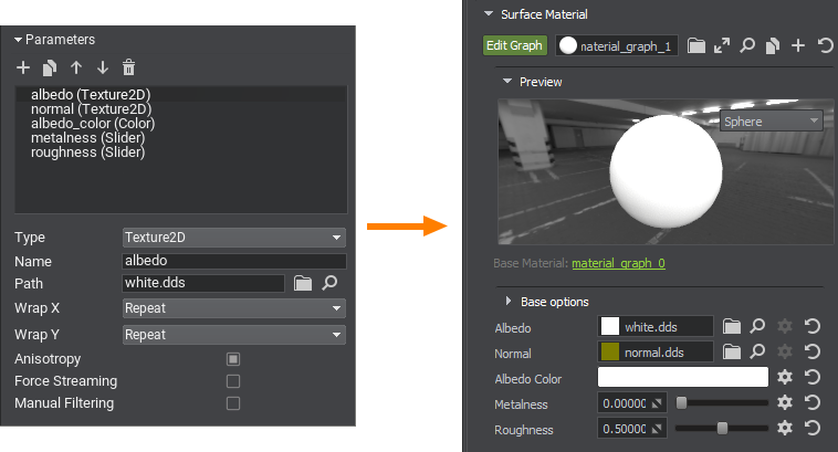

Parameters
参数#

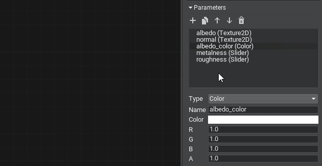

In the Parameters panel, you define the list of material parameters.Parameters 面板中,您可以定义材质参数列表。
The following controls are available:可以使用以下控件:
  • Add — add a new parameter. Add 添加一个新参数
  • Clone — clone the selected parameter. Clone 克隆所选参数
  • Move Up — move the selected parameter up in the list. Move Up 将所选参数在列表中向上移动
  • Move Down — move the selected parameter down in the list. Move Down 将所选参数在列表中向下移动
  • Remove — remove the selected parameter. Remove 删除选定的参数
When adding a new parameter, you should specify the parameter's Name, Type, and default settings in the parameter creation dialog. The following set of parameter types is provided:添加新参数时,应在参数创建对话框中指定参数的NameType和默认设置。提供了以下一组参数类型:
  • Slider — a float value within the specified range ([0.0f; 1.0f] by default).Slider--指定范围内的浮点值(默认为 [0.0f; 1.0f])。
  • Color — a float vector of 4 components representing a color value.Color--表示颜色值的 4 分量的浮点向量。
  • Texture2D, Texture3D, Texture2DArray, Texture2DInt, TextureCube — a texture of the corresponding type.Texture2D, Texture3D , Texture2DArray , TextureCube--对应类型的纹理。
  • Group — an auxiliary type for grouping parameters. Use the and buttons to rearrange and group parameters.Group--用于分组参数的辅助类型。使用 按钮重新排列和分组参数。
  • Float, Float2, Float3, Float4 — a float value or a vector of N float values.Float, Float2, Float3, Float4--浮点值或 N 浮点值的向量。
  • Int, Int2, Int3, Int4 — an integer value or a vector of N integer values.Int, Int2, Int3, Int4--整数值或 N 整数值的向量。
To use a parameter in your material graph, drag the item to the Graph View to create a node of the corresponding type:要在材质图中使用参数,请将项目拖到 Graph View 以创建相应类型的节点:

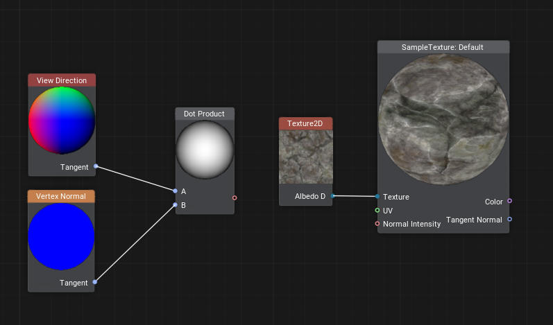

Nodes of Material Editor are functional blocks that represent data sources and processing instructions similar to variables and functions in shader programming.材质编辑器的节点是代表数据源和处理指令的功能块,类似于着色器编程中的变量和函数。
Most nodes have the output preview shown on a preview sphere (for most nodes) or a plane (for textures).大多数节点的输出预览显示在预览球体(对于大多数节点)或平面(对于纹理)上。
Some nodes have a set of settings defining their behavior. Double-clicking the node opens the dialog for adjustment of the node's settings.一些节点有一组定义它们的行为的设置。双击节点会打开用于调整节点设置的对话框。

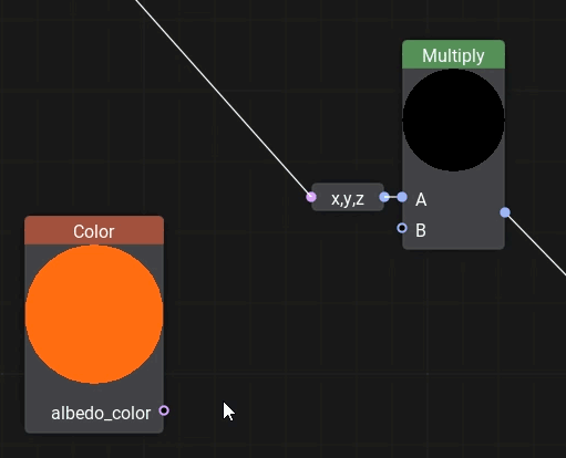

Nodes that have no more than one input and one output port have a special connector mode — they are collapsible for convenience. A collapsed node connected to another node becomes attached to it. Drag the collapsed node to break the connection and detach the node.不超过一个输入和一个输出的节点端口有一个特殊的连接器模式——为了方便,它们是可折叠的。连接到另一个节点的折叠节点将附加到它。拖动折叠的节点以断开连接并分离节点。
Nodes are split into several groups based on their applicability and color-coded for better identification.节点分为几组基于它们的适用性和颜色编码以便更好地识别。

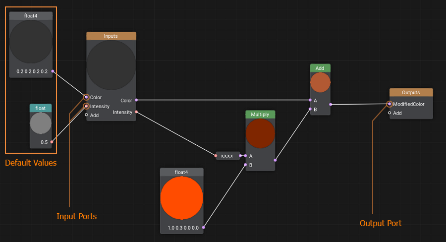

Port
端口#
A port defines an input (left side) or output (right side) of a node. Connecting edges to a port allows data to flow through the Material Graph node network.端口定义节点的输入(左侧)或输出(右侧)。连接边缘到端口允许数据流过 Material Graph 节点网络。
Each port has a data type defining edges that can be connected to it. All data types are color-coded, meaning that each of them has an associated color used for identification.每个端口都有一个数据类型,定义了可以连接到它的边缘。所有数据类型都用颜色编码,这意味着它们中的每一个都有用于识别的关联颜色。
float float float2 float2 float3 float3 float4 float4
int int int2 int2 int3 int3 int4 int4
matrix — a matrix of float values: float2×2, float3×3, float4×4. matrix--浮点值矩阵: float2×2float3×3float4×4
texture — any type of a texture: Texture 2D, Texture 3D, Texture 2D Array, Texture 2D Int and Texture Cube. 纹理--任何类型的纹理:Texture 2DTexture 3D Texture2DArrayTexture Cube.
bool — a boolean value used in logical nodes and loops. bool--使用的布尔值逻辑节点循环.
any — arbitrary data type meaning the port supports several data types. any--任意数据类型,表示端口支持多种数据类型。
error — indicates an error (e.g., no required input provided or type conversion has failed). error--表示错误(例如,未提供必需的输入或类型转换失败)。
Only one edge can be connected to any input port, but you can connect multiple edges to an output port.只有一个边缘可以连接到任何输入端口,但您可以将多个边缘连接到一个输出端口。
Most input ports have a default input value.大多数输入端口都有一个默认输入值

  • Selecting another option creates an Expression node accountable for type conversion.选择另一个选项会创建一个负责类型转换的 Expression 节点。
You can change the adapter later by double-clicking the expression and editing the field. The Expression node enables you to write simple arithmetic operations and even use the Unigine Graphic API.您可以稍后通过双击表达式并编辑字段来更改适配器。 Expression 节点使您能够编写简单的算术运算,甚至可以使用 Unigine 图形 API。

In order to add a new node, right-click on the background or press Space and select a node type from the palette or type its name in the Search field to find it.要添加新节点,请右键单击背景或按空格键并从调色板中选择节点类型或在 Search 字段中键入其名称以找到它。
Dragging an edge from an input port opens a node creation palette with a pre-set filter to the required data type for the corresponding port.拖动一个边缘从输入端口打开一个节点创建调色板使用针对相应端口所需数据类型的预设过滤器。
Textures can be dragged directly from the Asset Browser. In this case, a Sample Texture node with corresponding settings will be added automatically.可以直接从资源浏览器中拖动纹理。在这种情况下,将自动添加一个具有相应设置的 Sample Texture 节点。

To create a loop, add the Loop Begin and Loop End nodes and connect their Loop ports.要创建循环,请添加 Loop BeginLoop End 节点并连接它们的 Loop 端口。
By double-clicking the Loop Begin node, you can open the Input Constructor enabling you to add, rearrange, rename, delete inputs (changing variables or other auxiliary values) and implicitly set their type as well as set the maximum number of iterations.通过双击 Loop Begin 节点,您可以打开 Input Constructor,使您能够重新排列、重命名、删除现有输入并隐式设置它们的类型以及设置最大迭代次数
Then, build a graph implementing the functionality of a single iteration, the result of which should be passed to the Loop End node for further iterations. You can use the result of all iterations further in your graph.然后,构建一个实现单次迭代功能的图,其结果应传递给 Loop End 节点以进行进一步的迭代。您可以在图表中进一步使用所有迭代的结果。
You can use the Index of the current iteration and the Maximum Iterations values in your logic. The Index starts with 0 and is equal to Maximum Iterations-1 at the last iteration.您可以在逻辑中使用当前迭代的 IndexMaximum Iterations 值。 Index0 开始,在最后一次迭代中等于 Maximum Iterations-1
Here's an example of a simple loop, incrementing a value by 0.1 10 times:这是一个简单循环的示例,将值增加 0.1 10 次:
The Loop End node has the break input port that takes a boolean value, false by default. Passing a truth value (e.g., obtained via Logical Nodes) will interrupt the loop and exit the current iteration.Loop End 节点的 break 输入端口采用布尔值,默认为 false。传递一个真值(例如,通过逻辑节点)将中断循环并退出当前迭代。
Custom Code
自定义代码#
No matter how advanced the materials system is, you might want something specific, maybe too complicated to implement via basic nodes. Or sometimes, it might be quicker to write several lines of code for mathematical operations instead of spawning a bunch of nodes and connecting them. The solution is simple — create a Function node and wrap any shader function into it. Input and output ports for the node shall be automatically generated according to the function's signature.无论材质系统多么先进,您都可能需要一些特定的东西,可能过于复杂而无法通过基本节点实现。或者有时,为数学运算编写几行代码可能会更快,而不是生成一堆节点并将它们连接起来。解决方案很简单:创建一个Function节点并将任何着色器函数包装到其中。输入输出 端口节点应根据函数的签名自动生成。
To add or edit code to the node double-click on the node, the Code Editor window will open. You can write as many functions as you need, the last function in the code will be considered the main one.要向节点添加或编辑代码,请双击节点,代码编辑器窗口将打开。您可以编写任意数量的函数,代码中的最后一个函数将被视为主要函数。

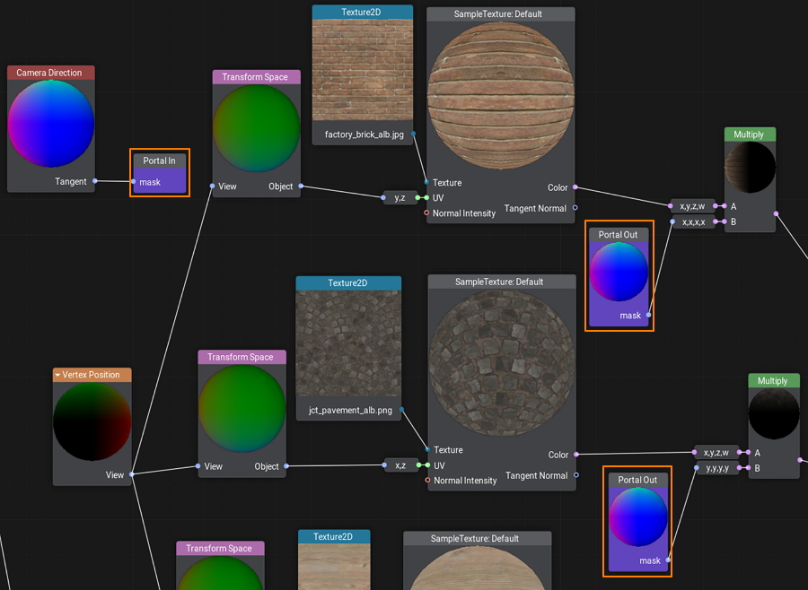

Portals
门户网站#
Sometimes, especially in complex material graphs, there are too many crisscrossing edges making the whole graph look like a spiderweb, and the data flow very hard to understand. A portal is a set of special nodes including a single input and one or more outputs, all having the same name. Portals serve to reduce the number of edges and make the graph more 'readable'.有时,特别是在复杂的材质图中,有太多的交叉边缘使整个图看起来像蜘蛛网,数据流非常难以理解。门户是一组特殊节点,包括单个输入和一个或多个输出,它们都具有相同的名称。门户用于减少边缘的数量并使图形更具“可读性”。
To create a portal, start with adding a Portal In node. Connect an input to the new node and double-click on it to adjust its color and name.要创建一个门户,首先要添加一个 Portal In 节点。将输入连接到新节点并双击它以调整其颜色和名称。
And then you can create as many Portal Out nodes as you need. By double-clicking on a Portal Out node you can select the name of the desired input portal in case several portals are used.然后您可以根据需要创建任意数量的 Portal Out 节点。通过双击 Portal Out 节点,您可以选择所需输入门户的名称,以防使用多个门户。

To create a new Subgraph, right-click in the Asset Browser to open the Create menu, then select Create Material -> Material Graph.要创建新的子图,请在资源浏览器中右键单击以打开 Create 菜单,然后选择 Create Material -> Material Graph
Click Save to apply and save changes.单击 Save 应用并保存更改。

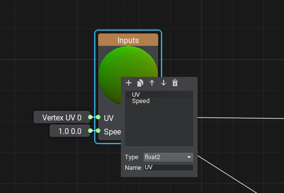

Configuring Inputs and Outputs
配置输入和输出#
Double click on the Inputs node or the Outputs node to open the constructor panel enabling you to add, rearrange, delete and set the name and type of input and output ports of the subgraph correspondingly.双击 Inputs 节点或 Outputs 节点打开构造器面板,可以对子图进行相应的添加、重新排列、删除以及输入输出端口的名称和类型的设置。
By connecting nodes to the ports of the Inputs node, you specify the optional ports of the subgraph having default values.通过将节点连接到 Inputs 节点的端口,您可以指定具有默认值的子图的可选端口。
