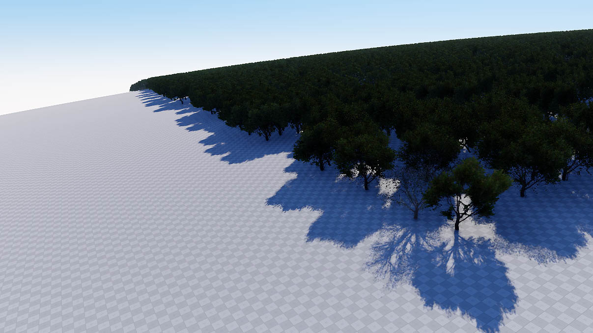

Geodetic Pivot helps to place world objects on their real world positions (latitude, longitude and altitude) by curving a plane with objects on it. Pivot converts real geodetic data to Cartesian and simultaneously "curves" objects to simulate the contorted Earth's surface.Geodetic Pivot通过弯曲带有对象的平面来帮助将世界对象放置到它们的真实世界位置(纬度、经度和海拔高度)。Pivot将真实的大地测量数据转换为笛卡尔坐标,并同时“弯曲”物体,以模拟扭曲的地球表面。

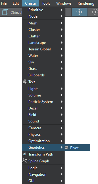

To add a Geodetic Pivot to the scene via UnigineEditor do the following:通过UnigineEditor将一个Geodetic Pivot添加到场景中,步骤如下:
  1. Run the project with UnigineEditor.使用UnigineEditor运行项目。
  2. On the Menu bar, click Create -> Geodetics -> Pivot.在菜单栏上,单击Create -> Geodetics -> Pivot
  3. Place the Geodetic Pivot somewhere in the world.Geodetic Pivot放在世界的某个地方。

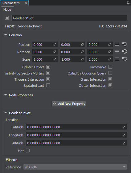

After adding the Geodetic Pivot on the scene, set up the parameters located in the Geodetic Pivot section (Parameters window -> Node tab).在场景中添加Geodetic Pivot后,设置位于Geodetic Pivot部分的参数(Parameters窗口→Node选项卡)。
  • Location settings. The geodetic location on the Earth of the pivot point. It is specified by 3 components:位置设置. 枢轴点在地球上的大地测量位置。 它由 3 个组件指定:
    • Latitude is the north–south position in degrees of a point on the Earth's surface. For example, Tomsk city latitude is 56.4977100. 0 value means equator, 90 value means the North Pole, -90 means the South Pole.Latitude - 是地球表面某一点南北方向的位置。例如,托木斯克的城市纬度是56.49771000值表示赤道,90值表示北极,-90值表示南极。
    • Longitude is the east-west position in degrees of a point on the Earth's surface. For example, Tomsk city longitude is 84.9743700. 0 value means a prime meridian (Greenwich). This field supports two ranges: from -180 to 180 and from 0 to 360.Longitude - 是地球表面某一点东西方向的位置,以度数表示。例如,托木斯克城市经度为84.97437000值表示本初子午线(格林尼治)。该字段支持两个范围:-180 ~ 1800 ~ 360
    • Altitude is the height above sea level of a location. For example, Tomsk city altitude is 117 meters.Altitude - 是某一地点的海拔高度。例如,托木斯克市的海拔是117米。
    • Flat geopositioning mode of the Geodetic Pivot. This mode should be used, when it is necessary only to set node positions via geo coordinates (latitude, longitude, altitude) without curving the terrain, clouds, etc.Geodetic PivotFlat 定位模式。 当只需要通过地理坐标(纬度、经度、高度)设置节点位置,而不需要弯曲地形、云层等时,应该使用这种模式。
  • Ellipsoid settings.椭球体的设置.
    • Reference is a mathematically defined ellipsoid that approximates the surface of the planet. We offer popular geocentric reference ellipsoids: WGS84, GRS80, Airy 1830, etc.Reference是一个数学定义的椭球体,近似于行星表面。我们提供流行的地心参考椭球:WGS84, GRS80, Airy 1830等等。

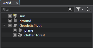

After adding and setting up the Geodetic Pivot, you can simply add objects to "curve" them:在添加和设置Geodetic Pivot之后,你可以简单地添加对象来“弯曲”它们:
  1. Choose the necessary nodes (Static Mesh, Grass, Clutter, etc.) in the Nodes window and set them as children of the Geodetic Pivot.Nodes窗口中选择必要的节点(Static Mesh, Grass, Clutter等),并将它们设置为Geodetic Pivot的子节点。
  2. Specify the necessary settings of the Geodetic Pivot.指定必要的设置Geodetic Pivot
  3. The update will be performed automatically.更新将自动执行。

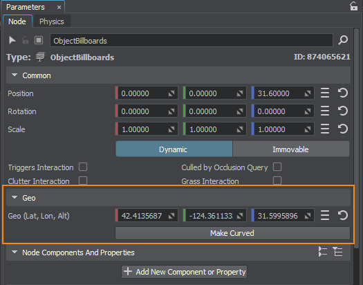

As you add a node as a child to the Geodetic Pivot, its geo position coordinates (latitude, longitude, and altitude) are displayed in the Geo section of the Node tab:当你将一个节点作为子节点添加到Geodetic Pivot时,它的地理位置坐标(纬度、经度和海拔高度)将显示在Node选项卡的Common部分:
Geo Position Specifies the geo position coordinates for the node (latitude, longitude, and altitude).指定节点的地理位置坐标(纬度、经度和高度)。

As for Static Meshes, Mesh Decals, and Billboards, sometimes you might just want to set their positions in real world coordinates an leave their geometry as is, but in some cases they should be curved (e.g., large static meshes, or roads represented as mesh decals). For this purpose you should use the following button:至于Static Meshes, Mesh Decals, and Billboards,有时你可能只是想设置头寸在现实世界坐标离开他们的几何,但在某些情况下,他们应该是弯曲的道路(如大型静态网格,或表示为网状图案)。为此,您应该使用以下按钮:
Make Curved Curves the geometry of the object according to the specified settings. A curved clone of the initial node is created, the initial node (using a non-curved mesh) is simply disabled, so you can use it when you need to return geometry back to normal (uncurved) state.根据指定的设置将对象的几何形状弯曲。创建初始节点的曲面克隆,初始节点(使用非曲面网格)被简单地禁用,所以当您需要将几何图形返回到正常(非曲面)状态时,可以使用它。
The button described above is available only for Static Mesh, Mesh Decal, and Billboards objects, when they are added as children to the Geodetic Pivot.上面描述的按钮仅对Static Mesh, Mesh DecalBillboards对象可用,当它们作为子对象添加到Geodetic Pivot时。
