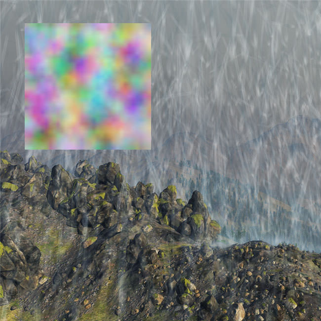

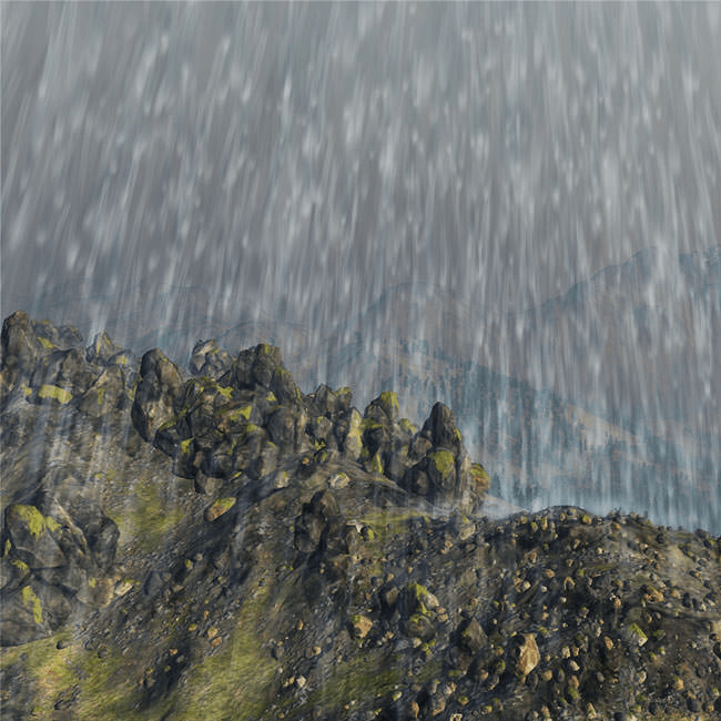

For example, if you add the physical noise for particles, you can get the following:例如,如果添加粒子的物理噪声,则可以获得以下信息:
Noise is disabled噪音被禁用
Noise is enabled. A colored square is a noise image texture启用噪音。彩色正方形是噪声图像纹理
The Physical Noise will affect particles only if their physical mass is nonzero. The physical mass for the particles can be set on the Particles tab of the Parameters window.仅当粒子的物理质量不为零时,Physical Noise才会影响粒子。这物质质量可以在Parameters窗口的Particles选项卡上设置粒子。

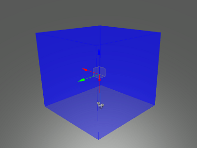

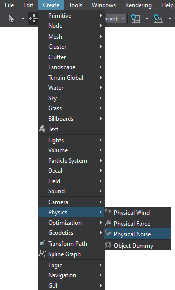

To add a Physical Noise to the scene via UnigineEditor:通过UnigineEditor将Physical Noise添加到场景中:
  1. Run the project with UnigineEditor.跑步UnigineEditor的项目。
  2. On the Menu bar, click Create -> Physics -> Physical Noise.在菜单栏上,单击创建→物理→物理噪声
  3. Click somewhere in the world to place the Physical Noise.单击世界上的某个地方以放置Physical Noise
A new Physical Noise node will be added to UnigineEditor, and you will be able to edit it via the Parameters window.新的Physical Noise节点将被添加到UnigineEditor,您将能够通过Parameters窗口对其进行编辑。

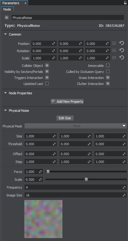

In the Physical Noise section (Parameters window -> Node tab), you can adjust parameters of the Physical Noise.Physical Noise部分(Parameters窗口→Node选项卡)中,可以调整Physical Noise的参数。
To have a more clear understanding how the following parameters affect the resulting force inside the Physical Noise node, see Main Concepts.要更清楚地了解以下参数如何影响Physical Noise节点内的合力,请参见主要概念
Node Parameters
节点参数#
The following parameters are used to set conditions of the size of the Physical Noise node.以下参数用于设置Physical Noise节点大小的条件。

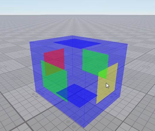

Edit Size
Toggles the editing mode for the Physical Noise node. When enabled, the Physical Noise box sides that can be resized are highlighted with the colored rectangles. To change the size of a side, drag the corresponding rectangle.切换Physical Noise节点的编辑模式。启用后,可以调整大小的Physical Noise框边会用彩色矩形突出显示。要更改边的大小,请拖动相应的矩形。
Physical Mask Physical mask. The physical mask of the Physical Noise must match the Physical mask of the physical object. Otherwise, the physical noise won't affect the object.Physical掩码。 Physical Noise的物理掩码必须比赛物理对象的Physical掩码。否则,物理噪声将不会影响对象。
Size Size of the Physical Noise box along the axes in units.沿轴的Physical Noise框的大小(单位)。
Threshold
Threshold distance along the axes. The threshold determines the distance of gradual change from zero to full force value. These values are relative to the size of the Physical Noise box. It means that the threshold values should be less than the size of the Physical Noise box.沿轴的阈值距离。阈值确定从零到全力值的逐渐变化的距离。这些值是相对于Physical Noise框的大小。这意味着阈值应小于Physical Noise框的大小。
Texture Sampling Parameters
纹理采样参数#
The following parameters are used for pixel sampling from the generated noise texture.以下参数用于从生成的噪声纹理进行像素采样。
You can animate a force field in run-time by changing these parameters.通过更改这些参数,可以在运行时为力场设置动画。
Offset Sampling offset along the axes.沿轴的采样偏移量。
Step Size of the sampling step along the axes.沿轴的采样步长。
Force Multiplier
力乘数#
Force Force multiplier. The higher the value is, the higher the value of the resulting force that affects an object inside the Physical Noise node will be.力乘数。值越高,影响Physical Noise节点内部对象的合力值就越大。
