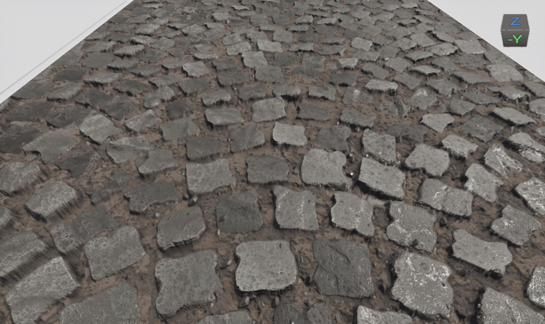

Creating A Cobblestone Pathway
  1. Create a new Material Graph and ensure it is assigned to your mesh.
  2. Add a Parallax Occlusion Mapping node, connect a Heightmap Texture to the Heightmap Texture 2D input of the Parallax Occlusion Mapping node.
  3. Add three Slider nodes and connect them to the Parallax Occlusion Mapping node:
    • Parallax Intensity
    • Max Layers
    • Min Layers
    Adjust the UV Aspect, UV Tiling, and UV Offset if needed, to align the effect properly with the mesh.
  4. Add a Texture2D node and connect it to a Sample Texture node.
  5. Connect the Displaced UV output of the Parallax Occlusion Mapping node to the UV input of the Sample Texture node.
  6. Repeat this process for the Normal Map.
By following these steps, you will have a cobblestone material creating a convincing illusion of depth. This setup avoids costly geometry detailing while still achieving a highly detailed surface.

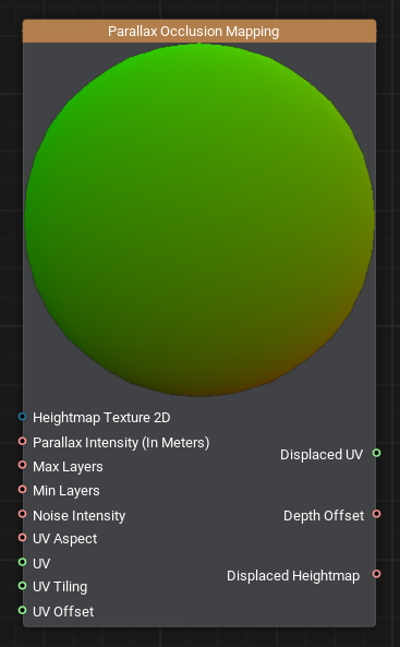

Ports
Name Description
Heightmap Texture 2DHeightmap texture, where R channel stores concavity values. Black - maximum concavity, white - maximum convexity (no parallax effect is applied).
Parallax IntensityDefines the depth of the parallax effect (in meters). The displacement of the surface is determined by the heightmap's texel values - black areas (value 0) apply the full displacement, while brighter texels (approaching white) gradually reduce the effect.
Max LayersSets the number of parallax layers, when we look at the surface at a steep angle. Higher values increase quality but reduce performance.
Min LayersSets the number of parallax layers, when we look at the surface orthogonally. Higher values increase quality but reduce performance.
Noise IntensityControls noise intensity to blend parallax layers smoothly, reducing stair-step artifacts (terrace effect).
UV AspectMaintains the correct texture aspect ratio. Should be equal to 1, for a square texture.
UVUV to which the parallax effect is applied.
UV TilingTiling of the texture. Controls the repetition scale of the texture across the surface.
UV OffsetOffset for UV coordinates. Adjusts the starting point of the texture on the surface.
Displaced UVParallaxed UVs for textures. The modified UV coordinates after applying the parallax effect.
Depth OffsetProvides the offset (displacement) depth value.
Displaced HeightmapHeightmap value displaced because of parallax effect.
