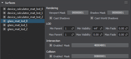

Visual representation of nodes can be changed by adjusting parameters of its surfaces on the Node tab of the Parameters window.可以通过在Parameters窗口的Node选项卡上调整其 surfaces 的参数来更改节点的视觉表示。
Only nodes of the object-related types can have surfaces.与对象相关的类型的节点可以具有曲面。
Surfaces are organized in a hierarchy that displayed in the following section:曲面按以下部分中显示的层次结构进行组织:
Surfaces HierarchyFiltering Surfaces表面层次结构
To change the surface parameters, select the required surface in the hierarchy and tweak its parameters. For each surface, the parameters listed below are available for editing.要更改表面参数,请在层次结构中选择所需的表面并对其参数进行调整。对于每个表面,下面列出的参数均可编辑。

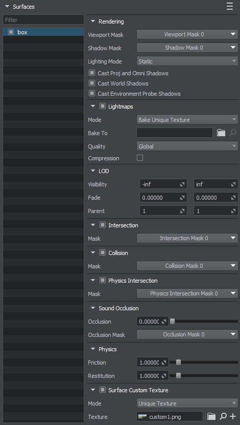

Rendering Parameters
渲染参数#
Rendering Settings渲染设置
This section provides parameters for setting up rendering of the surface and its shadows.本节提供用于设置表面及其阴影渲染的参数。
Viewport Mask Viewport mask of the surface.表面的Viewport遮罩。
Shadow Mask Shadow mask of the surface.表面的Shadow遮罩。
Shadow Mode Considering the concept of static and dynamic light, a surface can cast static (using precomputed shadow texture) or dynamic (geometry-based) shadow depending on the light source mode. Two shadow modes are available:
  • Static. The surface casts both types of shadows: cached (from static lights) and dynamic (from dynamic lights).
    In this mode, the Min Visibility parameter of a surface should not be greater than 0. Otherwise, a shadow from a static light source wouldn't be baked.In this mode, the Min Visibility parameter of a surface should not be greater than 0. Otherwise, a shadow from a static light source wouldn't be baked.
  • Dynamic. The surface casts shadow only if lit by a dynamic light or a static light with Mixed shadow mode. No shadows are baked.Dynamic. The surface casts shadow only if lit by a dynamic light or a static light with Mixed shadow mode. No shadows are baked.
In this mode, the Min Visibility parameter of a surface should not be greater than 0. Otherwise, a shadow from a static light source wouldn't be baked.Dynamic. The surface casts shadow only if lit by a dynamic light or a static light with Mixed shadow mode. No shadows are baked.
考虑到静态和动态光的概念,根据光源模式,表面可以投射静态(烘焙)或动态(基于几何)的阴影。有两种阴影模式可用:
    Static。曲面会投射两种类型的阴影:缓存的阴影(来自静态光源)和动态的阴影(来自 dynamic 光源)。
    In this mode, the Min Visibility parameter of a surface should not be greater than 0. Otherwise, a shadow from a static light source wouldn't be baked.在此模式下,曲面的Min Visibility参数不应大于0。否则,将不会烘焙来自静态光源的阴影。
  • Dynamic. The surface casts shadow only if lit by a dynamic light or a static light with Mixed shadow mode. No shadows are baked.Dynamic。只有当被动态光或具有 Mixed 阴影模式的静态光照射时,表面才会产生阴影。没有阴影被烘烤。
Cast Proj and Omni Shadows Flag indicating if the surface casts shadows from projected and omni light sources.指示表面是否从projectedomni光源投射阴影的标志。
Cast World Shadows Flag indicating if the surface casts shadows from world light sources.指示表面是否从world光源投射阴影的标志。
Cast Global Illumination Flag indicating if the surface is to be baked to static GI.指示是否将表面烘焙到静态GI .的标志
Bake to Environment Probes Flag indicating if the surface is to be baked to environment probes.指示是否将表面烘焙到environment probes.的标志
Cast Environment Probe Shadows Flag indicating if the surface casts shadows from environment probes. This option is required for the Cutout by Shadow feature.指示表面是否从environment probes投射阴影的标志。 Cutout by Shadow功能需要此选项。
Lightmaps Parameters
光照贴图参数#
Lightmaps Settings光照贴图设置
Lightmap Parameters are available only for surfaces of Static Mesh objects in the Static or Advanced Lighting Mode.光照贴图参数仅可用于静态网格物体对象的曲面。
This section provides lightmapping-related parameters for the surface.本节提供了与表面有关的光照映射相关参数。
Enabled Flag indicating if lightmapping and related parameters are enabled for the surface.指示是否为曲面启用了光照贴图和相关参数的标志。
Mode Option indicating the lightmapping mode for the surface:
  • Bake Unique Texture — bake lighting into a new texture.Bake Unique Texture — bake lighting into a new texture.
  • Use Custom Texture — specify a lightmap texture from assets.Use Custom Texture — specify a lightmap texture from assets.
  • Reuse Texture From Other Surface — use the lightmap texture from another surface. This option is intended for use with LODs having the same UV maps.Reuse Texture From Other Surface — use the lightmap texture from another surface. This option is intended for use with LODs having the same UV maps.
Bake Unique Texture — bake lighting into a new texture.Use Custom Texture — specify a lightmap texture from assets.Reuse Texture From Other Surface — use the lightmap texture from another surface. This option is intended for use with LODs having the same UV maps.
选项指示表面的光映射模式:
  • Bake Unique Texture — bake lighting into a new texture.Bake Unique Texture-将灯光烘焙为新纹理。
  • Use Custom Texture — specify a lightmap texture from assets.Use Custom Texture-从资源指定光照贴图纹理。
  • Reuse Texture From Other Surface — use the lightmap texture from another surface. This option is intended for use with LODs having the same UV maps.Reuse Texture From Other Surface-使用另一个表面的光照贴图纹理。此选项适用于具有相同UV贴图的LOD。
Bake To Target asset for baking and storing the lightmap texture in the Bake Unique Texture mode. If the value is empty, a new lightmap texture will be created and assigned to this parameter upon light baking.用于以Bake Unique Texture模式烘焙和存储光照贴图纹理的目标资源。如果该值为空,则将在光照烘烤时创建一个新的光照贴图纹理并将其分配给该参数。
Texture Lightmap texture assigned to the surface in the Use Custom Texture mode.Use Custom Texture模式下分配给曲面的光照贴图纹理。
Quality Lightmap baking quality preset:
  • Global — the global quality preset set in the Bake Lighting settings.Global — the global quality preset set in the Bake Lighting settings.
  • Draft option provides the highest iterativity with the lowest sampling quality and number of rays simulated.Draft option provides the highest iterativity with the lowest sampling quality and number of rays simulated.
  • Low option provides low sampling quality and number of light rays simulated.Low option provides low sampling quality and number of light rays simulated.
  • Medium option corresponds to stable quality level which is good for most cases.Medium option corresponds to stable quality level which is good for most cases.
  • High option corresponds to high sampling quality and number of light rays simulated intended for release production.High option corresponds to high sampling quality and number of light rays simulated intended for release production.
  • Ultra baking quality might be useful to get rid of small inconsistencies on the release production.Ultra baking quality might be useful to get rid of small inconsistencies on the release production.
Global — the global quality preset set in the Bake Lighting settings.Draft option provides the highest iterativity with the lowest sampling quality and number of rays simulated.Low option provides low sampling quality and number of light rays simulated.Medium option corresponds to stable quality level which is good for most cases.High option corresponds to high sampling quality and number of light rays simulated intended for release production.Ultra baking quality might be useful to get rid of small inconsistencies on the release production.
Lightmap烘焙质量预设:
  • Global — the global quality preset set in the Bake Lighting settings.Global-在Bake Lighting设置中设置的全局质量预设。
  • Draft option provides the highest iterativity with the lowest sampling quality and number of rays simulated.Draft选项提供最高的迭代率,同时具有最低的采样质量和模拟的光线数量。
  • Low option provides low sampling quality and number of light rays simulated.Low选项提供较低的采样质量和模拟的光线数量。
  • Medium option corresponds to stable quality level which is good for most cases.Medium选项对应于稳定的质量水平,这对于大多数情况而言是好的。
  • High option corresponds to high sampling quality and number of light rays simulated intended for release production.High选项对应于较高的采样质量和用于释放生产的模拟光线数量。
  • Ultra baking quality might be useful to get rid of small inconsistencies on the release production.Ultra烘焙质量对于消除脱模生产中的细微矛盾可能很有用。
Compression Flag indicating if the baked lightmap texture should be compressed.
Compressed lightmaps are lightweight but can be subject to compression artifacts.Compressed lightmaps are lightweight but can be subject to compression artifacts.
指示是否应压缩烘焙的光照贴图纹理的标志。
Compressed lightmaps are lightweight but can be subject to compression artifacts.压缩的光照贴图是轻量级的,但可能会受到压缩伪影的影响。
Surface The surface providing the lightmap texture when the Reuse Texture From Other Surface mode is selected.表面提供纹理光照选择Reuse Texture From Other Surface模式时。
LOD Parameters
加载格式化程序#
LOD Settings加载设置
This section provides parameters for setting up surface LODs.本节提供用于设置表面 LOD 的参数。
All distances listed below are measured from the camera to the object's pivot point. Make sure that all pivots are set properly, otherwise wrong LOD management is imminent.下面列出的所有距离都是从相机到物体的枢轴点的距离。确保正确设置所有枢轴,否则即将进行错误的LOD管理。
Min Visibility Minimum visibility distance from the camera when a surface starts to appear on the screen. By default it is -inf.当屏幕开始出现表面时,距相机的最小可见距离。默认情况下为-inf
Max Visibility Maximum visibility distance when a surface is no longer fully visible: it can either disappear completely or start to fade out. By default it is inf.当一个表面不再完全可见时的最大可见距离:它可以完全消失或开始褪色。默认情况下为inf
Min Fade Minimum fade distance, over which the surface fades in until it is completely visible. Along this distance the engine will automatically interpolate the level of detail from alpha of 0.0 (completely invisible) to 1.0 (completely visible). Fading in starts when the camera has reached the minimum distance of surface visibility and is in the full visibility range.最小淡入距离,在该距离上表面逐渐淡入直至完全可见。沿着这个距离,引擎将自动将细节级别从0.0(完全不可见)的alpha插值到1.0(完全可见)。当照相机达到表面可见性的最小距离并且在整个可见性范围内时,淡入开始。
Max Fade Maximum fade distance, over which the surface fades out until it is completely invisible. Fading out starts when the camera has reached the maximum distance of surface visibility and is out of the full visibility range.最大淡入距离,在该距离上表面淡出直到完全不可见。当照相机达到表面可见性的最大距离并且超出了整个可见性范围时,淡入淡出开始。
Min Parent Reference object, from which the minimum visibility distance of the surface is measured.
  • If 0 is set, the minimum visibility distance is measured from the current surface.If 0 is set, the minimum visibility distance is measured from the current surface.
  • If 1 is set, the distance is measured from the surface one level up in the surfaces hierarchy. If there is no parent surfaces, the distance will be measured from the node it belongs to.If 1 is set, the distance is measured from the surface one level up in the surfaces hierarchy. If there is no parent surfaces, the distance will be measured from the node it belongs to.
  • For higher numbers, the reference object is found n levels up in the surfaces hierarchy. If the number of parent surfaces is less than the specified value, the node or its parent will be used as the reference object.For higher numbers, the reference object is found n levels up in the surfaces hierarchy. If the number of parent surfaces is less than the specified value, the node or its parent will be used as the reference object.
The reference object is used to ensure simultaneous LOD switching for all surfaces.The reference object is used to ensure simultaneous LOD switching for all surfaces.
If 0 is set, the minimum visibility distance is measured from the current surface.If 1 is set, the distance is measured from the surface one level up in the surfaces hierarchy. If there is no parent surfaces, the distance will be measured from the node it belongs to.For higher numbers, the reference object is found n levels up in the surfaces hierarchy. If the number of parent surfaces is less than the specified value, the node or its parent will be used as the reference object.The reference object is used to ensure simultaneous LOD switching for all surfaces.
参考对象,从中可以测量表面的最小可见距离
  • If 0 is set, the minimum visibility distance is measured from the current surface.如果设置为0,则从当前表面开始测量最小可见距离。
  • If 1 is set, the distance is measured from the surface one level up in the surfaces hierarchy. If there is no parent surfaces, the distance will be measured from the node it belongs to.如果设置为1,则从曲面层次结构中的曲面上一级测量距离。如果没有父曲面,则将从其所属的节点开始测量距离。
  • For higher numbers, the reference object is found n levels up in the surfaces hierarchy. If the number of parent surfaces is less than the specified value, the node or its parent will be used as the reference object.对于higher数字,可以在曲面层次结构中找到n级别的参考对象。如果父曲面的数量小于指定的值,则节点或其父级将用作参考对象。
The reference object is used to ensure simultaneous LOD switching for all surfaces.参考对象用于确保所有表面的同时LOD切换。
Max Parent Reference object, from which the maximum visibility distance of the surface is measured. The same principle as for the minimum parent is used to count it. The reference object is used to ensure simultaneous LOD switching for all surfaces.参考对象,用于测量表面的最大可见距离。使用与最小父对象相同的原理进行计数。参考对象用于确保所有表面的同时LOD切换。
Surface Custom Texture Parameters
Surface Custom Texture Parameters#
Custom Texture SettingsCustom Texture Settings
Custom texture parameters are available only for surfaces of Static Mesh objects.Custom texture parameters are available only for surfaces of Static Mesh objects.
This texture gives you a wide range of opportunities for customization, and enables you to optimize the number of materials while extending visual diversity. For example, instead of tweaking a set of similar materials for different surfaces, you can assign a unique custom texture to each surface and use a single material with the final look depending on the custom texture.这种纹理为您提供了广泛的定制机会,并使您能够优化材质的数量,同时扩展视觉多样性。 例如,您可以为每个表面分配一个独特的自定义纹理,并根据自定义纹理使用具有最终外观的单一材质,而不是为不同的表面调整一组相似的材质。
In the Material Editor you can refer to this texture via the Surface Custom Texture node.In the Material Editor you can refer to this texture via the Surface Custom Texture node.
Enabled Flag indicating if surface custom texture and related parameters are enabled for the surface.指示是否为表面启用表面自定义纹理和相关参数的标志。
Mode
Defines the source of the custom texture for the surface:定义表面自定义纹理的来源:
  • Unique Texture — use a unique custom texture for this surface. You can specify an existing texture from your assets or create a new one and edit in the Texture Paint Mode.Unique Texture — 为此表面使用独特的自定义纹理。 您可以从资源中指定现有纹理或创建新纹理并在Texture Paint Mode中进行编辑。 .
  • Reuse Texture From Other Surface — use the custom texture from another surface. This option is intended for use with LODs having the same UV maps.Reuse Texture From Other Surface — 使用来自另一个表面的自定义纹理。 此选项适用于具有相同 UV 贴图的 LOD。
Texture Custom texture asset assigned to the surface. Click to create a new one.分配给表面的自定义纹理资源。 单击 创建一个新的。
Surface The source surface providing the custom texture to be reused for this surface when the Reuse Texture From Other Surface mode is selected.选择 Reuse Texture From Other Surface 模式时,源表面提供要为此表面重复使用的自定义纹理。

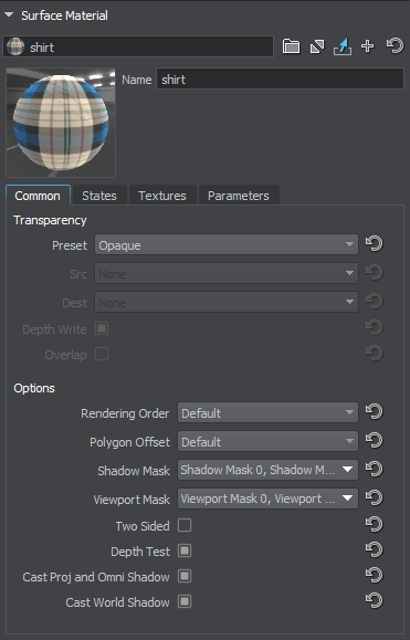

Material Parameters
材质参数#
Material Settings材质设置
In this section, a material can be assigned to the surface and then material's parameters can be tweaked (if the material is editable). Here you can also inherit a new material from the material assigned to the surface: it will be assigned automatically. To inherit the material, click right to the field with the material name. To set the default material, click right to the field with the material name.在本节中,可以将材质分配给曲面,然后可以调整材质的参数(如果该材质可可编辑)。在这里,您还可以从分配给曲面的材质继承新材质:它将自动分配。要继承材质,请在带有材质名称的字段右侧单击。 要设置默认材质,请在具有材质名称的字段上单击
The material parameters can also be changed on the Material tab of the Parameters window: it becomes available when the target material is selected in the Material Hierarchy window.也可以在Parameters窗口的Material选项卡上更改材质参数:在Material Hierarchy窗口中选择目标材质后,该参数将可用。
