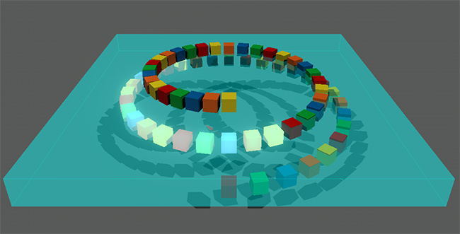

World Trigger is a cuboid shaped node that triggers events when any node (physical or not) gets inside or outside it. World Trigger can detect a node of any type by its bound and can be used to access node's components and parameters.World Trigger是一个立方体形状的节点,当任何节点(无论是否具有物理属性)进入或离开其范围时,会触发事件。World Trigger 可以通过节点的边界检测任何类型的节点,并可用于访问节点的组件和参数。
The following "abstract" nodes do not have bounds; therefore, they do not interact with World Trigger (regardless of the Triggers Interaction option state):以下“抽象”对象没有边界。因此,它们不会与World Trigger交互(无论 Triggers Interaction选项状态如何):
World Trigger affecting meshesWorld Trigger影响网格

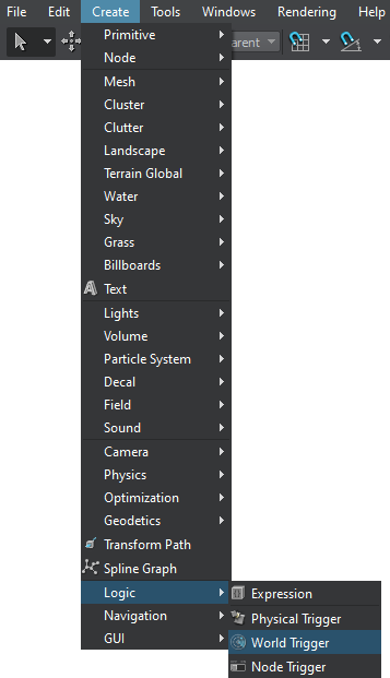

To create World Trigger via UnigineEditor:要通过UnigineEditor创建World Trigger,请执行以下操作:
  1. On the Menu bar, choose Create -> Logic -> World Trigger.在菜单栏上,选择Create -> Logic -> World Trigger
  2. Place the node in the scene.将节点放置在场景中。

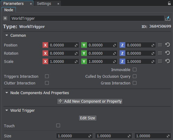

In the Node tab of the Parameters window, you can adjust the following parameters of World Trigger:Parameters窗口的Node选项卡中,可以调整World Trigger的以下参数:
Node tab of the World Trigger nodeWorld Trigger节点的Node选项卡
Bounding Box Parameters
边界框参数#
A set of bounding box parameters:一组边界框参数:

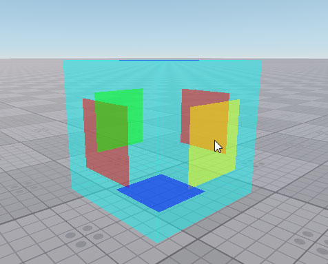

Edit Size
Toggles the editing mode for the World Trigger node on and off. When enabled, the bounding box sides that can be resized are highlighted with the colored rectangles. To change the size of a side, drag the corresponding rectangle.开启和关闭World Trigger节点的编辑模式。启用后,可以调整大小的边界框边将用彩色矩形突出显示。要更改边的大小,请拖动相应的矩形。
Touch Toggles the touch mode for World Trigger on and off. With this mode on, World Trigger reacts to the node at a partial contact. Otherwise, World Trigger reacts only if the whole bounding box gets inside it.开启和关闭World Trigger的触摸模式。启用此模式后,World Trigger在部分接触时对节点做出反应。否则,仅当整个边界框进入内部时,World Trigger才会做出反应。
Size The size of the World Trigger bounding box along the X, Y, and Z axes, in units.沿X, YZ轴的World Trigger边界框的大小,以单位为单位。
