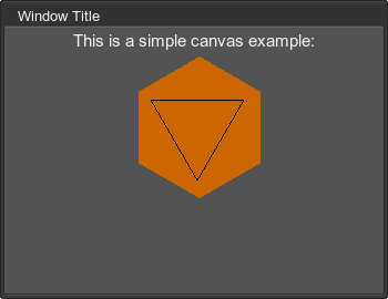

canvas#
Corresponds to an object of the WidgetCanvas class.
canvas widget with polygons
After a canvas widget was created, it can be used to draw polygons (either textured or not), lines and text via UnigineScript. The canvas can be used to create different trackers, charts, tables, etc.
Attributes:
  • texture
    Background texture to be drawn across the canvas
Source code (XML)
<canvas name="Test::canvas" export="1" texture="canvas/canvas.png"/>
To create a simple canvas, define the canvas tag in your UI file as follows:
Source code (XML)
<window name="Test::window" export="1" width="350" height="270" sizeable="1" enabled="1">
	<text>Window Title</text>
	<label><text size="15">This is a simple canvas example:</text></label>
	<canvas name="Test::canvas" export="1" align="center" width="250" height="180"/>
</window>
Then create the corresponding objects for each widget and describe the required geometry in the script:
Source code (UnigineScript)
class Test {
	WidgetWindow window;
	WidgetCanvas canvas;
	Test() {
		ui = new UserInterface(engine.getGui(),"canvas.ui");
	int show(int x,int y)() {
		Gui gui = engine.getGui();
		// add the window widget and its children to the GUI
		gui.addChild(window,GUI_ALIGN_CENTER);
		window.setPosition(x,y);
		// draw polygons
		int id = canvas.addPolygon();
		canvas.setPolygonColor(id,vec4(0.8f,0.4f,0.0f,1.0f));
		canvas.setPolygonTransform(id,translate(130.0f,64.0f,0.0f));
		forloop(int i = 0; 7) {
			float angle = PI2 * i / 6;
			canvas.addPolygonPoint(id,vec3(sin(angle),cos(angle),0.0f) * 64.0f);
		// draw lines
		id = canvas.addLine();
		canvas.setLineColor(id,vec4(0.0f,0.0f,0.0f,1.0f));
		canvas.setLineTransform(id,translate(128.0f,64.0f,0.0f));
		forloop(int i = 0; 6) {
			float angle = PI2 * i * 1 / 3;
			canvas.addLinePoint(id,vec3(sin(angle),cos(angle),0.0f) * 48.0f);
int init(){
	Window window_0 = new Window();
	window_0.show(150,150);
The described canvas is shown as follows:

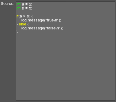

The edittext widget can be used, for example, to input some source code:
Source code (XML)
<hbox align="expand">
	<label align="left,top">Source:</label>
	<edittext name="Test::edittext" export="1" align="expand"/>
</hbox>
The result is the following:

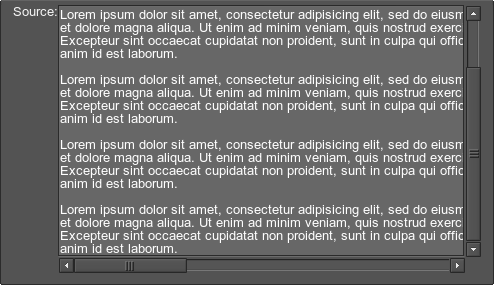

If the text scrolling is required, define the edittext widget inside the scrollbox container:
Source code (XML)
<scrollbox name="Test::scrollbox" align="expand">
</scrollbox>
If you type the long text, the following result is shown:
