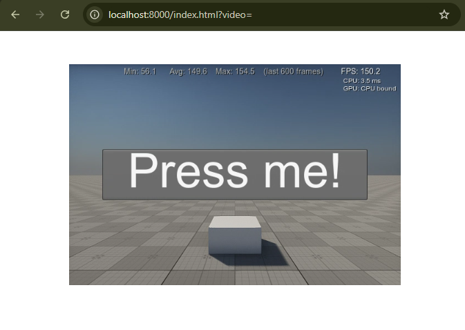

If the player name is not set in the address at all, i.e. the link looks like:如果地址中未设置Player名称(即链接如下所示):
  • localhost:8000/index.html?video=
    or或者
  • localhost:8000
the image is streamed as rendered by Main Player.则图像将以 Main Player 的渲染方式进行流式传输。
Engine image:引擎图像: Streamed image:流式图像:

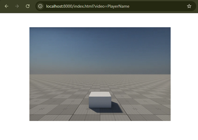

To render from the specific camera, add /index.html?video=PlayerName to the address:要从特定摄像机渲染,请在地址中添加它的名称(/index.html?video=Player名称):
  • localhost:8000/index.html?video=Player名称
    or或者
  • [设备IP地址]:8000/index.html?video=Player名称
警告
If the player with the specified name does not exist in the current world on the streaming server computer, you'll see a fallback view from the current camera on the streaming server, but without any post-effects and GUI.如果在流式传输服务器计算机的当前场景中不存在指定名称的Player,则会看到来自流式传输服务器当前摄像机的备用视图,但没有任何后期特效和GUI。
Image streamed without GUI because the specified player has not been found未找到指定Player时的无GUI流式图像
