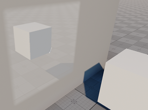

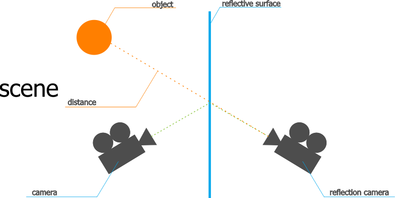

Planar Reflection Probe represents a planar surface that captures and projects a reflection relative to the camera onto a surface just like a mirror. For each visible Planar Reflection Probe on the scene a new temporary texture is created every frame.Planar Reflection Probe表示一个平面,该平面捕获和反射相对于相机的反射并将其投射到一个表面上,就像镜子一样。对于场景中每个可见的Planar Reflection Probe,每帧都会创建一个新的临时纹理。
The texture is projected on a surface placed behind the Planar Reflection Probe. With Planar Reflection Probe you can create flat mirrors and flat dynamic reflective surfaces: parquet, flat varnished surfaces, etc.纹理投影在Planar Reflection Probe后面的表面上。使用Planar Reflection Probe,您可以创建平面镜和平面动态反射表面:镶木地板,平面清漆表面等。
The reflections of one Planar Reflection Probe will not be rendered in the reflections of another Planar Reflection Probe (there are no "reflections in reflections").一个Planar Reflection Probe的反射不会在另一个Planar Reflection Probe的反射中呈现(不存在“反射中的反射”)。

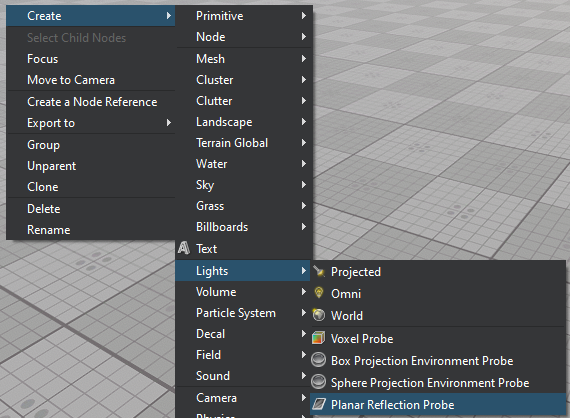

To add a Planar Reflection Probe node to the scene via UnigineEditor, do the following:要通过UnigineEditor将Planar Reflection Probe节点添加到场景中,请执行以下操作:
  1. On the Menu bar, click Create -> Lights -> Planar Reflection Probe.在菜单栏上,单击Create -> Lights -> Planar Reflection Probe

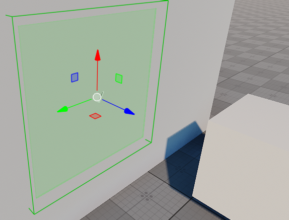

  2. Place Planar Reflection Probe onto the surface that you want to make reflective so that it would intersect the surface.Planar Reflection Probe放置在要使其反射的表面上,以使其与该表面相交。

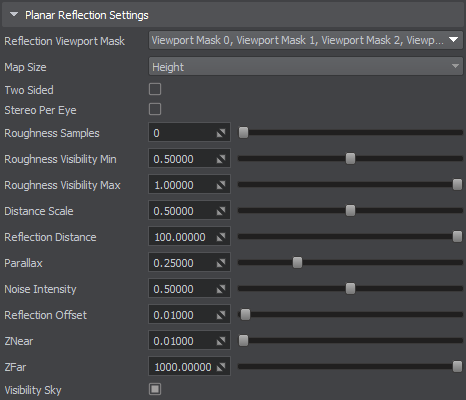

Planar Reflection Parameters
平面反射参数#
Reflection Viewport Mask The Reflection Viewport mask that controls rendering of Planar Reflection Probe reflections into the reflection camera viewport. Objects with matching viewport masks will be rendered.Reflection Viewport遮罩,用于控制将Planar Reflection Probe反射渲染到反射摄影机视口中。具有匹配视口蒙版的对象将被渲染。
Map Size
Specifies the reflection’s texture resolution in pixels. The texture is squared (height and width are equal).指定反射的纹理分辨率(以像素为单位)。纹理是平方的(高度和宽度相等)。
Using high-resolution maps for reflections may significantly affect performance, as dynamic reflections are rendered each frame.使用高分辨率贴图进行反射可能会显着影响性能,因为每帧都会渲染动态反射。
Two Sided Enables projection for both sides. If this parameter is on, the reflection is projected on both sides of Planar Reflection Probe in opposite directions.启用两侧投影。如果启用此参数,则反射将以相反的方向投影在Planar Reflection Probe的两侧。
Stereo per Eye
Enables rendering of the reflection for each eye separately.使每只眼睛的反射分别渲染。
This option is very performance-consuming.这个选项非常消耗性能。
Roughness Samples
Sets the number of samples used to adjust quality of the blurring effect for the reflection on rough surfaces.设置用于调整粗糙表面上反射的模糊效果质量的样本数。
  • The lowest value of 0 means that the blurring of projection is made using only mipmaps.最小值0表示仅使用mipmap进行投影模糊。
  • Higher values result in better blurring quality, as more more randomized samples are used.较高的值会导致更好的模糊质量,因为使用了更多的随机样本。
Rougher materials require more samples for smoother blurring reflection, but setting too high number of samples may cause a performance drop.较粗糙的材质需要更多的样本才能使模糊的反射更平滑,但是设置的样本数过多可能会导致性能下降。
Roughness Visibility Min Lower surface roughness limit, starting from which the reflection starts to fade out gradually.下表面粗糙度极限,从此开始反射逐渐消失。
Roughness Visibility Max Upper surface roughness limit, starting from which the reflection completely disappears.表面粗糙度的上限,从该上限开始,反射会完全消失。
Distance Scale
Global distance multiplier within the range of [0.0f;1.0f] for the reflection LODs visibility distance. Distance Scale is applied to the distance measured from the reflection camera to the node (surface) bound.反射的全局距离乘数在[0.0f;1.0f]范围内检出限可见距离。距离比例适用于从反射摄影机到结点(曲面)的距离。
This option enables rendering of less detailed LODs for reflections to increase performance.使用此选项可以渲染不太详细的LOD,以进行反射以提高性能。
Reflection Distance The render distance for the reflection that specifies how far from the camera the reflection will be rendered.反射的渲染距离,用于指定反射距离相机的距离。
Parallax
Degree of reflection distortion within the range of [0;1]. Distortion depends on an angle between the probe plane and the surface onto which the probe projects reflection. Increasing the value amplifies visual distortion as a result of increasing this angle.反射失真度在[0;1]的范围内。失真取决于探针平面与探针在其上反射反射的表面之间的角度。增加该值会放大由于增加此角度而导致的视觉失真。
Noise Intensity Additional jitter for roughness samples that creates a noise effect on the reflection. Higher values make the noise effect more noticeable.粗糙度样本的附加抖动会对反射产生噪声影响。较高的值会使噪声效果更明显。
Reflection Offset Z axis offset (relative to the probe local coordinate system) for the reflection. Can be used to change the viewpoint of the reflection camera moving it forward or backwards relative to the probe.反射的Z轴偏移(相对于探针局部坐标系)。可用于改变反射式摄像机相对于探头向前或向后移动的视点。
ZNear Distance to the near clipping plane defining a frustum to be used for grabbing reflections.到近裁切平面的距离,该距离定义了一个用于截取反射的视锥。
ZFar
Distance to the far clipping plane defining a frustum to be used for grabbing reflections.到远剪切平面的距离,该距离定义了用于捕获反射的视锥。
The higher the value, the more distant objects will be rendered; therefore, high values are not recommended due to possible performance hit.值越高,将渲染的对象越远。因此,由于可能会降低性能,因此不建议使用高值。
Visibility Sky Renders sky in the reflection. Can be used, when the reflection is supposed to reflect closeby objects only.在反射中渲染天空。当反射仅应反射附近的对象时可以使用。
