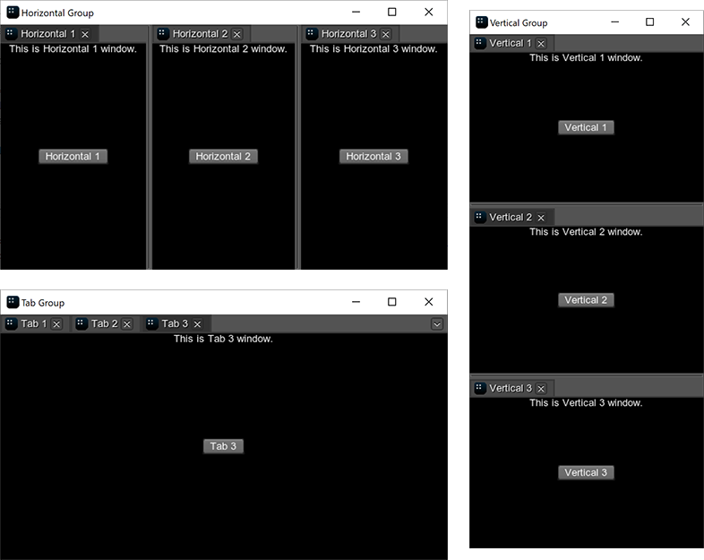

When the engine windows are grouped, a new window containing these windows is created. This new window is called a group, and the windows in the group - nested. The number of windows in the group is unlimited. Moreover, you can group both the separate engine windows and the existing window groups.将引擎窗口分组后,将创建一个包含这些窗口的新窗口。这个新窗口被称为组,而组中的窗口嵌套在中。组中的窗口数量是无限的。此外,您可以对单独的引擎窗口和现有的窗口组进行分组。
There are three types of the window groups:窗口组有三种类型:
- Vertical垂直
- Horizontal水平
- Group of tabs选项卡组
Within the group, all windows are stacked according to one of these types.在组中,所有窗口都根据其中一种类型堆叠。

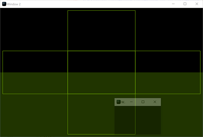

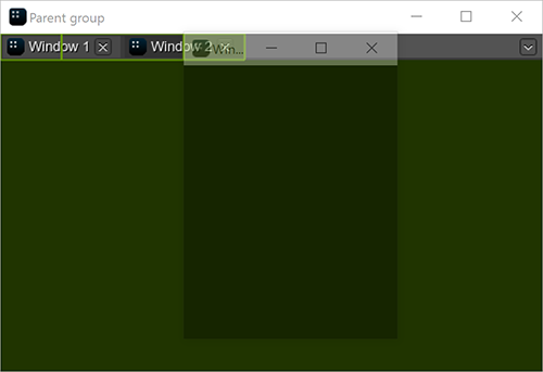

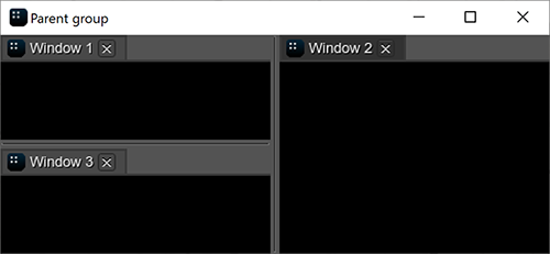

Grouping Using the Mouse鼠标分组#
While the application is running, you can group and ungroup the existing windows by using the mouse.当应用程序运行时,您可以使用鼠标对现有窗口进行分组和取消分组。

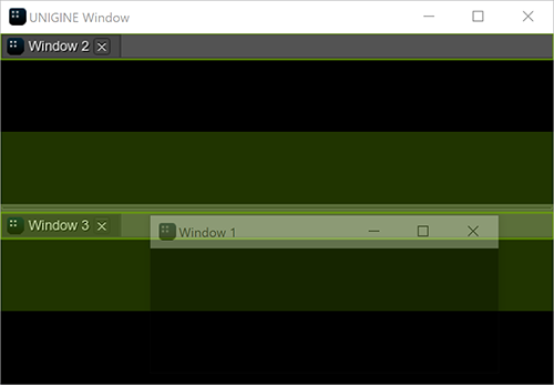

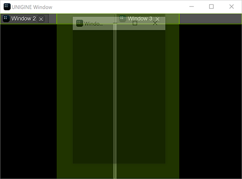

To group two separate windows, do the following:要将两个单独的窗口分组,请执行以下操作:
- Hold the mouse button while moving the window to the destination one. The destination window will be divided into 9 sectors.在移动窗口到目标窗口时按住鼠标按钮。目的地窗口将分为9个扇区。
- Choose the required sector and release the mouse button — the windows will be grouped.选择所需的扇区并释放鼠标按钮:窗口将被分组。
To add the window to the existing group, you should hold the mouse button while moving the window and release it in one of the following areas:要将窗口添加到现有组,您应该在移动窗口时按住鼠标按钮,然后在以下区域之一释放它:
For the horizontal group:水平组:
For the vertical group:垂直组:
For the group of tabs:对于标签组:

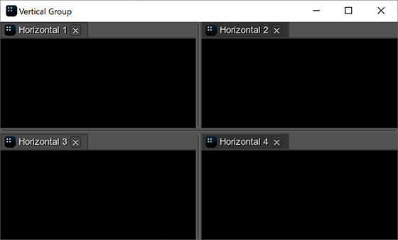

// create separate windows
EngineWindowViewportPtr horizontal_1 = EngineWindowViewport::create("Horizontal 1", 512, 256);
EngineWindowViewportPtr horizontal_2 = EngineWindowViewport::create("Horizontal 2", 512, 256);
EngineWindowViewportPtr horizontal_3 = EngineWindowViewport::create("Horizontal 3", 512, 256);
EngineWindowViewportPtr horizontal_4 = EngineWindowViewport::create("Horizontal 4", 512, 256);
// create 2 horizontal window groups
EngineWindowGroupPtr horizontal_group_1 = WindowManager::stack(horizontal_1, horizontal_2, EngineWindowGroup::GROUP_TYPE_HORIZONTAL);
EngineWindowGroupPtr horizontal_group_2 = WindowManager::stack(horizontal_3, horizontal_4, EngineWindowGroup::GROUP_TYPE_HORIZONTAL);
// create a vertical group of 2 horizontal groups
EngineWindowGroupPtr vertical_group = WindowManager::stackGroups(horizontal_group_1, horizontal_group_2, EngineWindowGroup::GROUP_TYPE_VERTICAL);
// specify position, size, title of the verical window group
vertical_group->setPosition(Math::ivec2(50, 60));
vertical_group->setSize(Math::ivec2(565, 310));
vertical_group->setTitle("Vertical Group");
// render the window group
vertical_group->show();

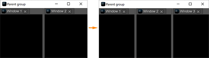

WindowManager::stackToParentGroup() stacks the second window to the parent group of the first window. In the result, both windows passed as arguments will be on the same level in the group hierarchy.WindowManager::stackToParentGroup()将第二个窗口堆栈到第一个窗口的父组。结果,作为参数传递的两个窗口将在组层次结构中处于同一级别。
源代码 (C++)// create separate windows EngineWindowViewportPtr window_1 = EngineWindowViewport::create("Window 1", 512, 256); EngineWindowViewportPtr window_2 = EngineWindowViewport::create("Window 2", 512, 256); EngineWindowViewportPtr window_3 = EngineWindowViewport::create("Window 3", 512, 256); // stack 2 separate windows EngineWindowGroupPtr group_0 = WindowManager::stackWindows(window_1, window_2, EngineWindowGroup::GROUP_TYPE_HORIZONTAL); // stack a separate window to the parent group of "window_1" WindowManager::stackToParentGroup(window_1, window_3);

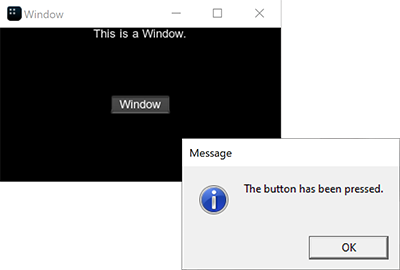

To create a dialog window, use the corresponding functions of the class. For example:要创建对话框窗口,请使用类的相应函数。例如:
// event handler function
int AppSystemLogic::onButtonClicked(const WidgetPtr &sender_widget, int buttons)
// show the message dialog
WindowManager::dialogMessage("Message", "The button has been pressed.");
int AppSystemLogic::init()
// create a window with widgets in the client area
auto create_window = [](const char *name)
EngineWindowViewportPtr window = EngineWindowViewport::create(name, 512, 256);
window->addChild(WidgetLabel::create(window->getSelfGui(), String::format("This is a %s.", name)), Gui::ALIGN_TOP);
window->addChild(WidgetButton::create(window->getSelfGui(), name), Gui::ALIGN_CENTER);
return window;
// create a window
EngineWindowViewportPtr window = create_window("Window");
// get the child widget of the window
WidgetPtr button = window->getChild(1);
// subscribe to the Clicked event
button->getEventClicked().connect(this, &AppSystemLogic::onButtonClicked);
// show the window
window->setPosition(Math::ivec2(50, 60));
window->show();
If you press the button in the client area of the created window, the following dialog will be shown:如果在创建的窗口的客户端区域按下按钮,将显示如下对话框:
