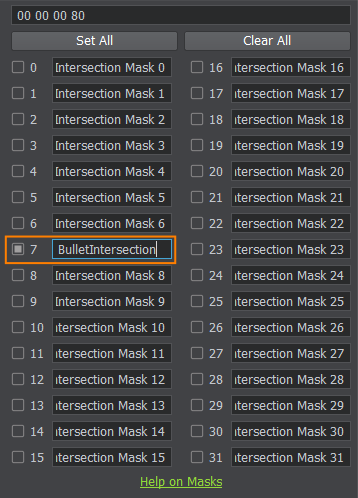

  1. For every wall's box surface enable the 7th bit of the Intersection Mask, and call it BulletIntersection.对于每一个墙的box曲面启用Intersection位掩码的第七位,并称之为BulletIntersection

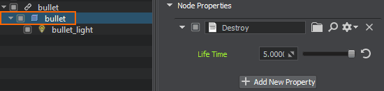

  3. As the Life Time of the bullet runs out we should delete it by simply calling the deleteLater() method. Create a new C++ component and call it Destroy. Copy the code below and paste it to the corresponding files in your project and save them in your IDE.随着子弹的生命周期用完,我们应该通过调用 deleteLater() 方法来删除它。 创建一个新的 C++ 组件 并将其命名为 Destroy。 复制下面的代码并将其粘贴到项目中的相应文件中,并保存在 IDE 中。
    Destroy.h (C++)
    #pragma once
    #include <UnigineGame.h>
    class Destroy : public Unigine::ComponentBase
    	COMPONENT_DEFINE(Destroy, ComponentBase)
    	COMPONENT_INIT(init);
    	COMPONENT_UPDATE(update);
    	// object's lifetime
    	PROP_PARAM(Float, lifeTime);
    protected:
    	void init();
    	void update();
    	float startTime;
    Destroy.cpp (C++)
    #include "Destroy.h"
    REGISTER_COMPONENT(Destroy);
    void Destroy::init()
    	// remember initialization time of an object
    	startTime = Game::getTime();
    void Destroy::update()
    	// wait until the life time ends and delete the object
    	if (Game::getTime() - startTime > lifeTime)
    		node.deleteLater();

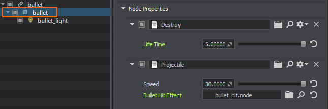

  8. Add a Projectile property to the child ObjectMeshStatic bullet of the bullet Node Reference. Drag the bullet_hit.node node from the Asset Browser window to the Bullet Hit Effect field.Projectile属性添加到bullet Node ReferenceObjectMeshStatic bullet 子节点。将bullet_hit.node节点从Asset Browser窗口拖到Bullet Hit Effect字段。
    There is also the Speed field that allows specifying a spawn speed for the bullet.还有Speed字段允许指定一个产卵子弹的速度。

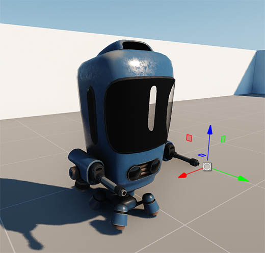

Let's create special spawn nodes using Dummy Nodes with no visual representation. Their positions will be used as initial bullet positions.让我们使用 Dummy Node创建特殊刷出节点,但不使用视觉表示。它们的位置将被用作初始子弹的位置。
  1. Select the robot Node Reference in the World Nodes window and click Edit in the Reference section of the Parameters window.World Nodes 窗口中选择 robot Node Reference,然后在 Parameters 窗口的 Reference 部分中单击 Edit
  2. Right-click on the child robot ObjectMeshSkinned in the World Nodes window to add a child node. Choose Create->Node->Dummy and position it in the Viewport near the end of the left gun. The Y axis (green arrow) must point in the fire direction, since Unigine uses the right-handed Cartesian coordinate system.World Nodes 窗口中右键单击子 robot ObjectMeshSkinned 以添加子节点。 选择 Create->Node->Dummy 并将其放置在 Viewport 靠近左枪末端的位置。 Y 轴(绿色箭头)必须指向射击方向,因为 UNIGINE 使用 右手 笛卡尔坐标系。
  3. Rename the Dummy Node as "left_bullet_spawn". Dummy Node 重命名为 "left_bullet_spawn"
  4. Create a spawn point for the right gun the same way and call it "right_bullet_spawn".以同样的方式为右枪创建一个刷出点,并将其命名为 "right_bullet_spawn"

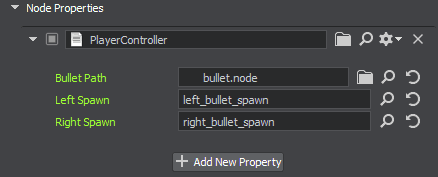

  7. Drag left_bullet_spawn, and right_bullet_spawn to the corresponding fields of the PlayerController property of the robot node (ObjectMeshSkinned). And assign the bullet.node to the Bullet Path field.left_bullet_spawnright_bullet_spawn 拖到 robot节点的 PlayerController 属性的对应字段中 (ObjectMeshSkinned)。 并将 bullet.node 分配给 Bullet Path 字段。
