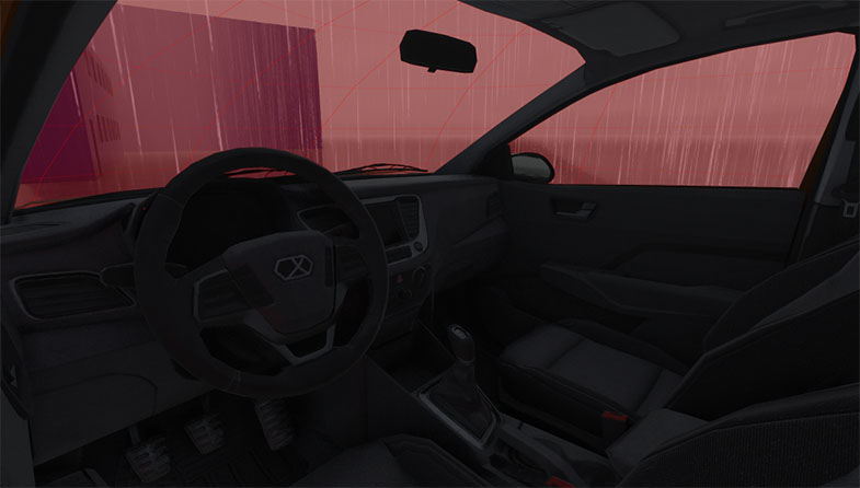

Particles Spacer is a volumetric field that has no visual representation, but physically interacts with Particle Systems (other objects are not affected). The Particles Spacer is used to cut out particles generated by a Particle System from a certain volume, for example, to avoid rendering of rain or snow inside a car or under a bridge. It can have a box, cylinder, capsule, sphere, or ellipse shape and can be arbitrarily positioned or rotated to cover the necessary area.Particles Spacer 是一个没有视觉表示的体积场,但物理上与 Particle System交互(其他对象不受影响)。Particles Spacer用于从一定体积中挡断由粒子系统产生的粒子,例如,避免渲染汽车内或桥下的雨或雪。它可以是盒子、圆柱体、胶囊、球体或椭圆形状,并且可以任意定位或旋转以覆盖必要的区域。

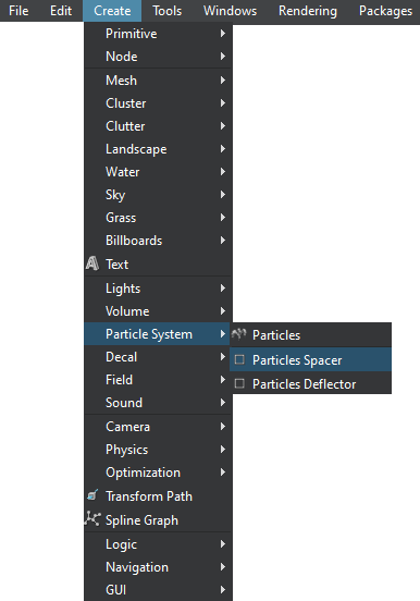

To add a Particles Spacer to the world via UnigineEditor, do the following:要通过UnigineEditor添加一个Particles Spacer到世界,请执行以下操作:
  1. In the Main Menu, choose Create -> Particle System -> Particles Spacer.在主菜单中选择Create -> Particle System -> Particles Spacer
  2. Place the Particles Spacer in the world to cover the area where particles are to be cut out:Particles Spacer在世界上覆盖粒子被挡断的区域。

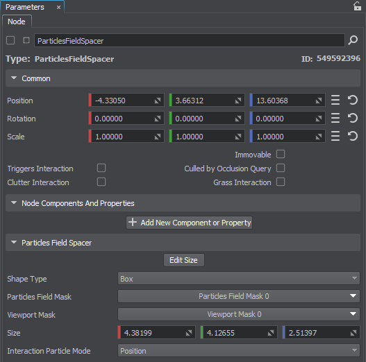

In the Particles Field Spacer section (Parameters window -> Node tab), the following parameters of the Particles Spacer can be adjusted:Particles Field Spacer部分(Parameters窗口→Node选项卡)中,Particles Spacer的以下参数可以调整:
Adjusting Spacer Form
调整垫片形状#
Shape Type Shape of the Particles Field Spacer: box, cylinder, capsule, sphere, or ellipse.Particles Field Spacer的形状: 方块、圆柱体、胶囊、球体椭圆的形状。
Size
Size of the Particles Field Spacer along the X, Y, and Z axes, in units.Particles Field Spacer沿着X, YZ轴的大小,以单位。
In case of an ellipse shape each component of the vector sets a radius along the corresponding axis.如果设置了椭圆形状,则矢量的每个分量沿相应轴设置半径。
Radius
Radius of the Particles Field Spacer, in units (available for capsule, cylinder, and sphere shapes).Particles Field Spacer半径,以单位(可用于胶囊,汽缸,和 球体形状)。
Height
Height of the Particles Field Spacer, in units (available for capsule, and cylinder shapes).Particles Field Spacer的高度,单位(可用于胶囊圆柱体形状)。
Interaction Particle Mode
Interaction mode for the Particles Field Spacer. Interaction can be triggered on a contact of the spacer either with particle's center position or with its bounding box (this can be useful in case of length particles, for example).Particles Field Spacer交互模式。交互可以触发挡断体积的接触与粒子的中心位置或与其边界框(例如,这可能是有用的长度的粒子)。
