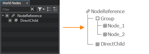

The transformation of a Node Reference is not affected by the transformation of the nodes stored by it. Thus, logic-driven and physics-driven nodes inside a Node Reference will make no influence on its direct children.Node Reference的转换不受其存储的节点的转换的影响。因此,Node Reference中的逻辑驱动和物理驱动节点不会对其直接子节点产生影响。
In the following example, the moving grouped Node_1 and Node_2 nodes (e.g. driven by physics) contained by a Node Reference will not modify the transformation of the Node Reference and, therefore, the DirectChild node will not be affected as well.在下面的例子中,由Node Reference包含的移动分组 Node_1Node_2节点(例如,由物理驱动)将不会修改Node Reference的转换,因此,DirectChild节点也不会受到影响。
Schematic representation of a Node Reference content.Node Reference内容的示意图表示。
So, it is recommended to enclose all interconnected nodes in a single Node Reference to ensure logical and hierarchical integrity.因此,建议将所有相互连接的节点封装在一个Node Reference中,以确保逻辑和层次的完整性。

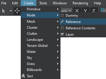

  2. Add the Node Reference to the world by either of the following ways:添加Node Reference世界通过以下方式:
    • On the Menu bar, click Create -> Node -> Reference and select the desired .node asset in the window that opens:在菜单栏上,单击Create -> Node -> Reference,并在打开的窗口中选择所需的.node资源:

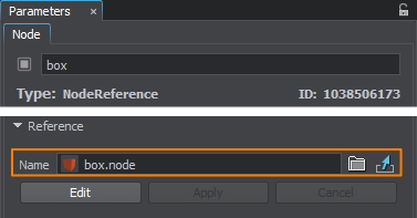

In the Reference section of the Node tab, you can change the asset of the source node or open the ReferenceNode Editor used to edit the source node: Node标签的Reference部分,您可以更改源节点的资源或打开用于编辑源节点的ReferenceNode Editor:

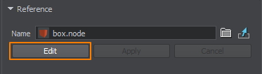

To edit the source node, to which the Node Reference points:编辑的源节点,Node Reference点:
  1. Select the Node Reference in the World Nodes Hierarchy window.World Nodes Hierarchy窗口中选择Node Reference
  2. Click Edit in the Node tab of the Parameters window.单击Parameters窗口的Node选项卡中的Edit
    The source node becomes available in the World Nodes Hierarchy window as a child of the Node Reference and can be edited via the Parameters window.源节点可用在World Nodes Hierarchy窗口作为一个孩子节点的引用,并可以通过编辑Parameters窗口。

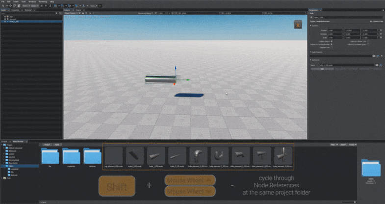

It is also possible to quick-replace the source node with another one stored in the same folder. To do that, select a Node Reference in the World Nodes Hierarchy window or the Viewport, hold Shift and use the mouse wheel or Page Up and Page Down buttons.也可以将源节点快速替换为存储在同一文件夹中的另一个节点。为此,在World Nodes Hierarchy窗口或Viewport中选择一个Node Reference,按住Shift并使用鼠标滚轮或Page UpPage Down按钮。
