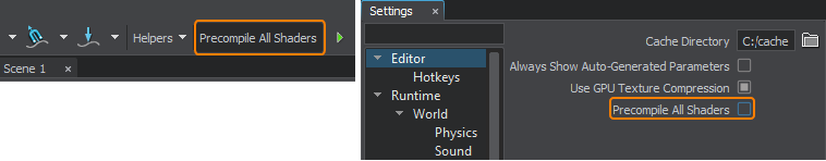

Precompilation of all shaders is an important feature guaranteeing, that at the time your project is completed and final builds are ready to be handed over to customers, you will have a complete shader cache. This significantly reduces the number of freezes in the final release build and smooths your application's framerate. Shaders are precompiled for all materials in the project. 所有着色器的预编译是一项重要的功能,可确保在您的项目完成并且最终版本可以交付给客户时,您将拥有完整的着色器缓存。这显着减少了最终版本构建中的冻结次数,并平滑了应用程序的帧速率。已为项目中的所有材质预先编译了着色器。
This feature is available via the Precompile All Shaders button on the toolbar near the Play button or via the Editor section of the Settings window when a world is loaded.通过加载工具栏上Play按钮附近的工具栏上的Precompile All Shaders按钮或通过加载世界时通过Settings窗口的Editor部分可以使用此功能。
Precompile All Shaders option on the toolbar and in the Editor section of the Settings window工具栏上和Settings窗口的Editor部分中的Precompile All Shaders选项
