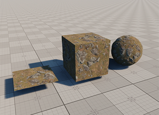

The Result Height is connected to the Tessellation Vertex Offset Tangent Space port of the material via the 0,0,x port adapter (meaning that the value shall control displacement along the Z-axis only, keeping X and Y as they are). The Result Blend Mask is used as a blending coefficient for the Lerp nodes performing linear interpolation between two sets of Albedo and tangent-space Normal textures.Result Height 通过 0,0,x 连接到材质的 Tessellation Vertex Offset Tangent Space 端口端口适配器(意味着该值应仅控制沿 Z 轴的位移,保持 X 和 Y 不变)。 Result Blend Mask 用作在两组 Albedo 和切线空间 Normal 纹理之间执行线性插值的 Lerp 节点的混合系数。
Blend By Height sample按高度混合示例
