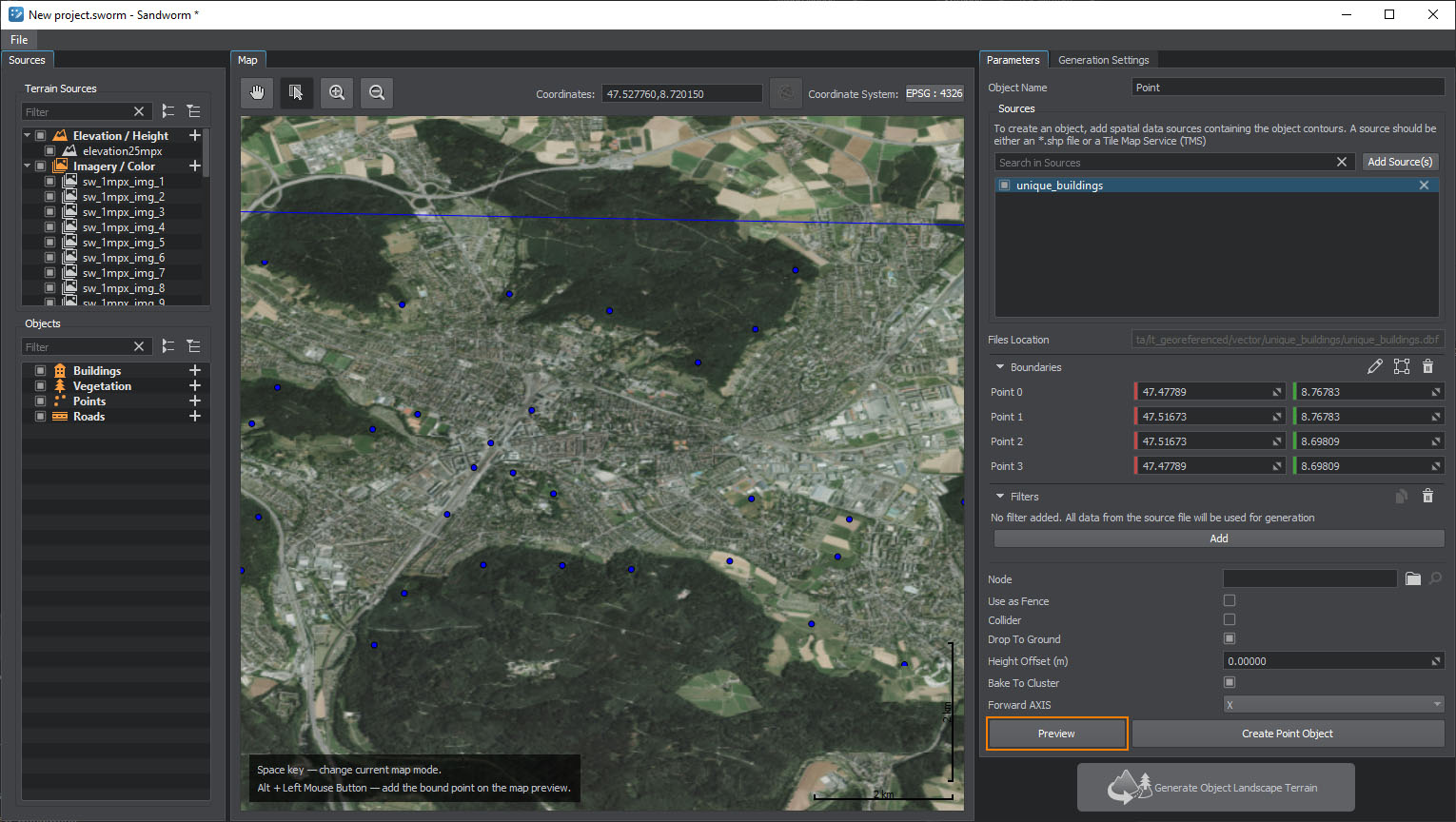

  1. Create the object: in the Objects panel, click + for Points.创建对象:在Objects面板中,单击 Points+
  2. In the Parameters tab, add a source: click the Add Source(s) button, select Assets and set the path to the sw_georeferenced\vector\unique_buildings\unique_buildings.shp file.Parameters 选项卡中,添加源:单击 Add Source(s) 按钮,选择 Assets 并将路径设置为 sw_georeferenced\vector\unique_buildings\unique_buildings.shp 文件。
    As the source is added, we can click the Preview button below to see the point data preview on the map.添加源以后,我们可以单击Preview按钮下面看到地图上的点数据预览。

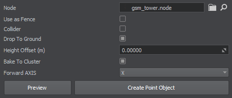

  3. Set the prepared primary object as Node and keep other settings as they are.将准备好的 primary object 选择为 Node 并保持其他设置不变。
  4. Click the Create Point Object button.单击Create Point Object按钮。
